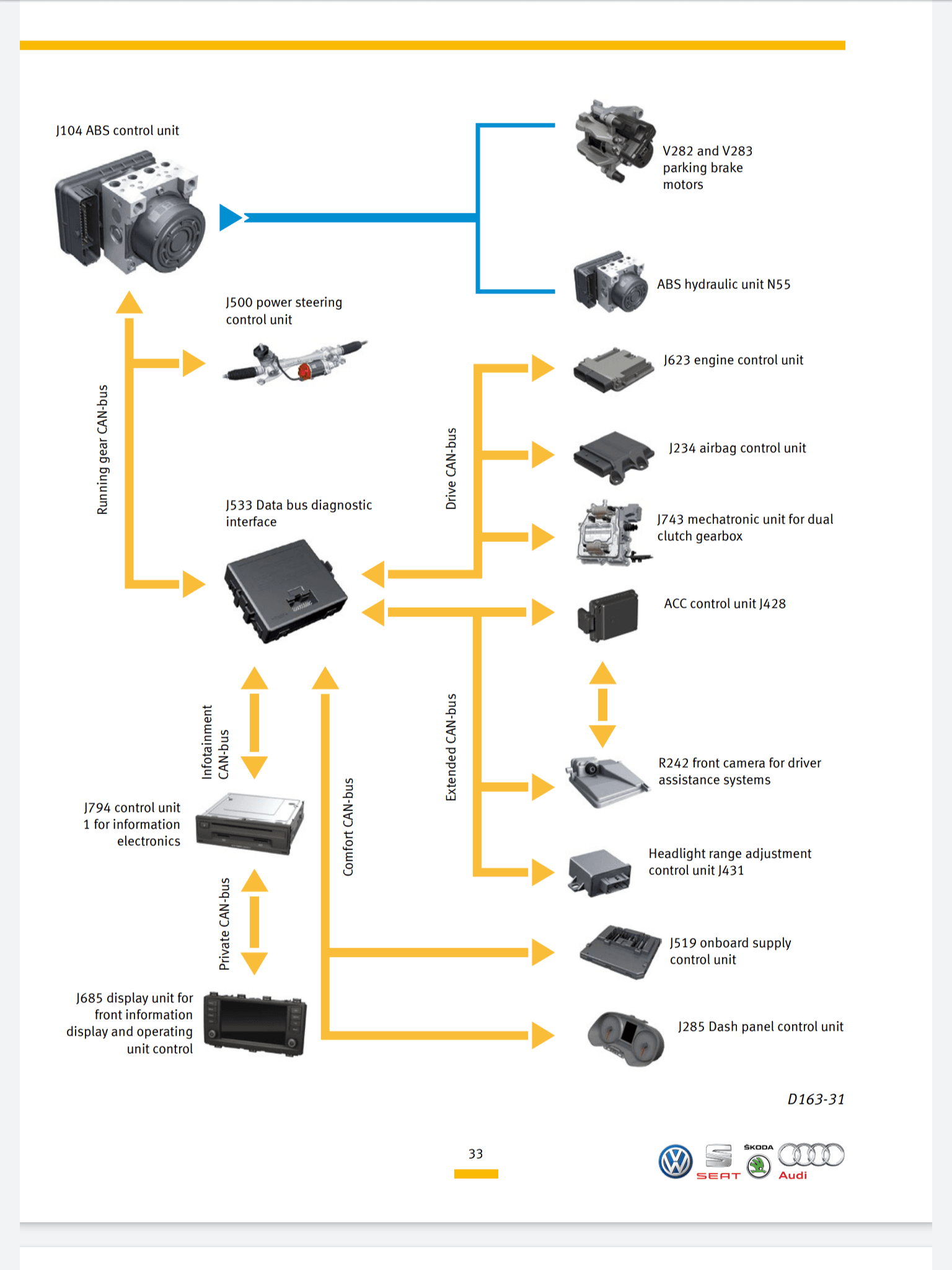

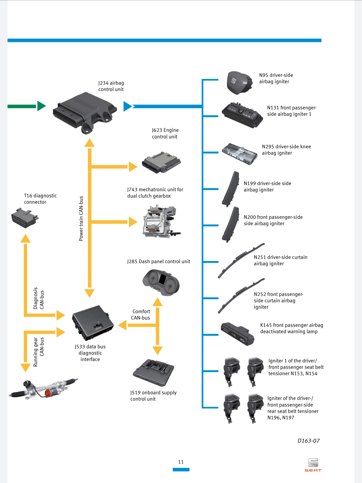

It's your Can bus... every time it says it in the diagrams below. Virtual cockpit is driven from the infotainment unit via one of the buses hence a reboot of the infotainment unit (that long 10 second hold on on/off till the Seat logo reappears) can be helpful so a restart of the communications is triggered going out from the unit.
As said after 20 minutes of the ignition being off in these vehicles the systems power down automatically. Why it's adviced after doing any Obdeleven programming with the engine running to stop and restart after with the dongle out, in case any of the control units is left powered up consuming battery power. That is what it is said on that one atleast.
Putting buses to one side if a known bug is known in the software in one of the control units, it might be a simple case of the dealer updating the firmware in one of the units to get everything up to scratch. A simple bug in the start up of the system may have led to the problem. That's where reading the error codes is handy.
