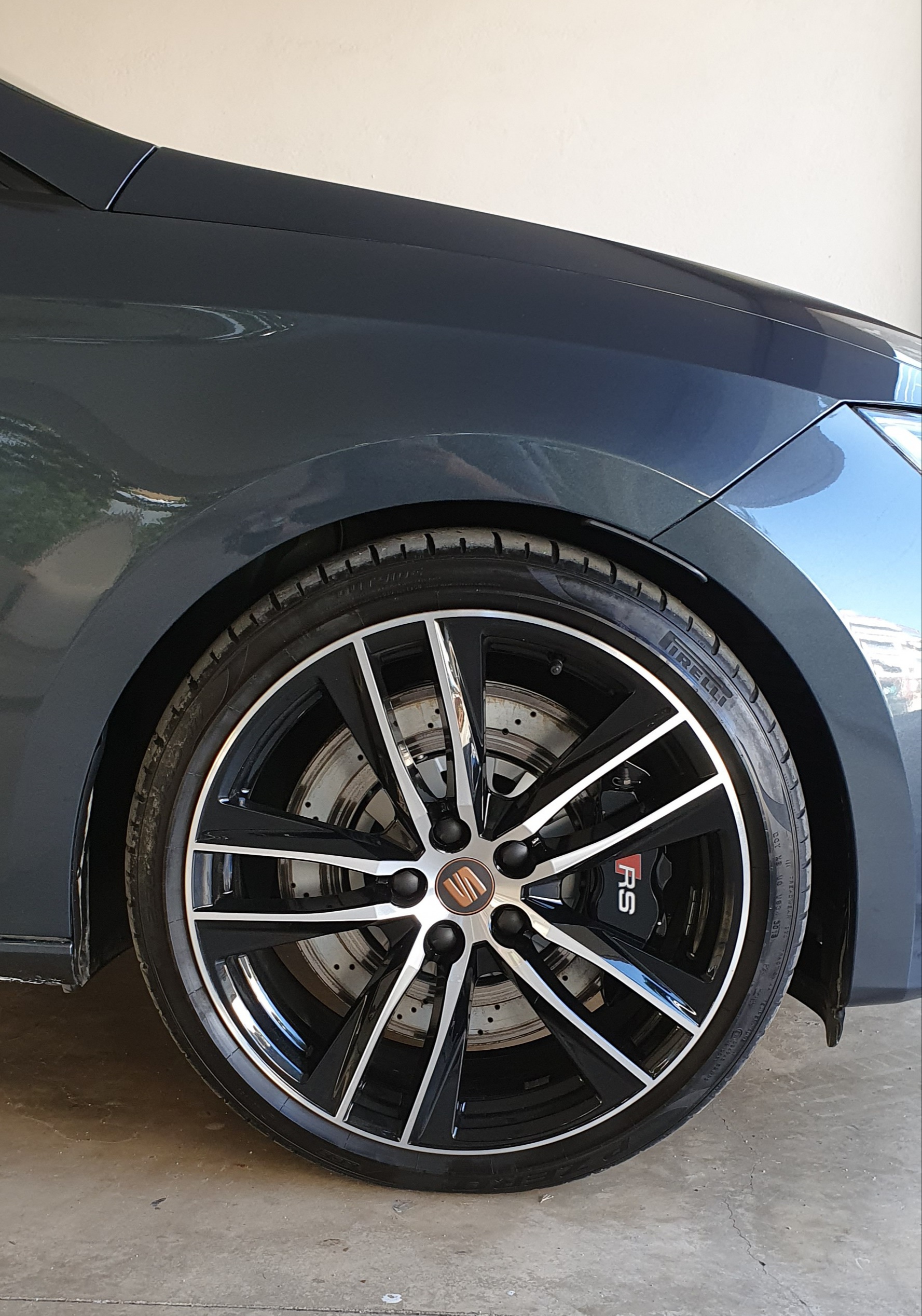

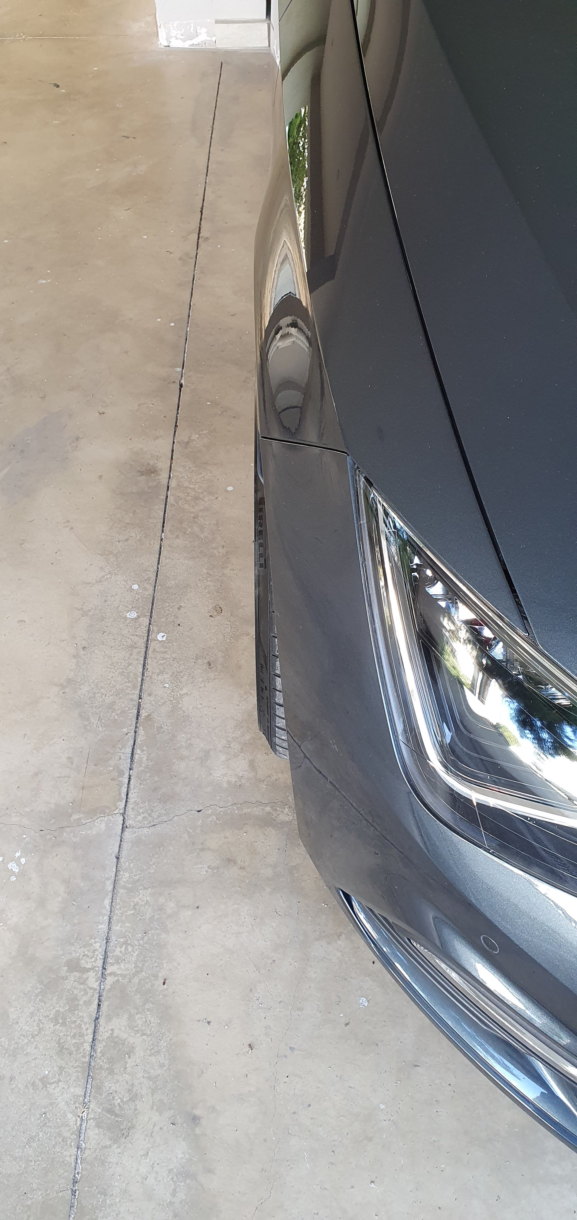

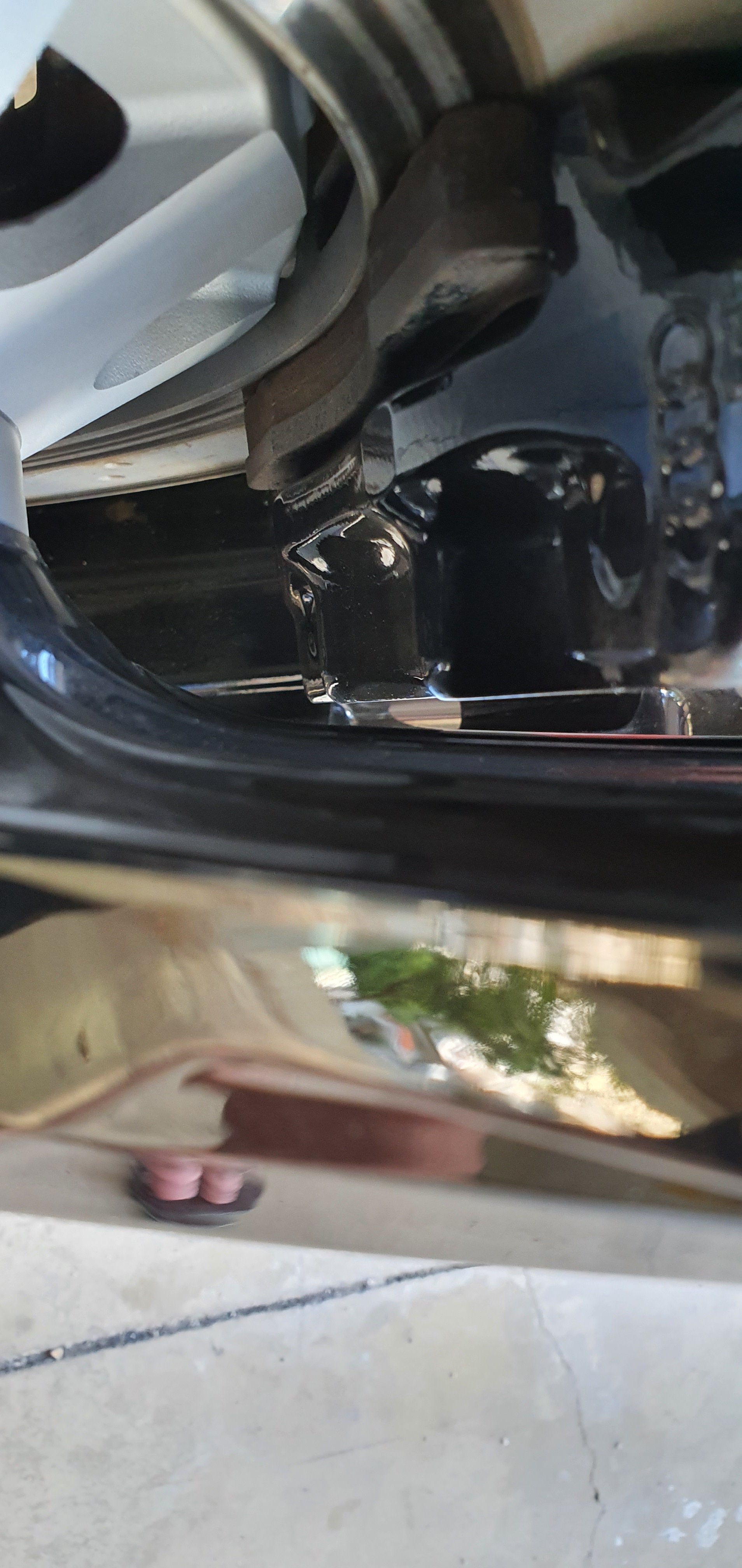

So in case anyone was wondering...here's how the Sub8 brakes fit in to the standard facelift wheels (and suspension). It seems that everything more than 11mm spacers will be enough to clear the calipers safely. I fitted 15mm spacers all around and I am currently checking for rubbing and fortunately there is none yet in everyday driving. If I notice any I will go down to 12mm spacers which should clear and nearly provide the 3mm safety space that Brembo typically requires.
Pls ingore the hideous RS logo. :p They will be painted black or bronze when I have the time. I haven't desided yet...
