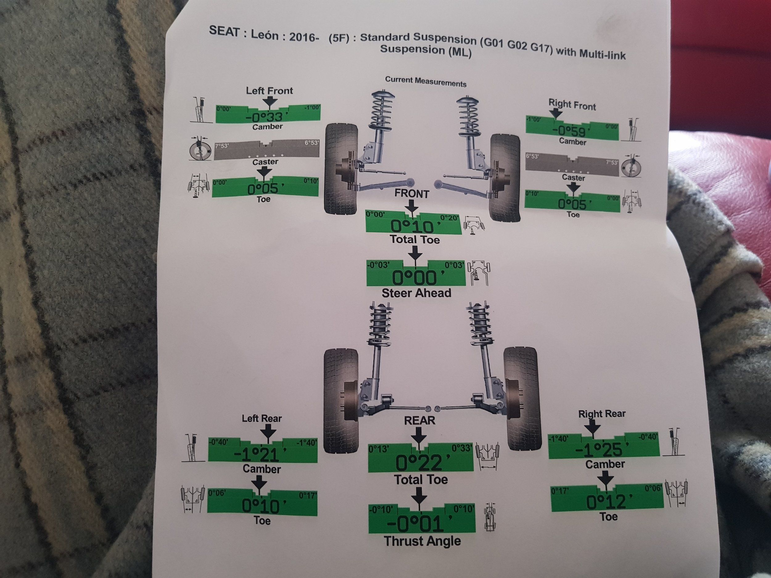

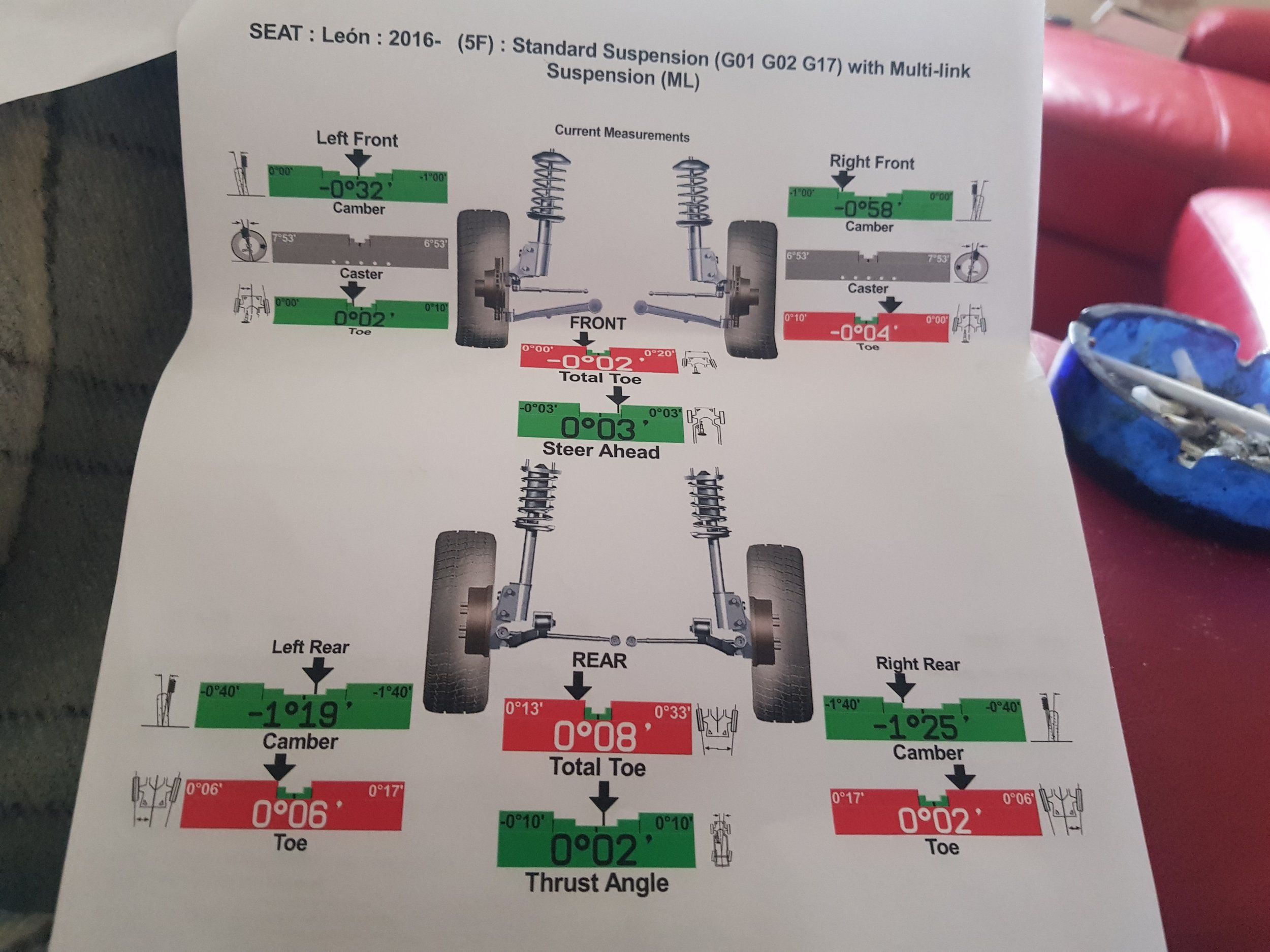

My car felt like **** was very tail happy, had new ps4 fitted to rear and had full alignment car sticks like glue now turn in much better also.
Glad to hear you got it sorted. My cupra suffers a bit with lift off oversteer to be honest. With the diff though you can keep your foot planted and it will pull you round even in the wet with 2mm of tread left ??. Thank you for the printouts but unfortunately I need the settings for a cupra. I believe they will be different. I understand for what I have read that they are different. Also slightly different if the car is fitted with ACC which mine is.

Thank you for the reply’s everyone. I have found the print out to my last wheel alignment. It’s definitely the wrong settings. They have put it down as an estate with no adaptive chassis control and code is G13. Very annoying. I will look at the paperwork properly next time ?.
Could I just confirm with someone who has a cupra and have had the wheel alignment done that it is G12 and not G13.
There is no difference between 5dr and ST geometry settings on the Cupra according to the ‘Running Gear, Axles, Steering’ workshop manual.
(Pre-FL) 2013-2016 Cupra PR No for DCC Multilink Suspension is ‘G05 + 2UG’
(FL 2016+) Cupra PR No for DCC Multilink Suspension is ‘G12’.
The only difference between Pre-FL and FL DCC Cupra geometry is rear axle camber:
Pre-FL: -1 deg 40’ +/- 30’ & max 30’ difference between sides
FL: -1 deg 30’ +/- 30’ & max 30’ difference between sides
The printout for my FL Cupra ST is here:
