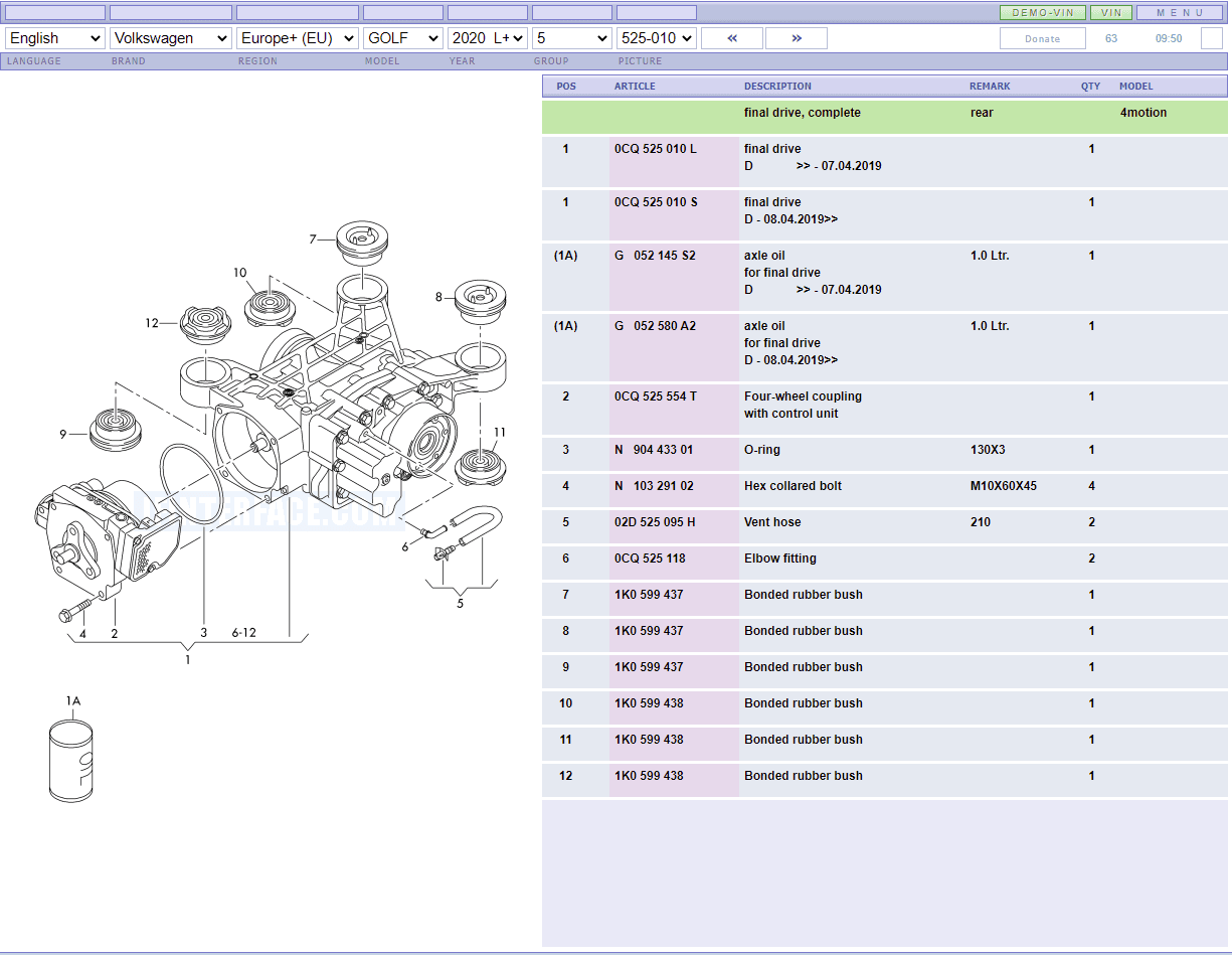

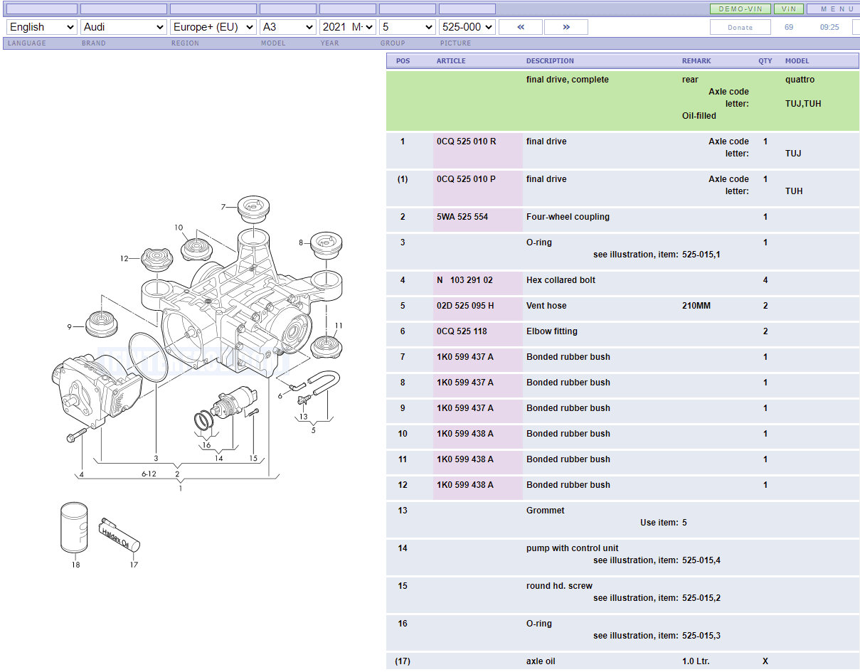

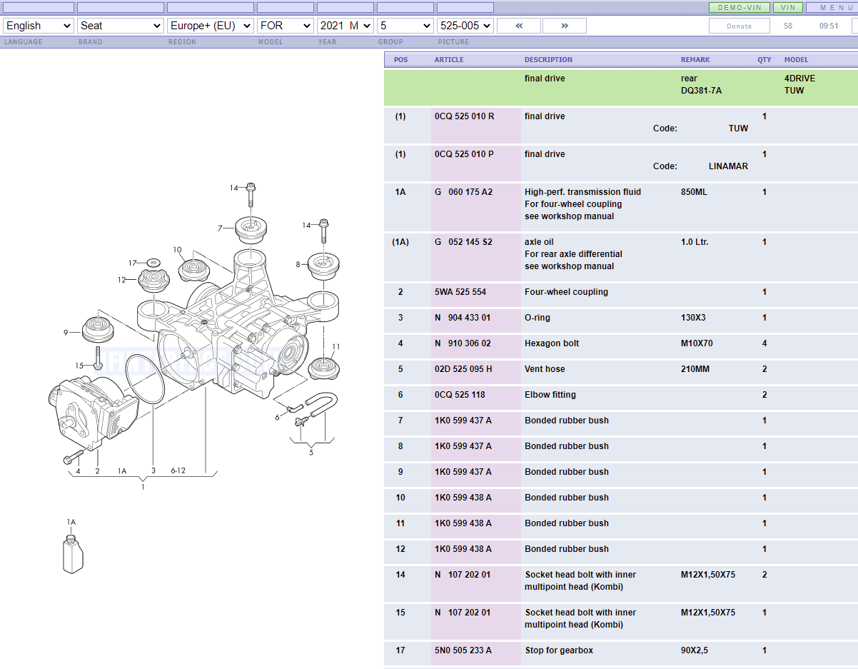

Look:
I enclose here the rear group of the three cars Audi S3, Golf 7.5 and Formentor. Check it out for yourself. Doesn't matter if the car sports a 'Quattro', 4Motion or 4Drive. Is the same system with different name.
Unique 'real' Quattro systems are the ones that sport a Torsen center diff. None of those three has.
