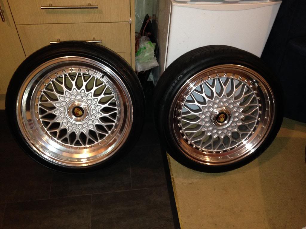

Hi all, bought some wheels being told they were 5x112, turns out they're 5x110 :(
Anyone know if its possible to get 5x100 to 5x110 adaptors?
I've looked through eBay but had no joy, not sure if its a common adaptor or not?
Any help would be great.
Cheers

TBh im quite happy with the wheels:
Picked them up for £250 with good tyres too, and my 5x100 to 5x112 adaptors were only £70.
So with wobble bolts asweel all together it'll cost me £360ish for wheels with tyres.
