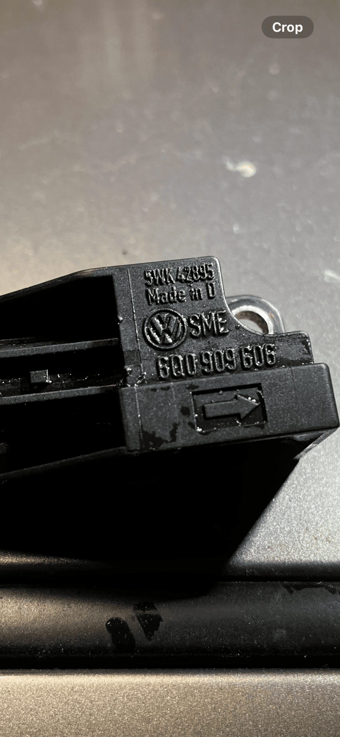

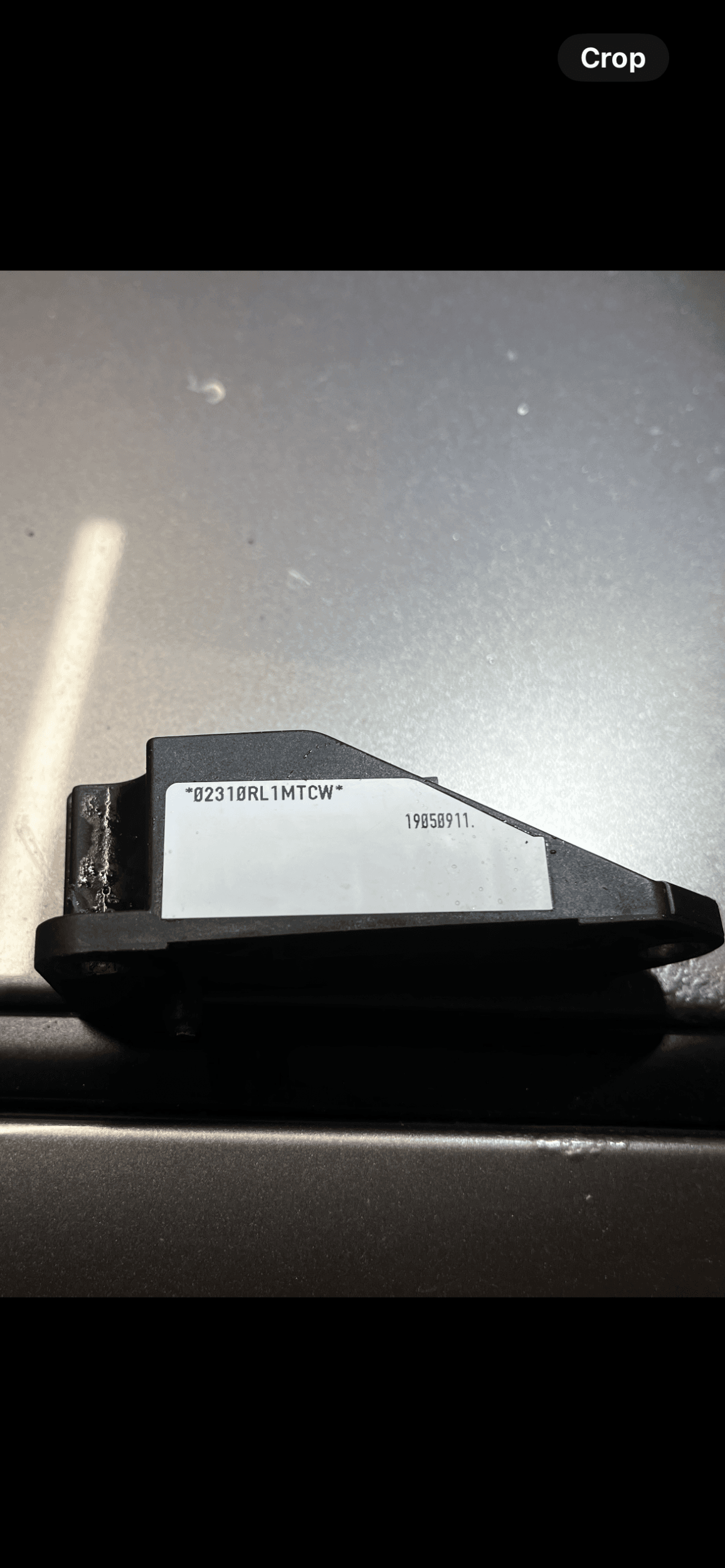

I found another on eBay with the same first digit ’1‘ as I had before, photos attached, but this doesn't work either. This time the fault was 01222 ‘No Adjustment or Incorrect Adjustment‘. I gather that this can sometimes be the loom, so I have swapped it out with the known good drivers side and the fault moves, so it’s definitely the sensor.
