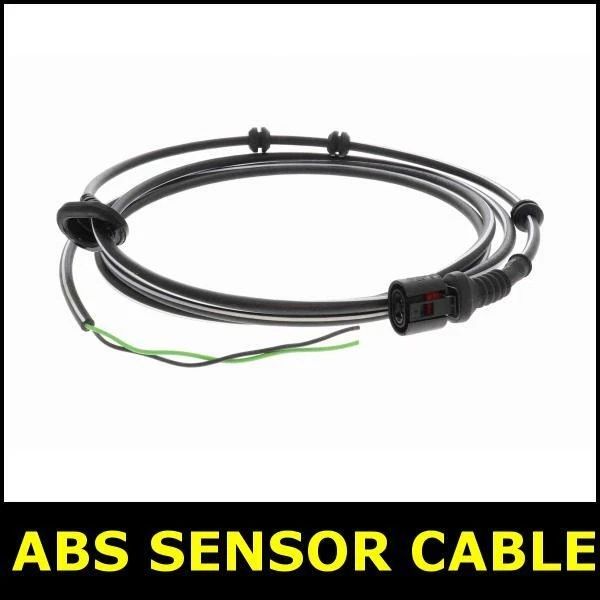

I had the same problem with an audi tt i was sorting for someone, replaced the sensor and no different, same code, ended up being the wiring all the way back to inside the engine bay was black and green corroded copper, had to cut and splice in a full new wire for it and the code and light went away.

i had to get a new wire from the scappers, i cut it right off 4 inches from the big plug thats on the back of the abs unit facing the strut tower (in the engine bay), heres a picture of the actual wire you can buy, its fairly cheap but i needed it quickly, if this is your problem then youd need to either cut and splice the wire like i did or de-pin the wire from the big plug on the abs unit.
