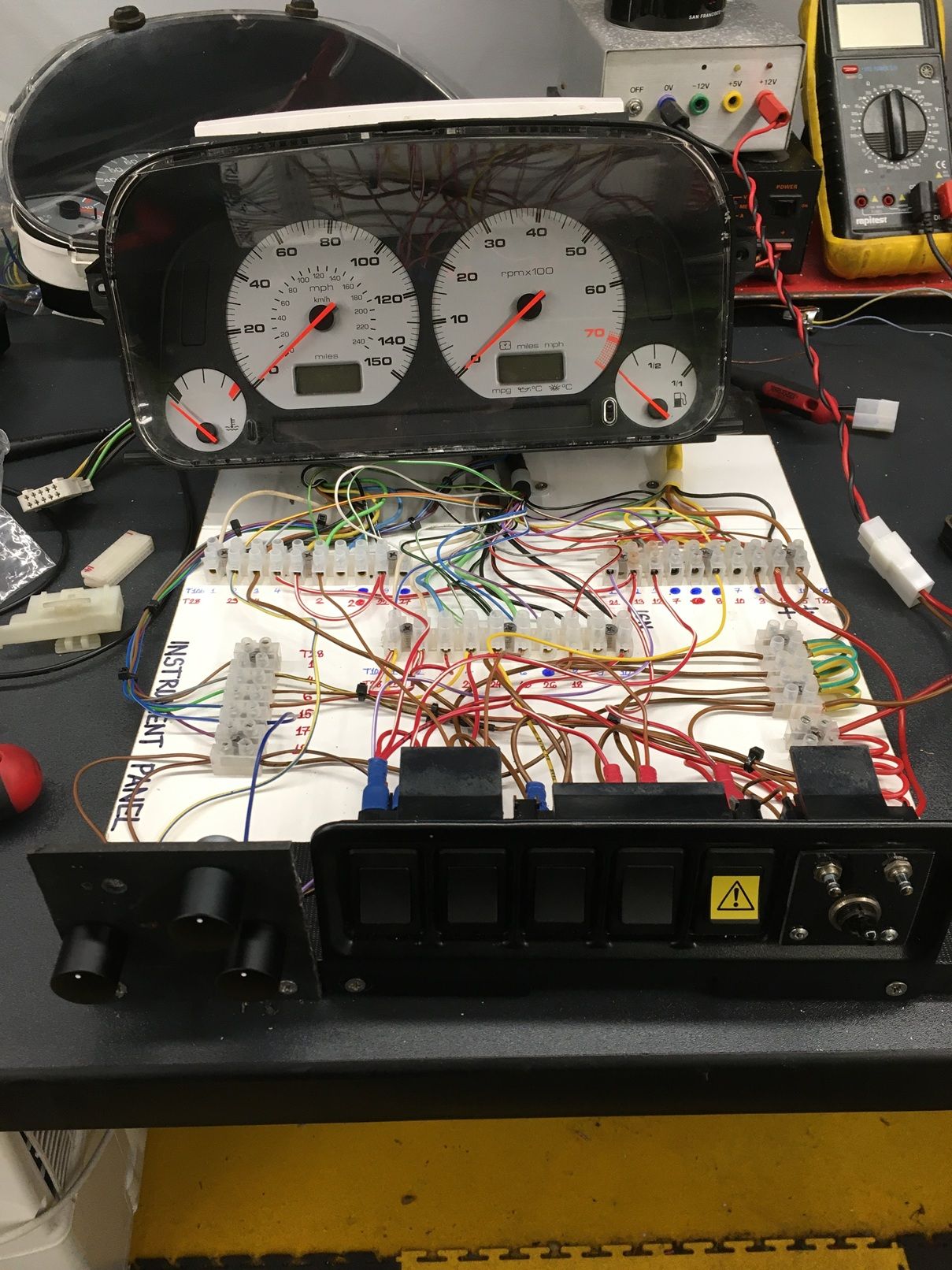

I know what you mean about it being difficult to work out what the warning lights mean. For my Ibizas I made a test rig so I could work-out what conditions at the terminals caused each light to illuminate, and so I can replicate faults on the bench.

I know what you mean about it being difficult to work out what the warning lights mean. For my Ibizas I made a test rig so I could work-out what conditions at the terminals caused each light to illuminate, and so I can replicate faults on the bench.View attachment 54624
That's very cool, I know my way around VCDS, can do logging, basic adaptation, scan codes, test electrical systems and stuff, but that's all software doing the work, you built this yourself, that's sick. I use an adapter from 2x2 plug on the diagnostics port, into the OBD2 scanner, and then into laptop. It's quite a mess of cables to drive around with, but that's just MSA15 things.

Thanks, it's amazing what you can make from an old piece of shelf, a bunch of chocolate blocks, and some wire off-cuts. I have done loads of work on the electrics on my Ibiza and Caddy projects, and this rig has proved its worth many times.
