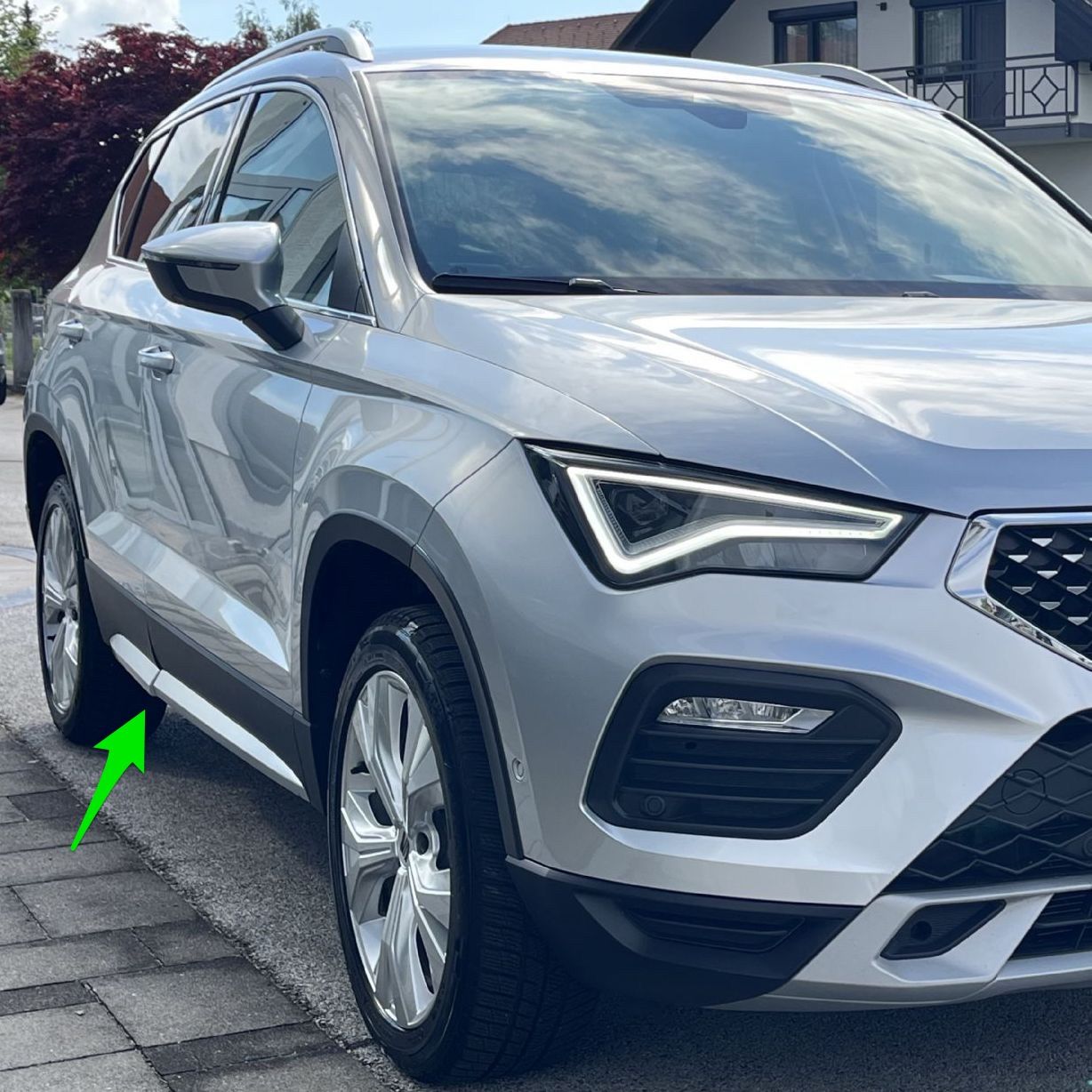

1. On the passenger side, the sill (or whatever it's called) on the lower part of the doors seems to be misaligned with the door closed. See attached screenshot. Is this a reason for concern? Can it be fixed somehow?

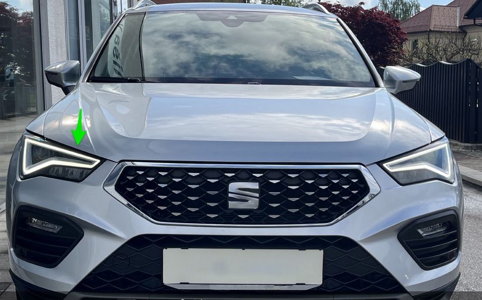

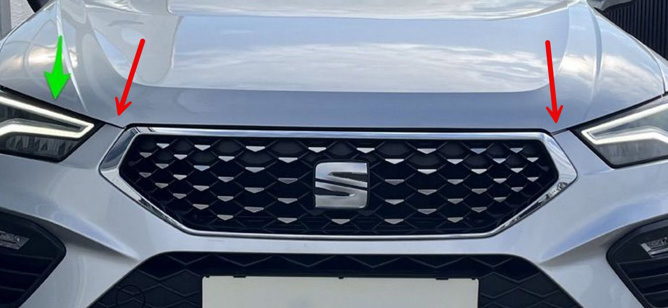

2. Is it just me, or does the gap between the headlight and the bonnet on the left side of the attached 2nd pic seem a bit wider than on the right side of the pic??

Feels like one of those ones that get rejected in the final stage at the dealer which then turn up in car warehouses. 1. Seems concerning.
My rear door isn't totally aligned but I think that could be re hung but I'm not totally bothered by that. Something different to 1. 2016 early production model. Whether that fits into re hanging category pass. You could point out the issue.

Id pass on that car personally. The misaligned bonnet and sill are both on the same side, which raises suspicion of accident damage on that side, coupled with the fact that there is “white residue“. I may be wrong, but such residue is typically polishing dust, created when the the car paint work is cut and polished, typically after it’s been repainted following accident damage.
All the signs suggest to me that this car has been repaired. Not uncommon, but there’s plenty about that haven’t been.
I checked with this car dealership today (they are a certified dealership and repair service for VAG cars) and was told that the misaligned bonnet should probably be easily fixable/aligned and will look into it tomorrow. I'm waiting for them to send me the pics after aligning it and will probably decide then, depending on how they fixed it. What do you think?
By the way, they told me that this car had been damaged slightly before, but on the driver's side, not the passenger side where I saw the misalignment.
