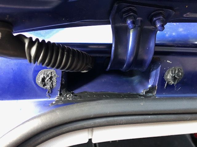

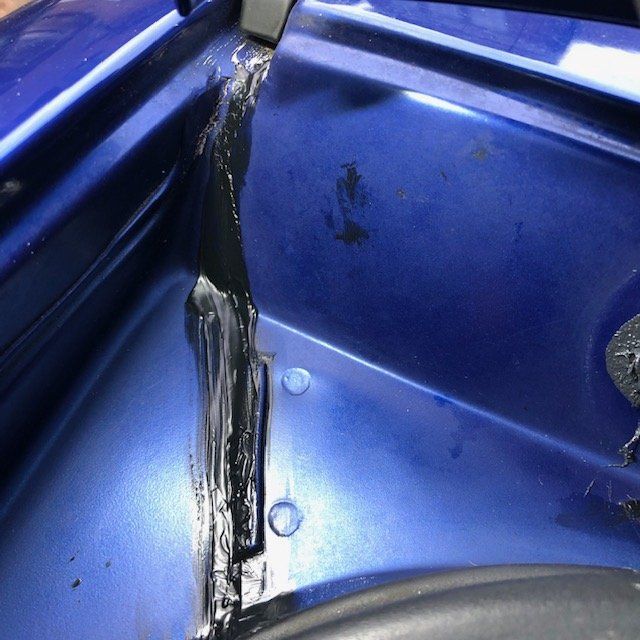

got out there this afternoon with some paintable flexible seam sealer
which is quite runny and some butyl gutter sealer, which I used for the front wiring loom. It sticks like ... to a blanket.
located as shown
seam sealer along the bottom after scraping any lose old seam sealer away and gutter seal where the black plastic cover came from. Just letting the gutter seal get tacky before sticking the cover on
It's meant to rain this week so lets see what happens.
Not rained here today and didn't get chance to put the hose on it, but looks like rain tomorrow morning. The only problem is the gutter sealer that previously stuck to everything has decided not to stick the black plastic hinge cover to the bodywork so not sure if it'll keep the boot dry. I will need to clean it up when I get time and try using the seam sealer.
