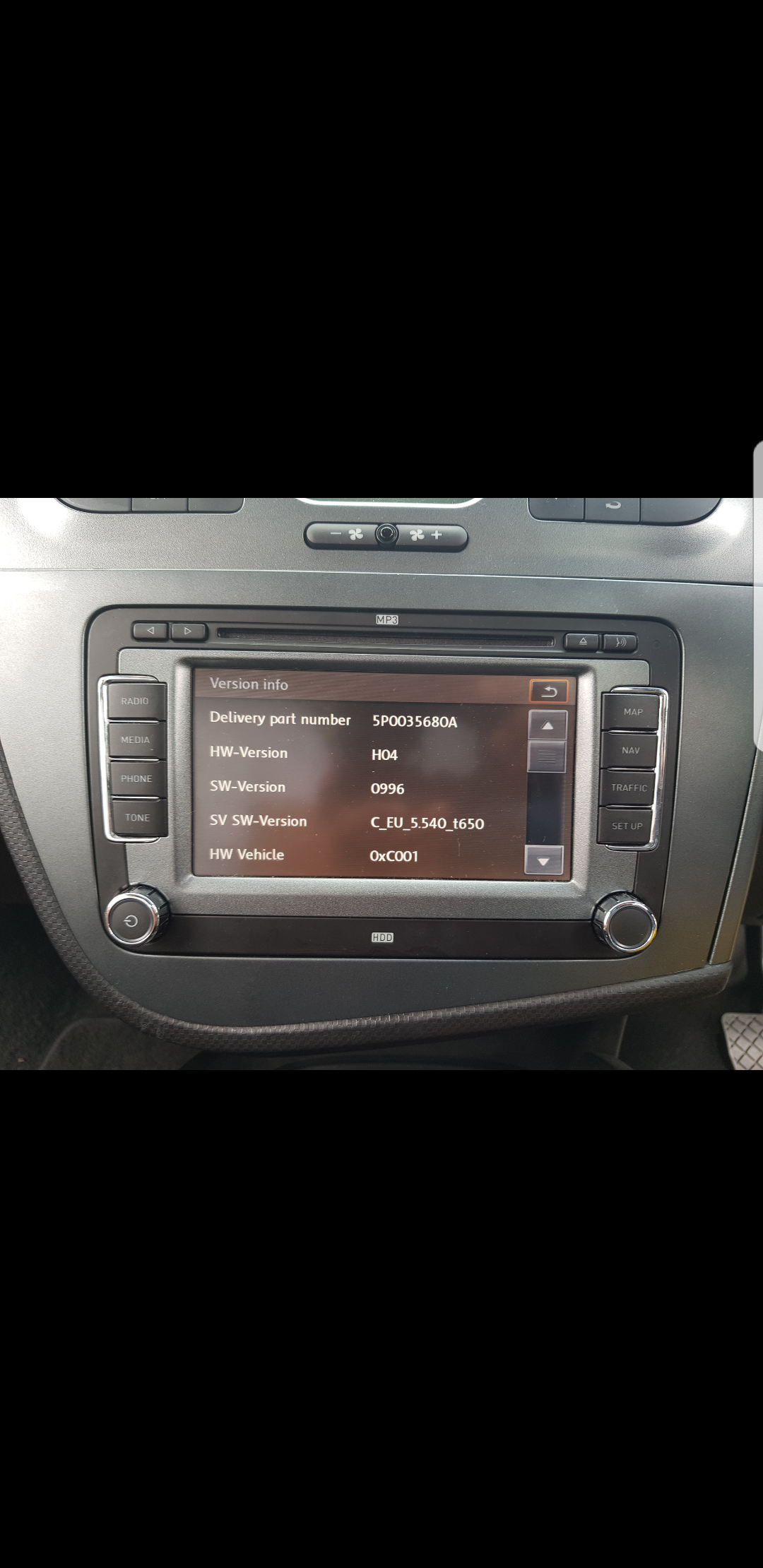

1) It came with the RNS 510 sat nav unit which has bluetooth phone capability but strangely no bluetooth audio playback. I have looked online for driver updates and 5 CDs later still no joy. Can this be done? Also the maps and navigation interface could do with some tweaking.

1) Not sure the 510 supports it, think the 315 does though.

However the bluetooth playback is a must as is the rear parking sensor or camera. I like messing about with car electrics but am nowhere near an expert. The internet shows many upgrades for the rn510 but my one doesn't work
I want to keep the original unit but if it cant be upgraded then I'm going to have to explore aftermarket avenues. After enjoying the benefits of rear parking sensors in my precious 2 cars, i forgot what its like to park without them! Lazy I know considering i come from an era of tape players and parking by eye

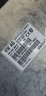

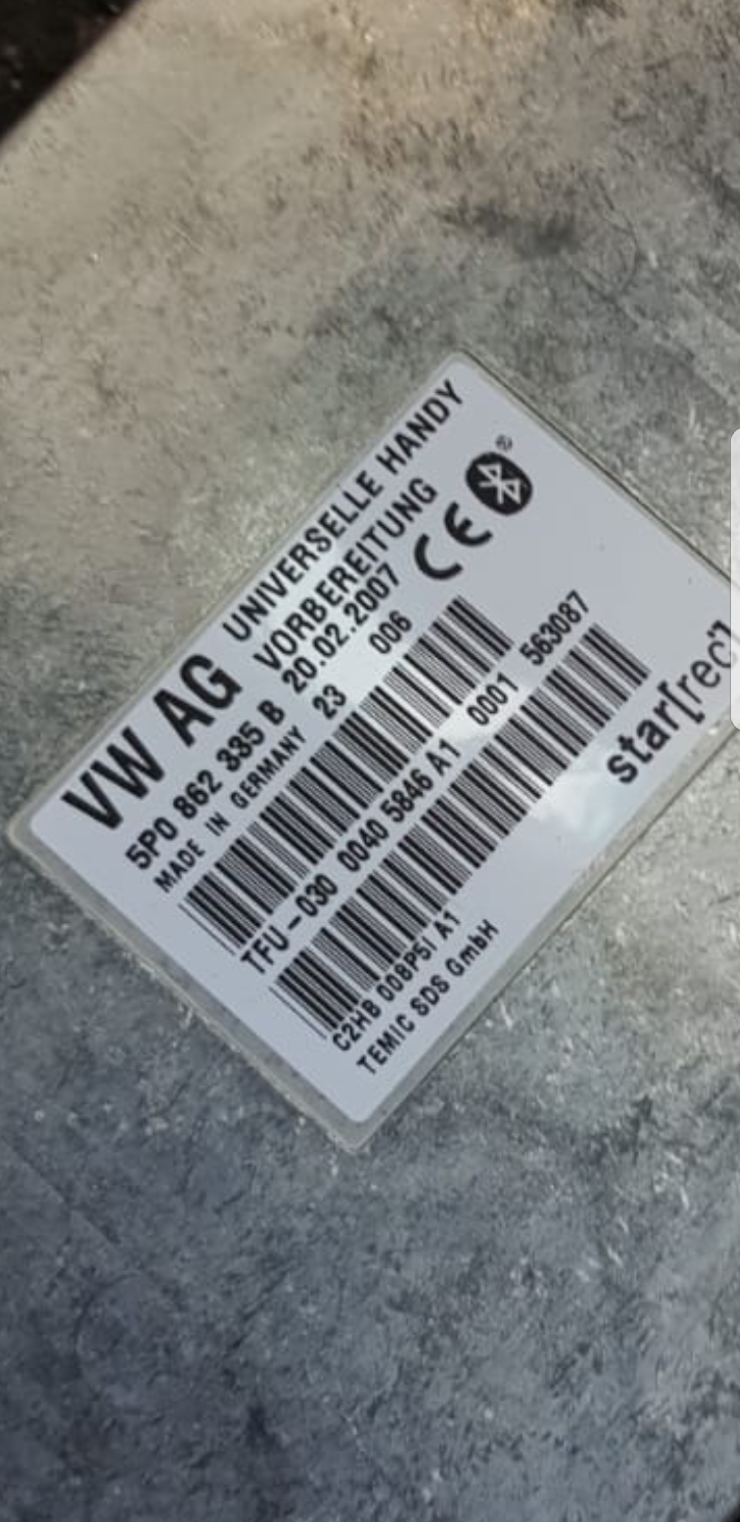

Bluetooth music for rns510 is controlled by the Bluetooth module under the car seat check part number and check your part number on this site for a2dp compatibility.
Otherwise upgrade your module.
http://wiki.ross-tech.com/wiki/index.php/Telephone_Retrofitting
Verstuurd vanaf mijn SM-G970F met Tapatalk
Thanks mate the table reads ??? For the module serial number:( ebay has a few modules for sale
I ordered an ipod converter cable in a bid to keep the dash looking original. (panic/impulse buy:) If sound quality with the cable is compromised then I'll have to find a way to get a fully functional bluetooth connection. I have taken a photo of the module under the driver seat :)

I've checked the bluetooth module under the driver seat and turns out its not a2dp compatible:( does this mean that the bluetooth audio will work if I swap the bluetooth module to an a2dp compatible one? Also will i still need to burn a new driver CD and update the brain of the machine?

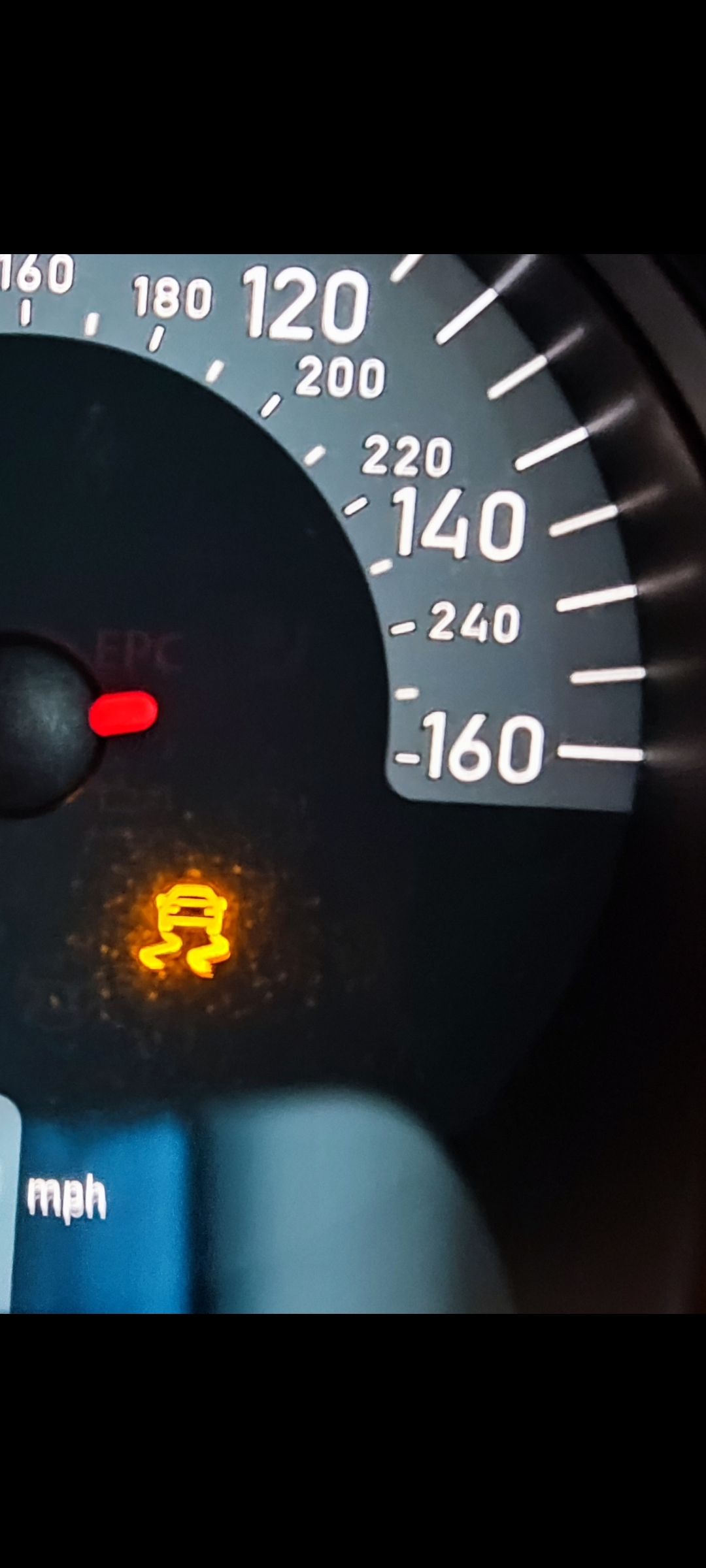

Update: Had the car for over 3 years with no issues until recently with the traction control light coming on. Took it to a known seat specialist who changed the abs pump and bled the brakes. He noted that the abs pump had already been changed before. He then took it for a test drive only to find out that the replacement abs was also faulty. Back to square one with the xmas and new years break in-between.
Lesson learned: just go to your local garage not a "specialist"
Hope you all have a heath & happiness filled new year. Good luck in 2023
Max
P.s the driver door makes a click click noise and wont unlock from the remote key
