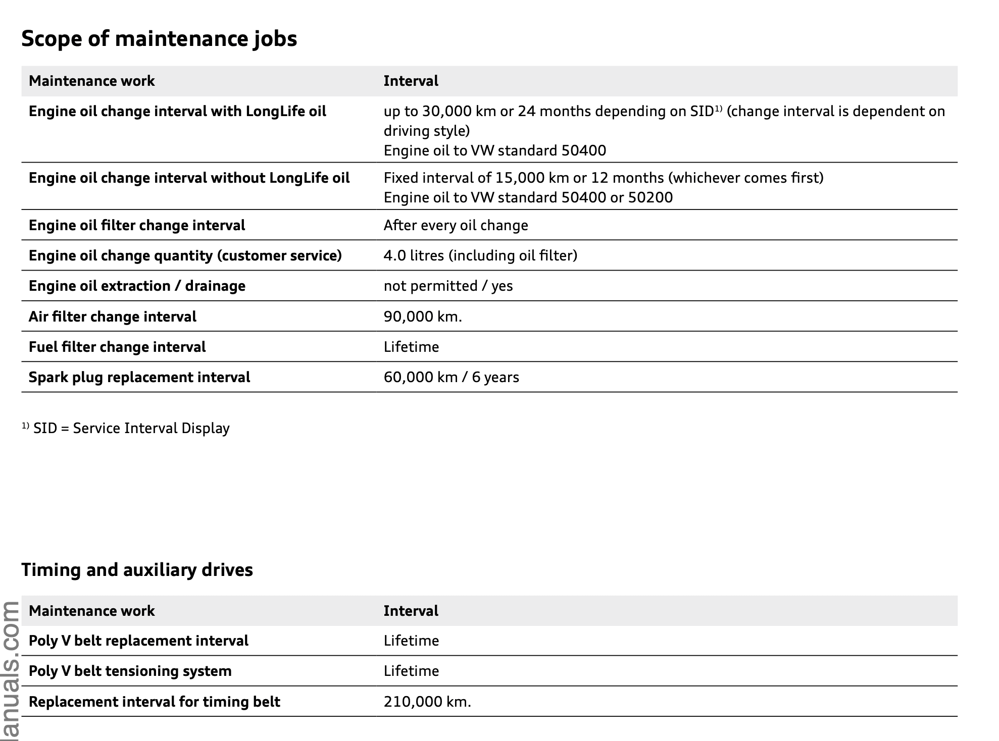

EA211, I see service intervals of 210 000 km ... they might have been extended to 240 000 km as "svensken" stated.
VAG dealers in the UK recommend 5y/50k which is overkill as they want the service income. People have grown accustom to this but even VAG documentation suggests a much longer interval.
The EA211 engines are basically maintenance free IMHO.

They also claim 30,000 miles or 2 years on longlife oil changes, or 15,000 miles or1 year on regular oil!!
Absolutely no way in hell would i ever leave oil in my engine for that long, nor would i leave a belt for 210,000km. Their numbers are pure fantasy IMO.

240 000 km for replace cambelt was the figure when I bought our first Golf mk7 with the ea211 engine. Perhaps they have change it to 210 000 km (minor change).
In any case very long distance!
