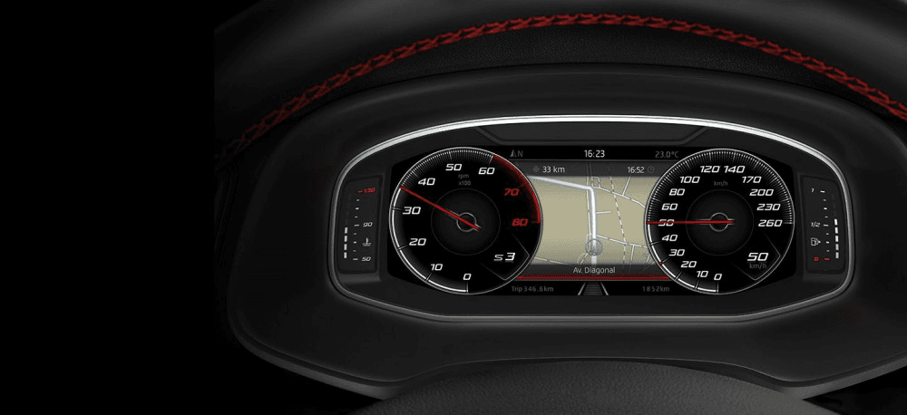

If you are lucky to have got a MY2016 (sold from about Sept 2015) then you will have MIB2, so in that case you can get the Digital Cockpit. However if you want the map view like this...
...then you will still need to upgrade the glovebox unit to a later version of the MIB with a fibre optic cable. But you can still run the digital cockpit without it with nav in the same way you would do now, with just the direction indicators.

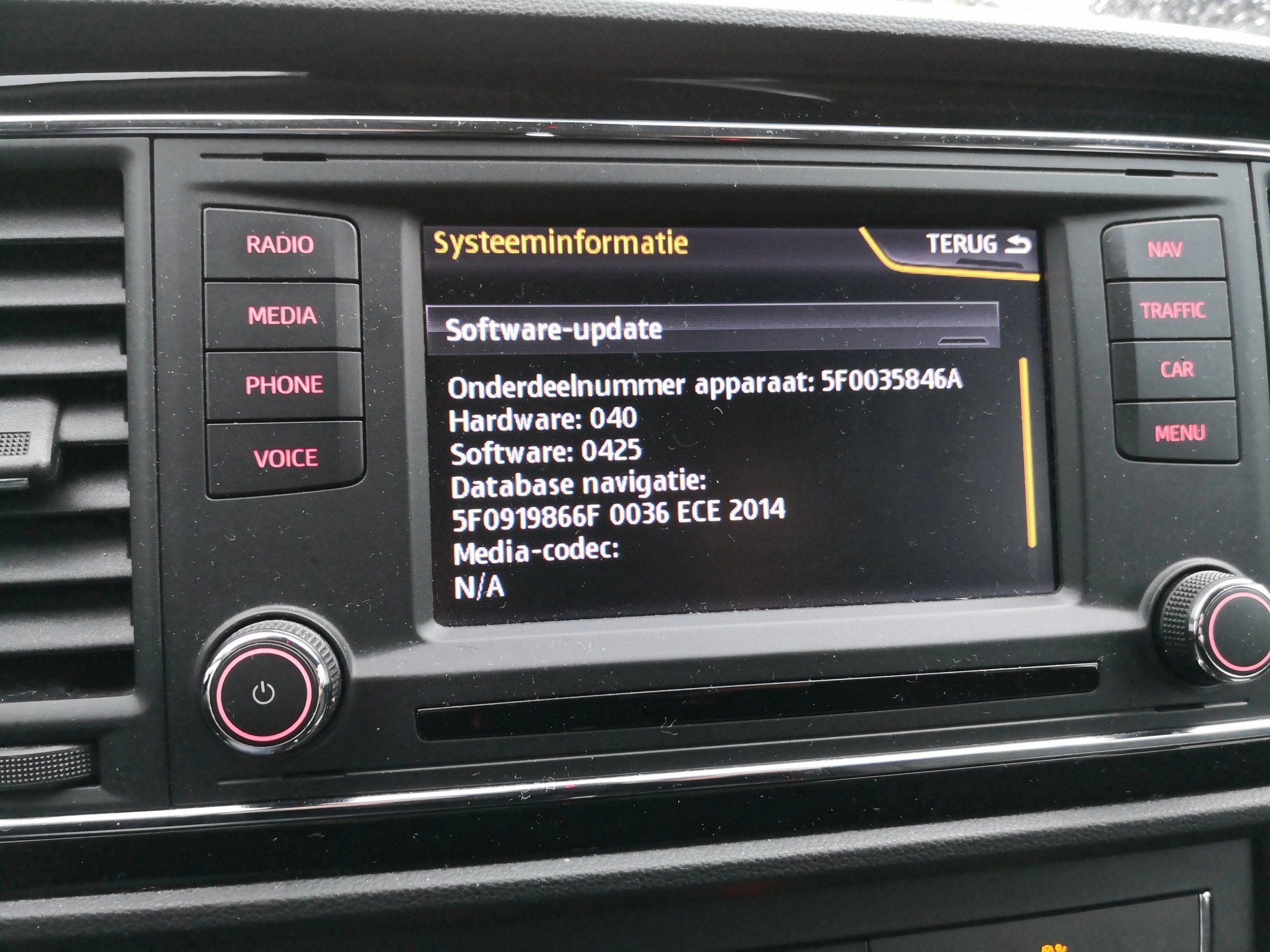

device part number is 5f0035858a. Is that mib1 or 2?
Sorry new to this!There is a chat within the forum which covers this and the unit numbers for MIB1 or 2, just use the search bar and it will come up for you. Happy hunting
Sorry new to this!
Can't say from a part number, but a picture of your central screen will tell me.device part number is 5f0035858a. Is that mib1 or 2?
