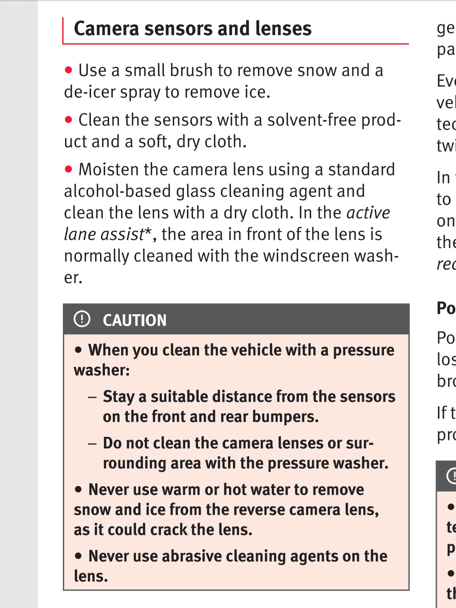

360 / Top View is sensitive to jet washing so can move the camera(s) if given a good blast. Best not to jet wash the cameras in the first place. You dont know what the previous owner has been up to or the dealer. Mine are fine on a regular Ateca when it was offered as an option. Haven't moved.

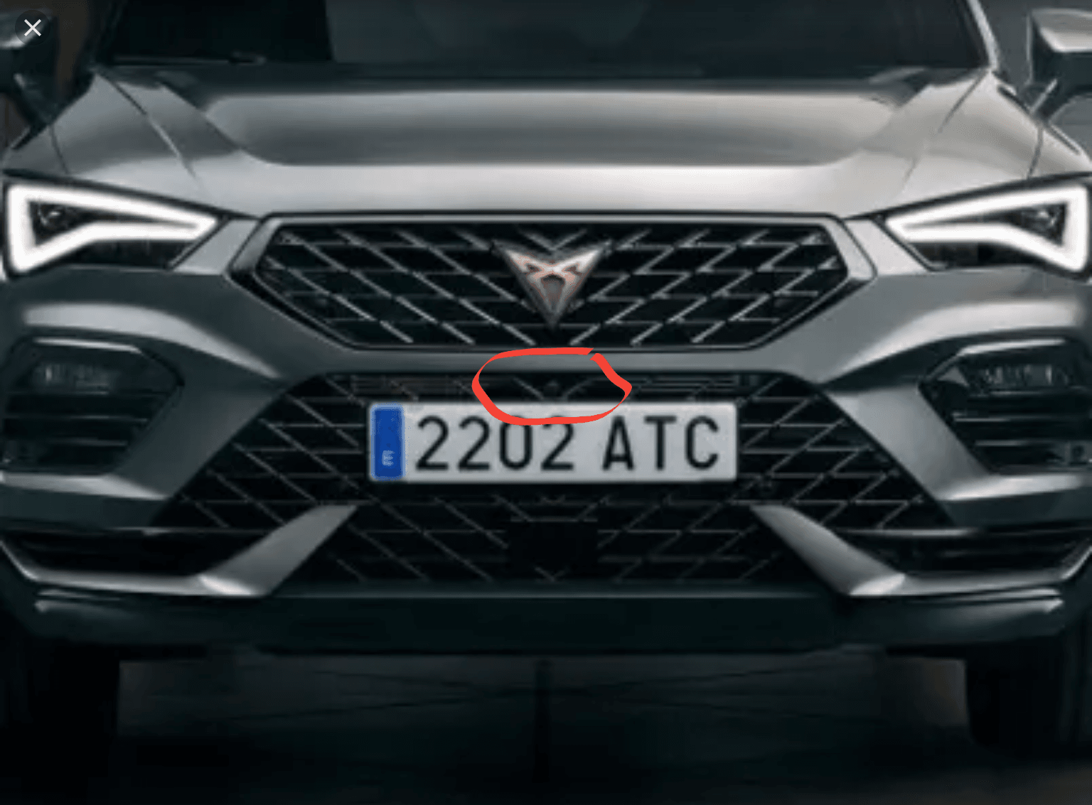

Where are the cameras? I've jet washed mine a few times with (thus far) no ill effects.

Four which you can damage. Front, back and under the wing mirrors. Jet washing them can push / move them in the mount.

I suspect you could physically move them if you stuck your thumb on them.... won't try. I'll have a look when I go out to see whether they are mounted as I recall. That's why they warn about jet washing so they aren't move out of position. Blastered in, or perhaps rotated.

I think it would be unusual if either the front (which I found) or the rear / reversing cameras were to be knocked out of alignmemt by a domestic jet wash (commercail maybe). I think it's an abundance of caution from SEAT. The mirror mounyed ones, maybe, but they're not in a position where I'd typically focus a jet on.
