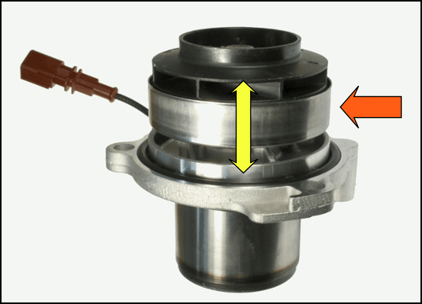

@hewittinspain ref what pump to go for. The factory fitted pump had an electronic actuator that reduced coolant flow when the car started cold to get it warmed up quicker and provide better cold start emissions. That actuator was prone to fail and cause the car to either overheat, like mine did or kept it too cold. Very similar to when yout thermostat goes wonky.
When mine was replaced I opted for an after-market non-actuator type and the car has been fine since.
Not saying one is better than the other but to me it's another case of VAG over-engineering something and then having to offer after-market solutions when it fails. It was a known issue with CUPA and CUNA engine codes for some reason.
