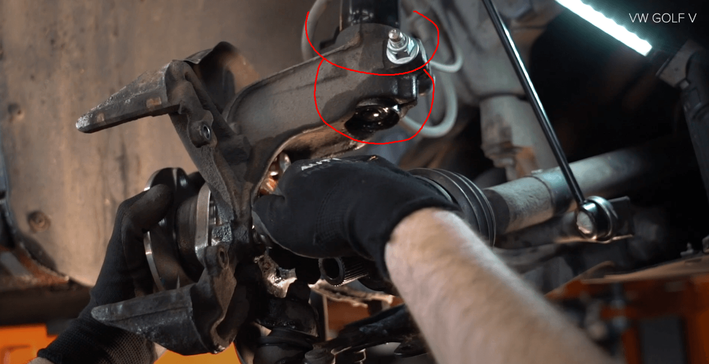

You have to open up the front hub with a splitter tool. This is to remove and refit the shocks
I have made the mistake before of not fully seating the bottom of the shock as far down as it can go inside the hub. Thus increasing ride height at the front.

can you tell only by looking without uninstalling the whole front hub section? because honestly im not such a mechanic and if thats the case, ill do what it takes to fix it, just wanna make sure before doing anything
edit; is that what you mean by not being flat out as far as it can go? seen it on a yt vid

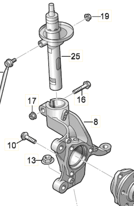

Yes, the strut (number 25) needs to be fully seated/down in the knuckle (number 8)
Normally cars have a dent in the back of the strut which the bolt (number 16) goes through so you can't get it wrong (the bolt wouldn't go in) - but looking at images for the front Leon/Golf damper it looks just a flat tube - so this could be the issue?

do you mean bolt 16 is just for closing down pressure for the strut to sit in or does it go inside the strut like a hole or something? and the strut just sits inside the knuckle inside its hole there and is a flat bottom so its got nowhere to go? i probably sound dumb cus i dont understand nothing here LOL never been more confused

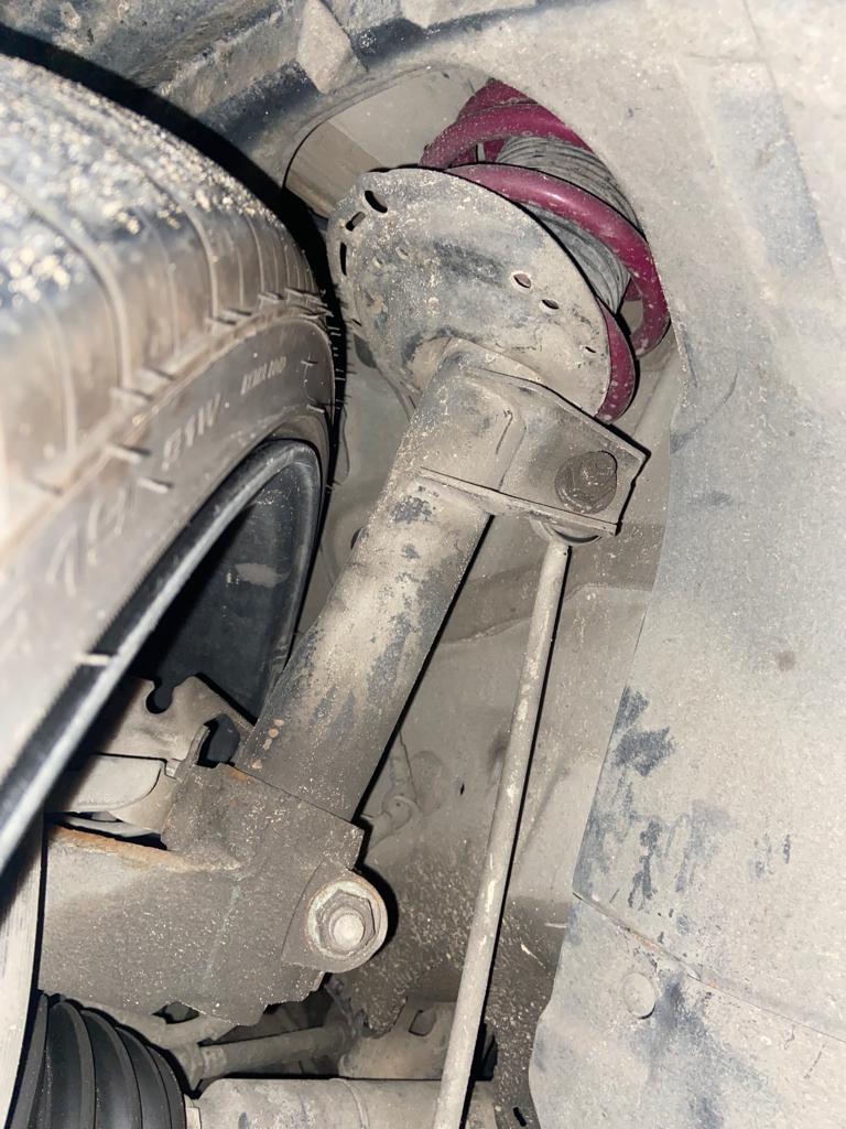

i took pictures of my strut and springs if you can tell anything

Bolt 16 is just used to clamp the shock in place (no locator)
From the pictures it looks fine. The shock looks properly seated.

Is the spring properly on the seat?
What springs are they? What's the part number?
I would be checking the springs themselves for a part number or paint code and checking with the supplier that they are correct, boxes can be filled with the wrong parts.
