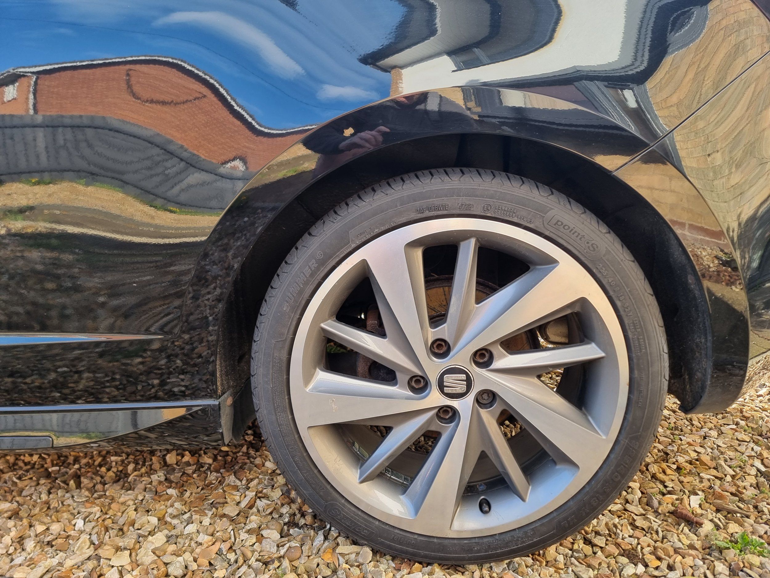

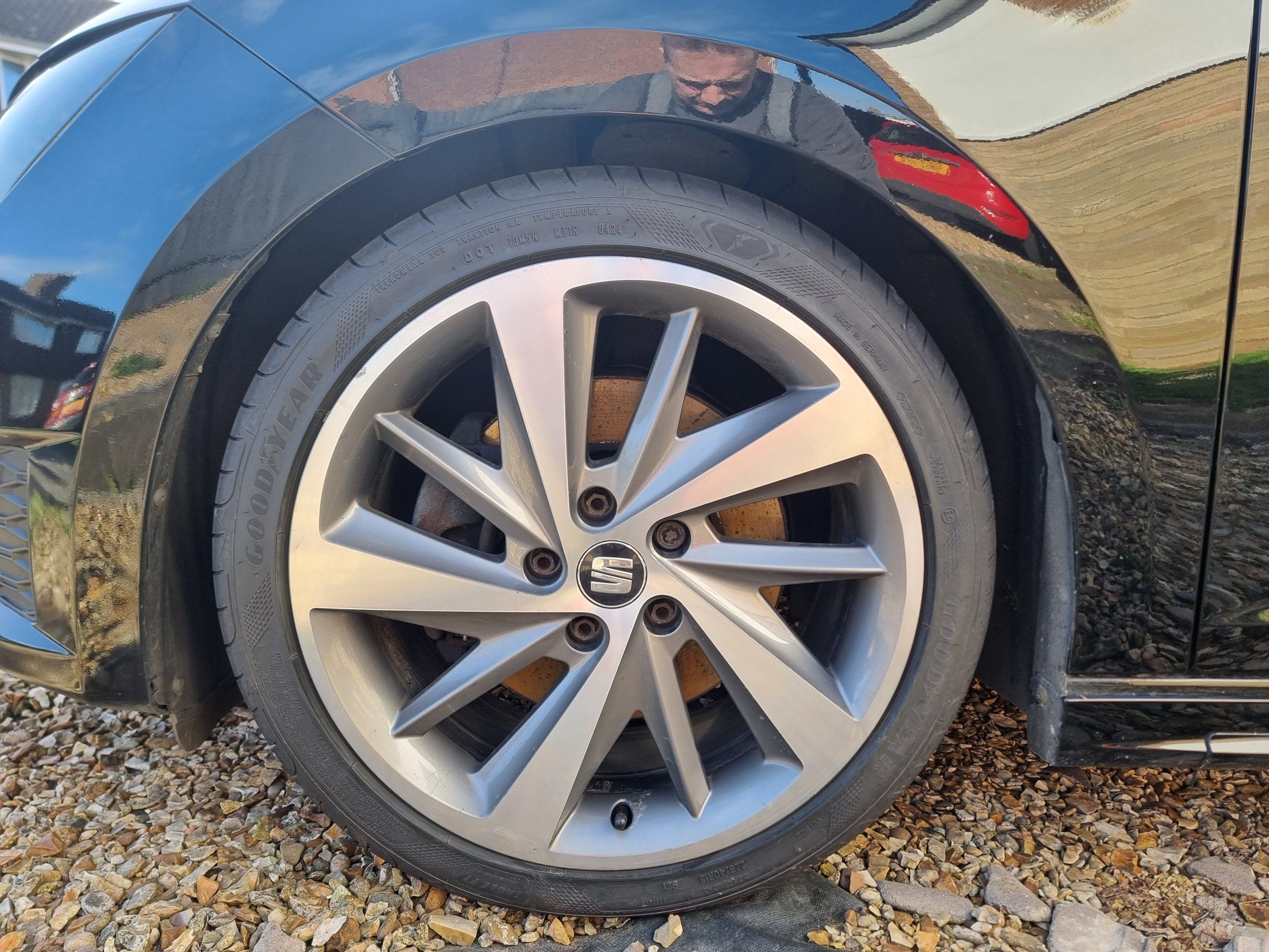

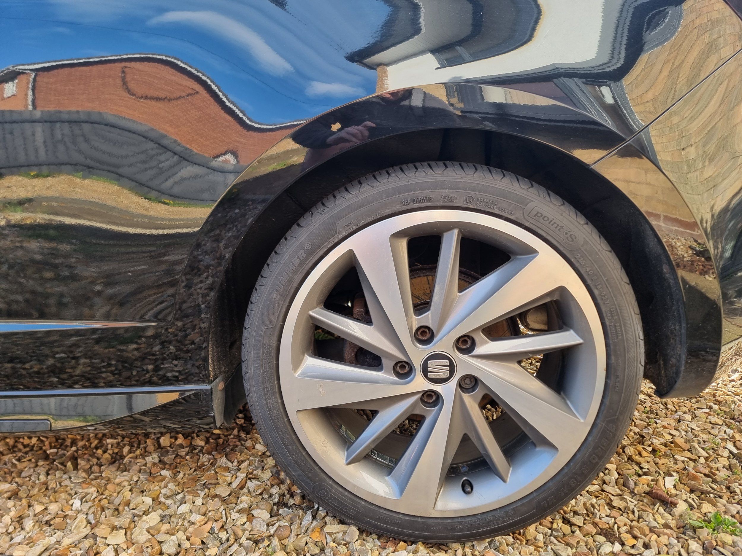

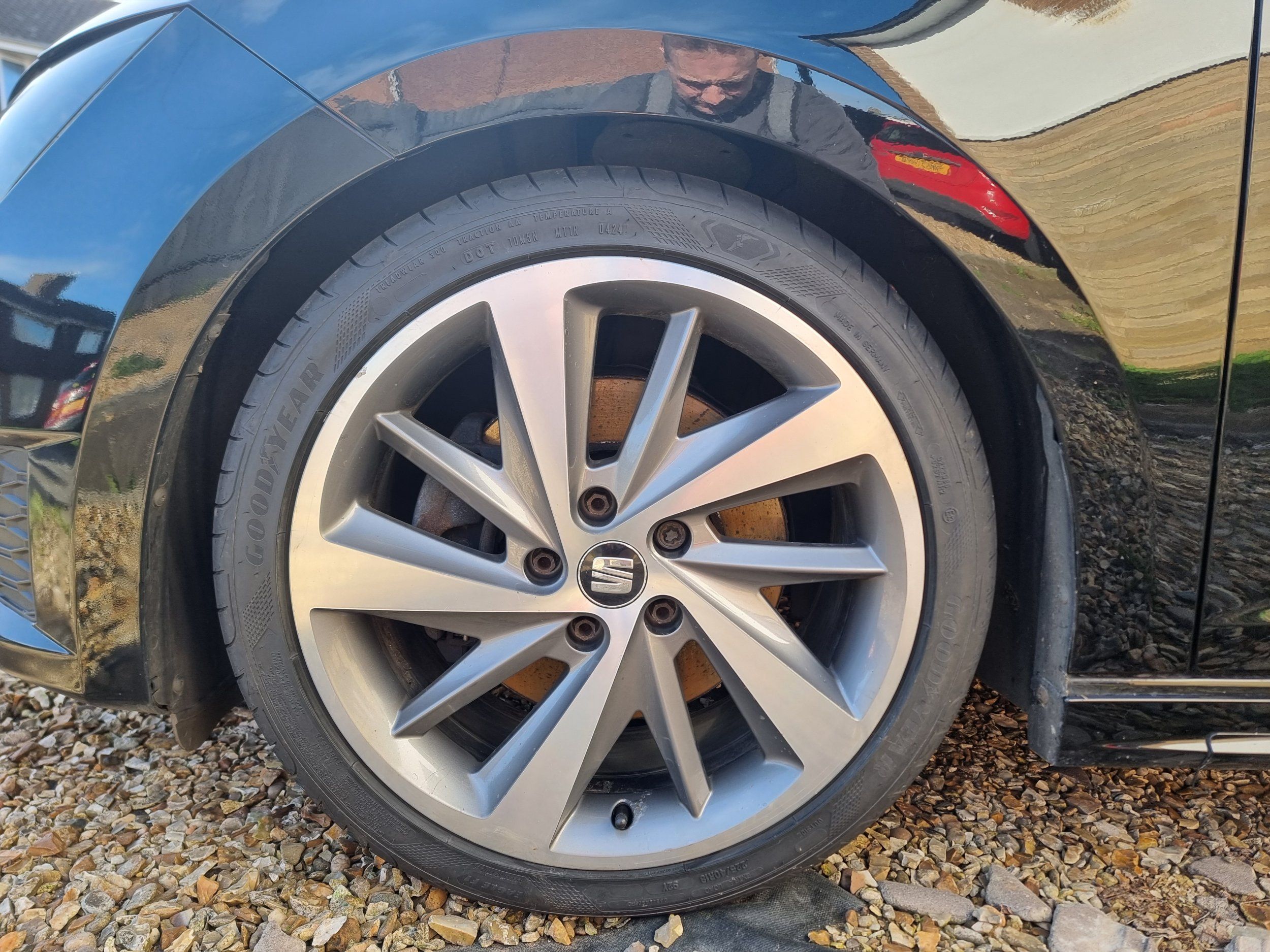

I put these exact springs on my Leon 5f 184.
I don't have spacers on, though I kinda wish I did haha.
Reactions: Mobbs69
Nah mate, tbh after I put them on I kinda wish I went 40. I only went 35 cause the roads round my way are next level shite.
Back
Front
