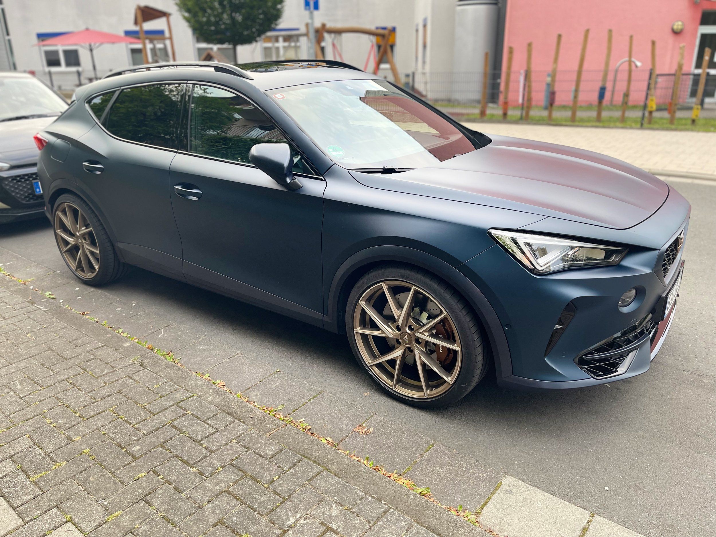

i've 8,5 x 20" ET38 with Brembo. More pics in my sig.
TBH, i do prefer the original wheels that came with that variant. But if your happy that's all that matters.
