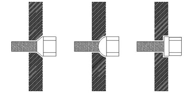

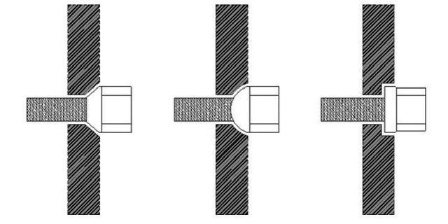

b) if different wheel bolts are required for your new alloys. Seat original equipment alloys use wheel bolts with a radius / ball seat and many (the majority of?) aftermarket alloys use bolts with a tapered / conical seat; the differences can be seen in the picture below (radius / ball seat in the middle and tapered / conical seat on the left). From a safety perspective, it is very important the correct wheel bolts for the wheels are used to maximise the contact patch between the wheel bolt seat and the profile of the bolt hole in the wheel. Using the incorrect bolts could a) put undue strain on the bolts b) result in the bolts working loose.​

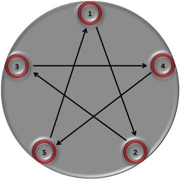

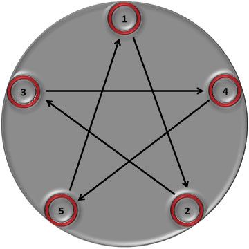

  • Bolt tightening sequence and procedure; The correct wheel bolt tightening sequence should be followed and the bolts torqued up to Seat’s spec (I think it’s 120 Nm but I’m not 100% certain, so something to check). With a five bolt wheel, the bolts should be tightened in a star sequence (see below) - finger tight first while the car is still jacked up. Then go around a second time (same star sequence) and tighten using a wheel brace (but not over tight). Lower the car to the ground and using a torque wrench, torque up to the correct torque setting - again, using the star sequence.

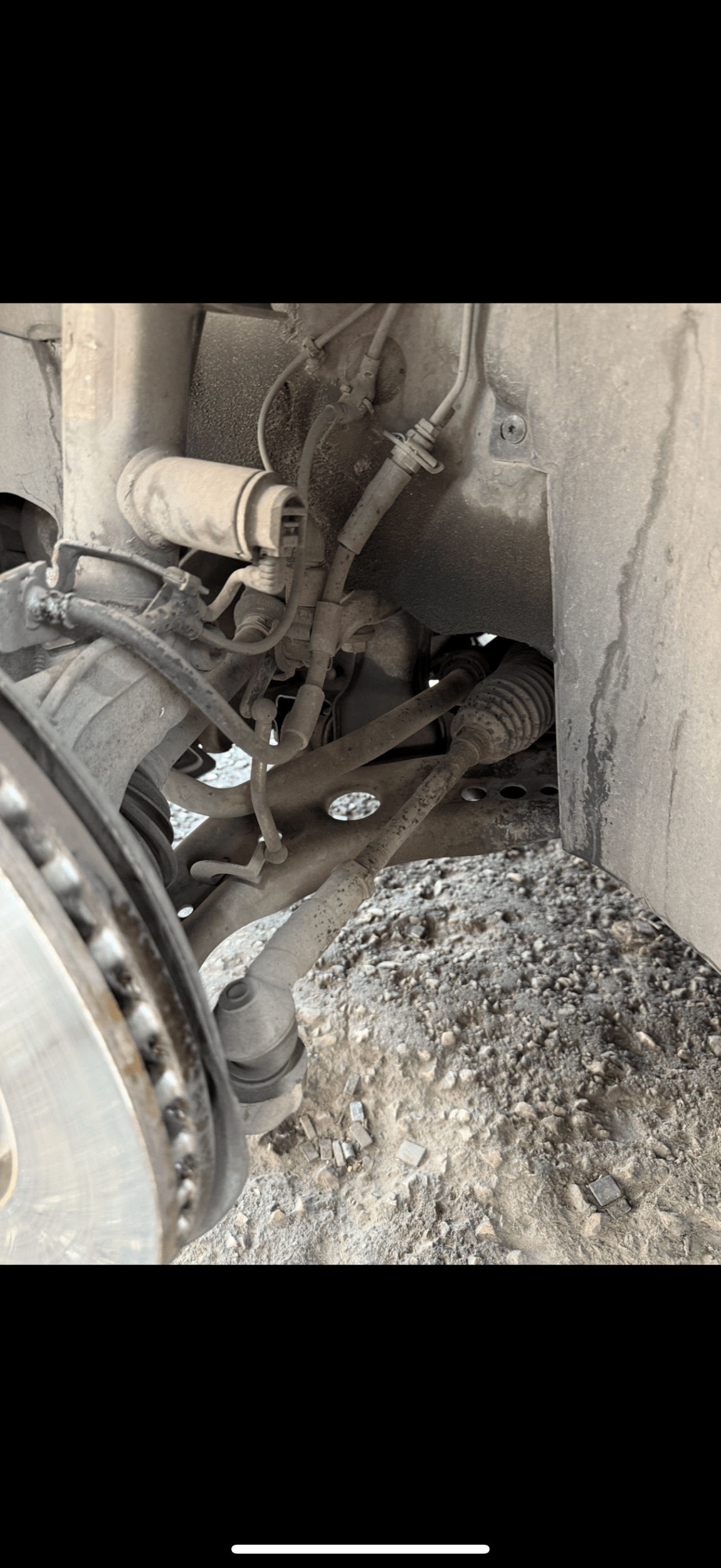

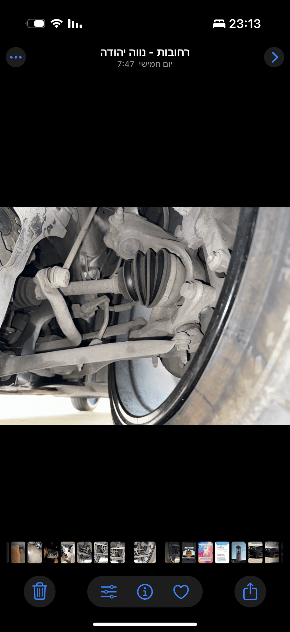

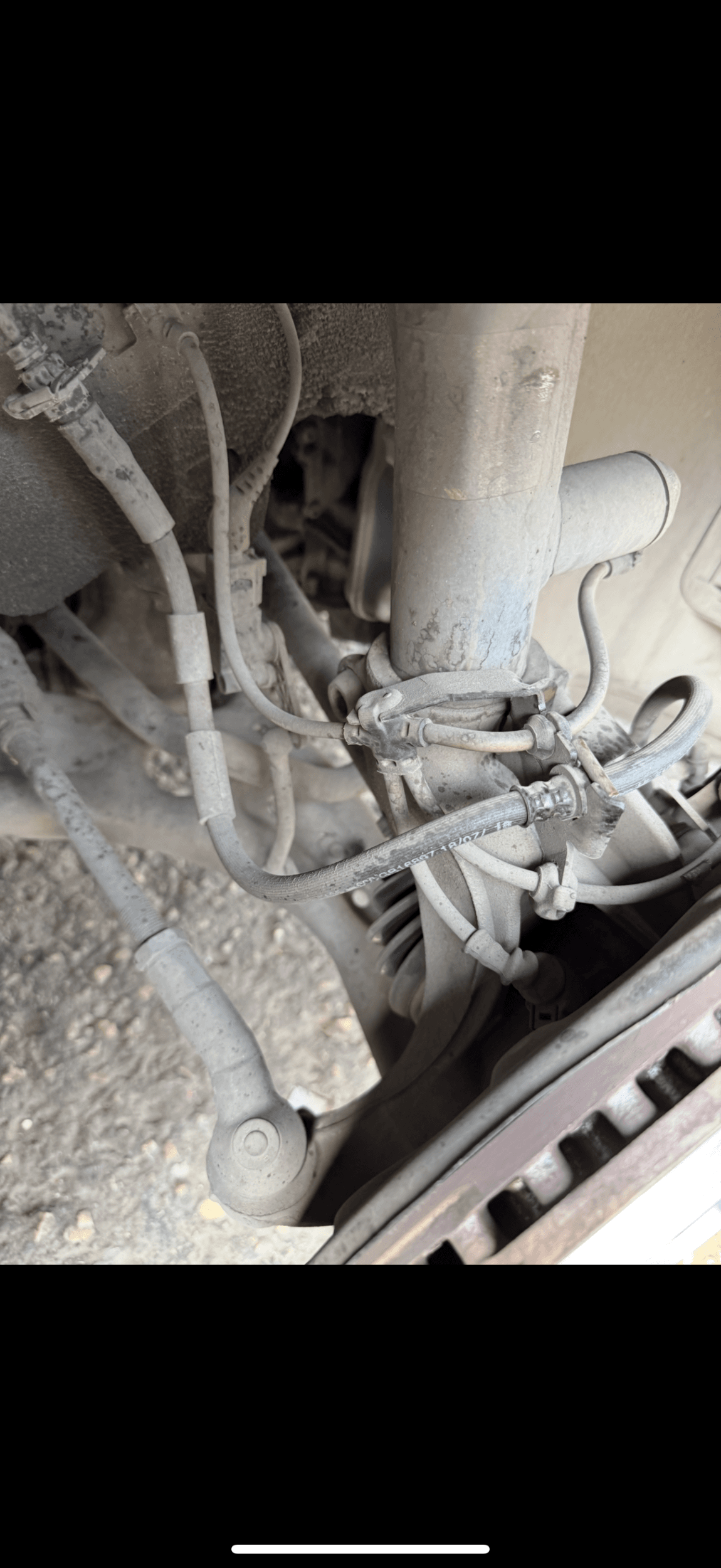

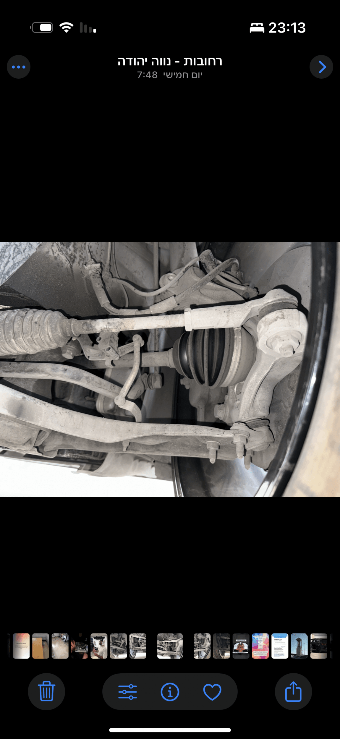

From what I saw the suspension looks ok
