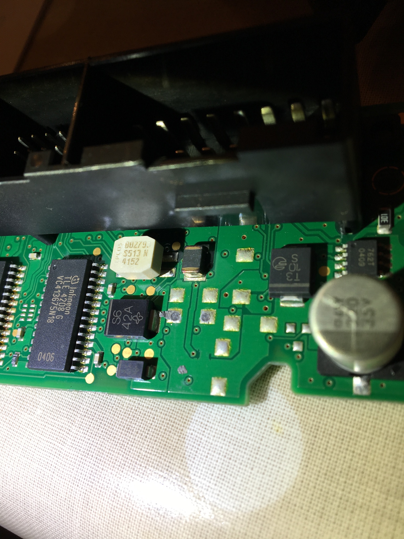

I took the climatronic unit apart and I found the solder pad had fouled on the casing and it looks like it has bridged to another component. I bought and fitted another unit from a breakers to no avail so I opened that one up and found the same rub marks on the board, there was no evident bridging though. Does anybody have any suggestions where to go from here to get my air con back up and running? I’m going to try a variable resistor next and just put the ‘missing’ pin in.

The 2 marked solder pads in your picture - I'm guessing that you feel that something should be mounted on there and maybe that is the control sensor in a fully auto system, but is your system a fully auto one and has it ever worked okay in the past?

The two solder pads are marked because the screws that fix into the underside distort the plastic and foul the board, i believe this problem was rectified with the suffix E part by a better designed case.
The replacement suffix B part also showed the same fouling of the circuit board upon closer inspection.
