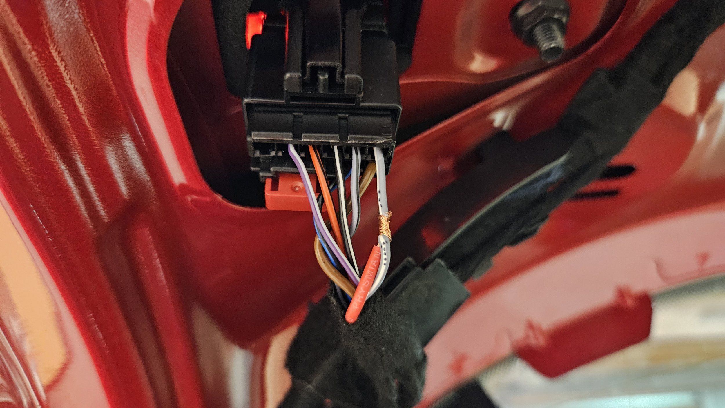

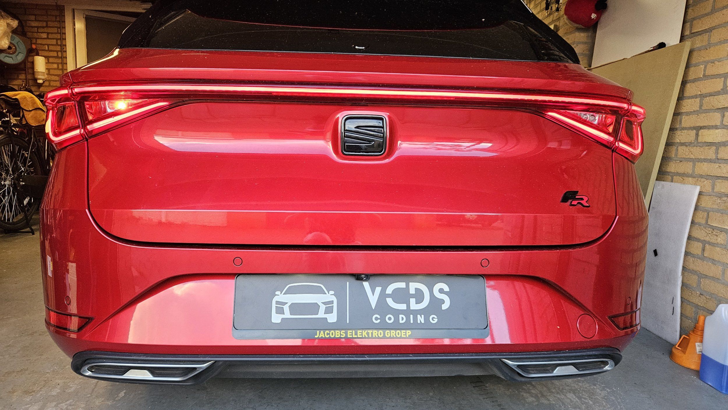

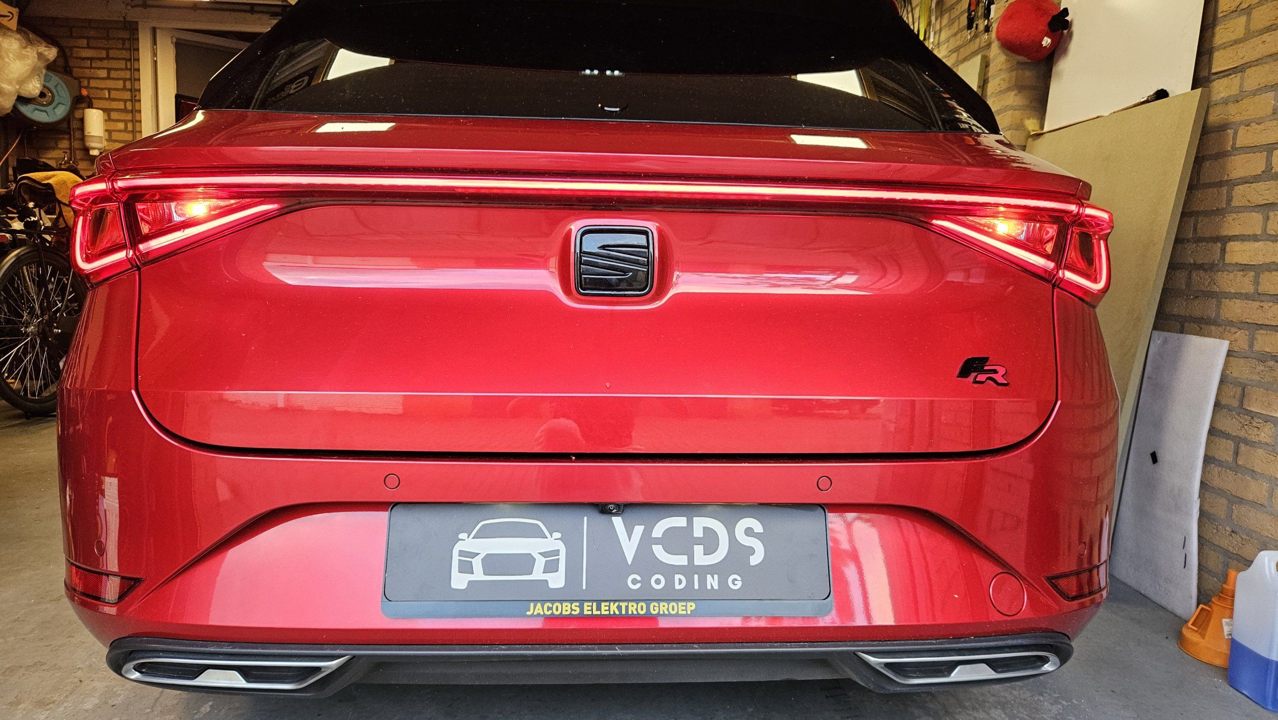

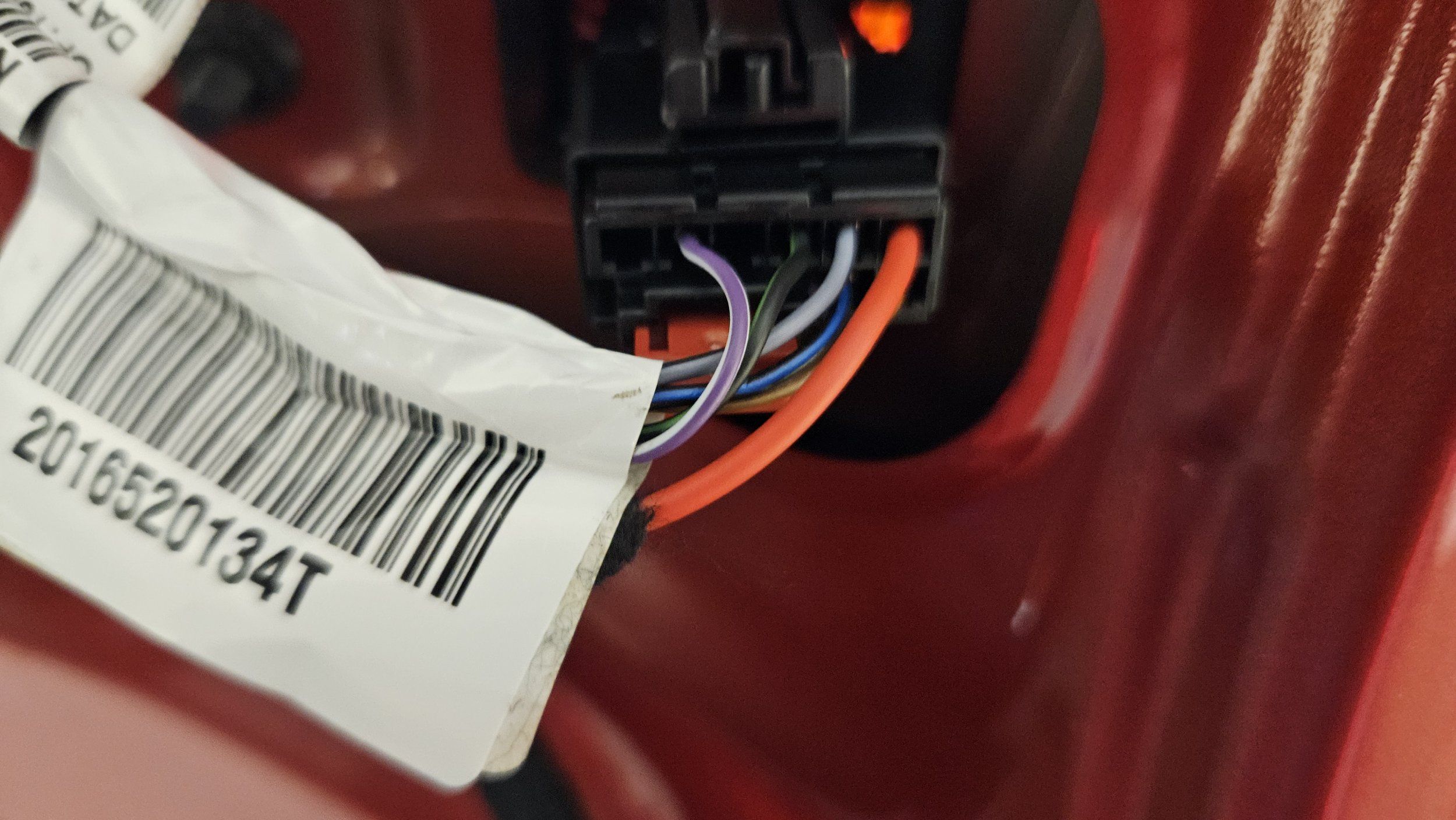

I saw that the Leon KL have 1 foglight at the rear. But in UK on the other side. So i looked on the taillights iff there is also a foglight on the other side. I saw leds so i assumed there was also a foglight.
I found a unused pin on the inner taillight (pin 3) and figured ot out it is for the foglight.
To get 2 foglights it a simple mod.
Tak a wire for +/- 100cm and a connector for the free space on the side where there is no working foglight (EU right side / UK left side).
Put in the wire connector in the free space (Pin 3) and route the wire to the other side a solderen the wire on the existing wire of Pin 3.
DONE

Hi, thanks for the tutorial, but in my case didn't worked. Plugged the cable and the right light doesn't light up. Checked the voltage and had +14vdc on the black connector with the black cables of the light. My light have the led on the outside and the pin in the socket. The car was produced late 2023.
Did you connect on the right pin? Show picture off the pins and the lights at the rear
I don't have a picture of the cables and connector (already closed the cover) but I did install the cable on the same position. The connector has equal to yours (number of cables and colors).

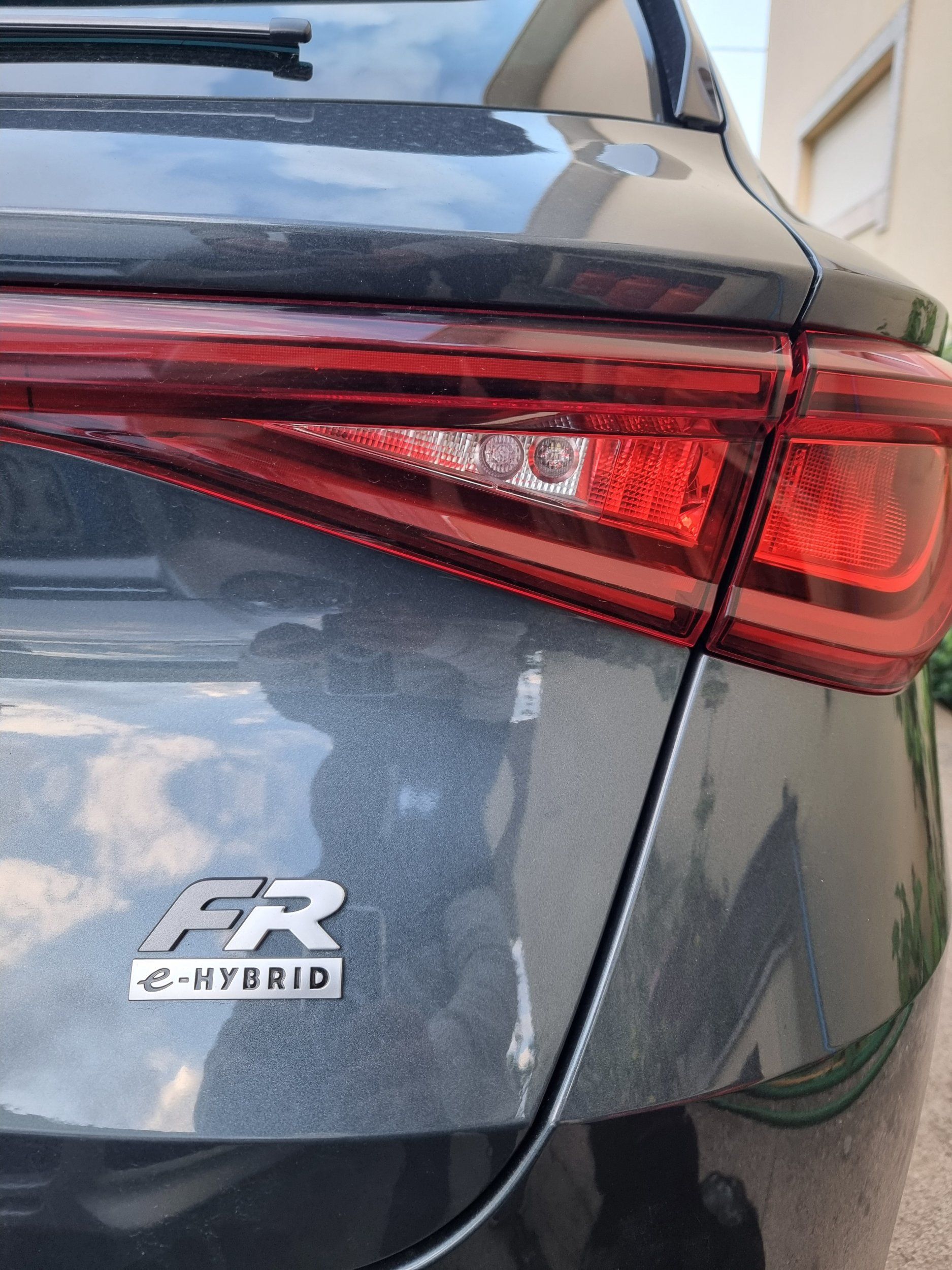

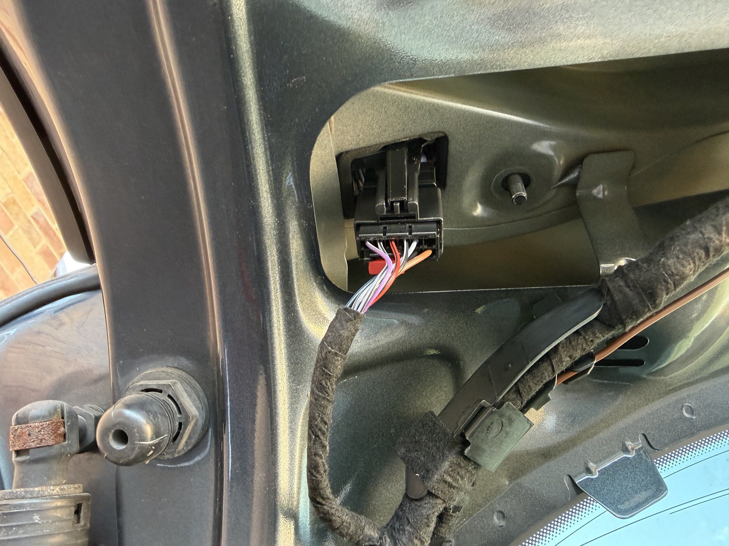

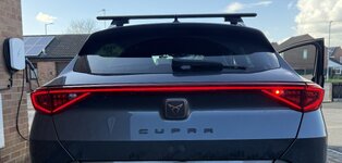

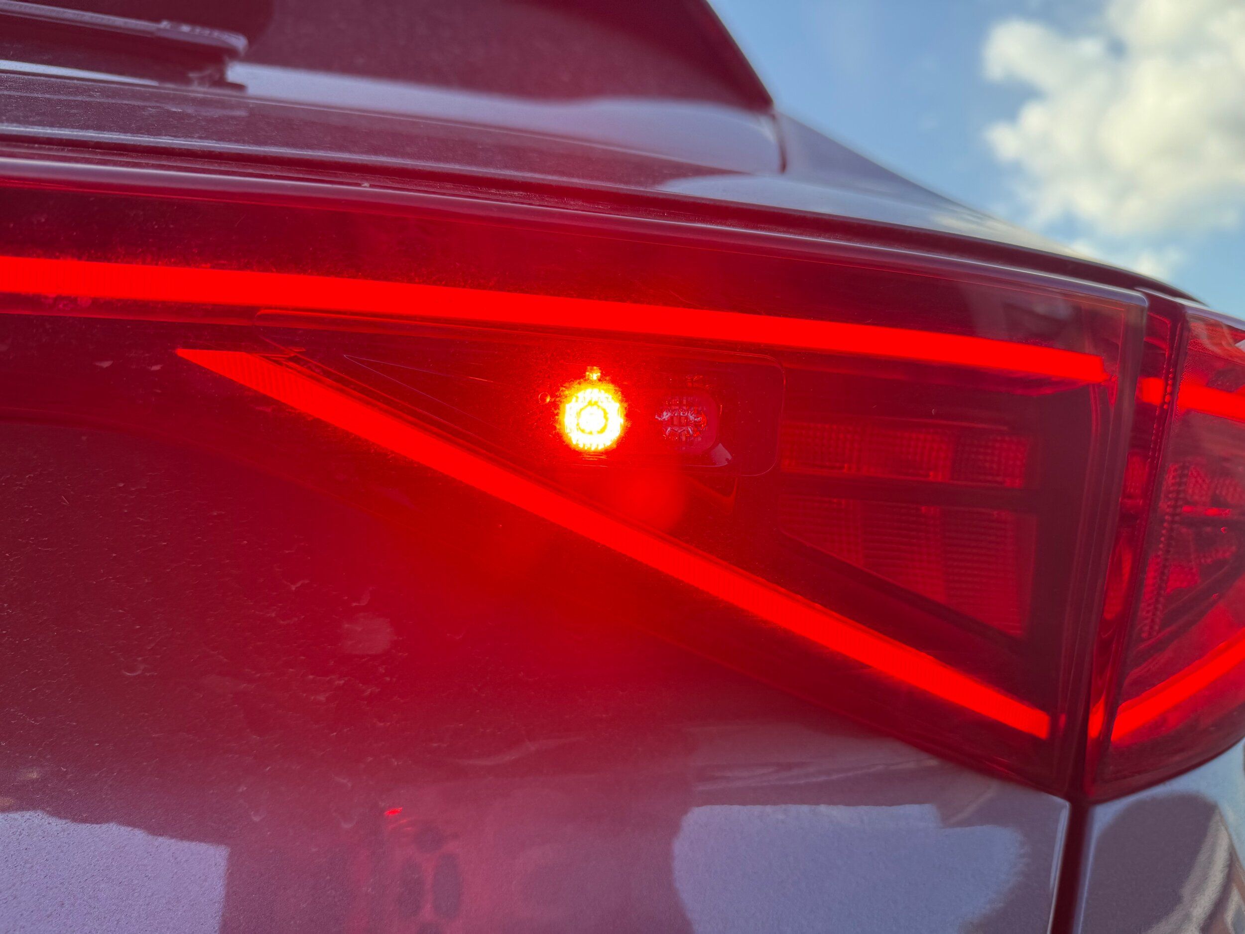

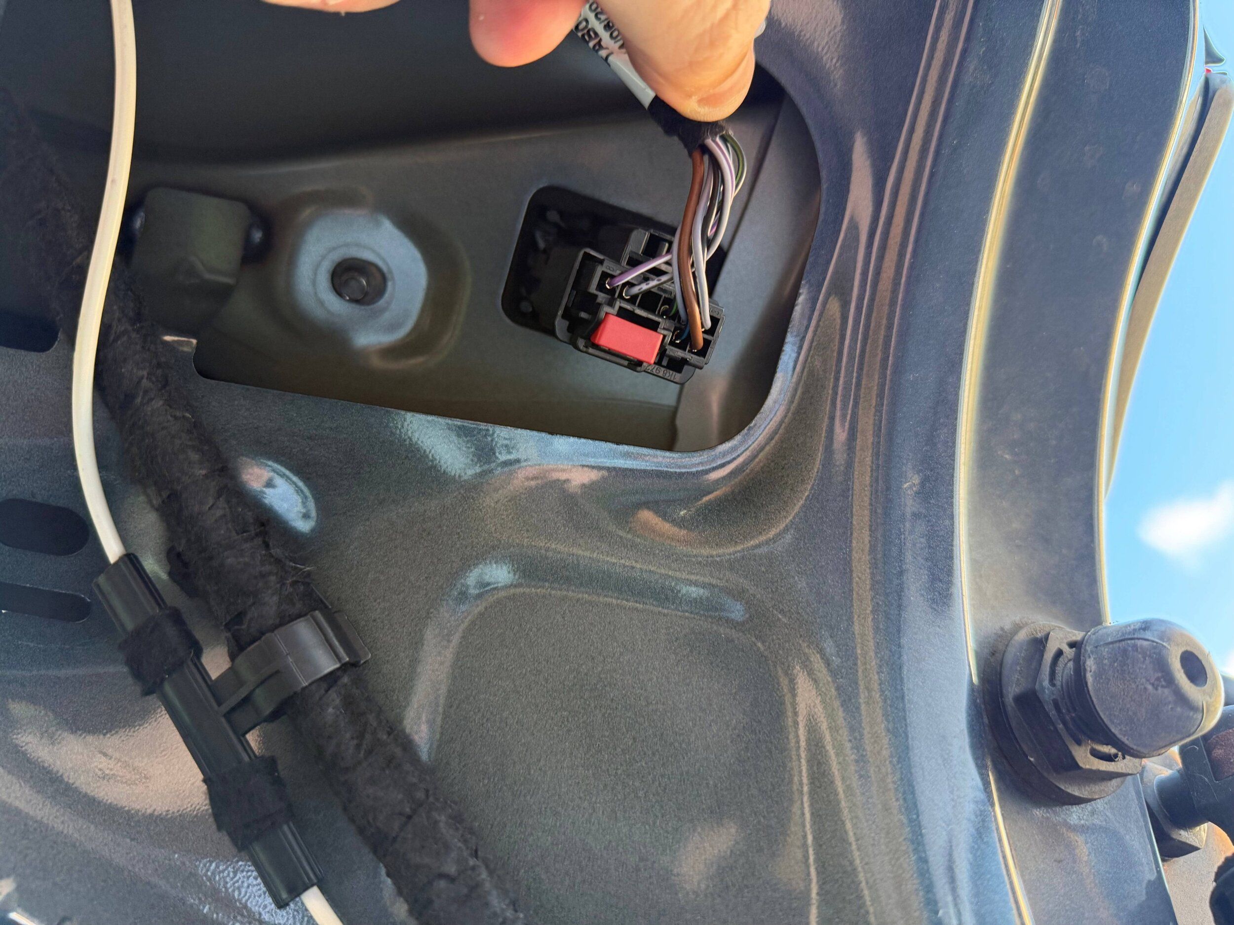

Hey Antera,
Sorry to revive an old thread that is no longer active, but I was wondering if you may be able to help. I’m in a similar situation with my car (although is a Cupra Formentor, RHD).
I’m also under the impression that my rear inner taillight has an unused LED on the left side (right side where the rear fog light illuminates as the car is RHD). Trying to get both to illuminate. I’ve seen the two connector pins on the left and right have different colour cable connections compared to the cables in your images: see mine below (first pic left side, second pic right).
Do you know if the pins correspond to the same as yours? You said you soldered the wire to the wire on pin 3, but I can see that from your picture you’ve wrapped the red cable around the grey cable in what appears to be pin 6 (correct me if I am wrong) on the side where the rear fog light already exists. I tried doing the same but for the other side, but couldn’t get my left rear fog light to illuminate. I linked a wire to the left connector in pin slot 6 as that was empty, and had it connect to the grey wire in the right connector, pin slot 6, assuming this is the cable (but only guessing). Couldn’t get the light to appear on the left at all.
Not sure if you have any further thoughts, or it may just be that I don’t have a fog light in the left side (it looks like an led existe though).
