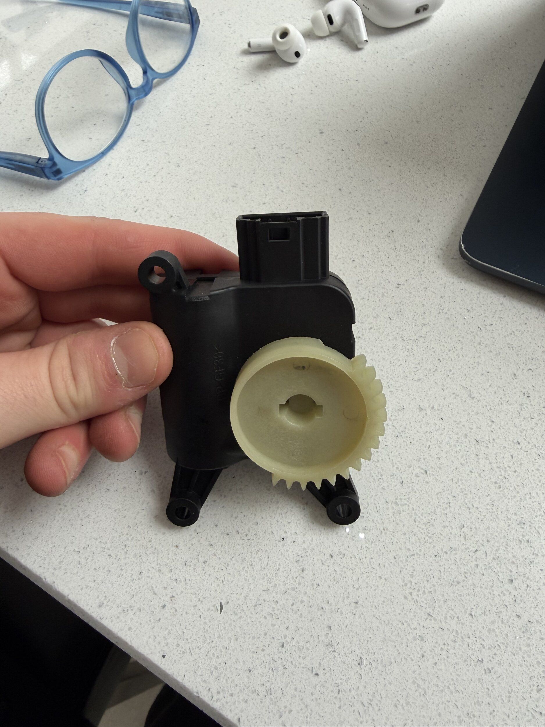

So I purchased this actuator which I believe is the correct one for my Seat. However after removing the glovebox I cant see anywhere that it actually fits? There seems to be a lot of white cloth that blocks a lot of the view. Here is a video of what I could see:
If anyone could help that would be great. Some instructions from the video on YouTube would be great.

I think, that from my experience on a 2002 VW Polo, and VW Group does not change designs dramatically - unless you know otherwise for this "area", that the heart of the cabin air system, in terms of the heater matrix and chiller evaporator - and so the associated flap motor assemblies, is located in the centre of the car. So maybe a bit of tricky feeling in and/or using a camera and/or mirror, should lead you into the right area.
