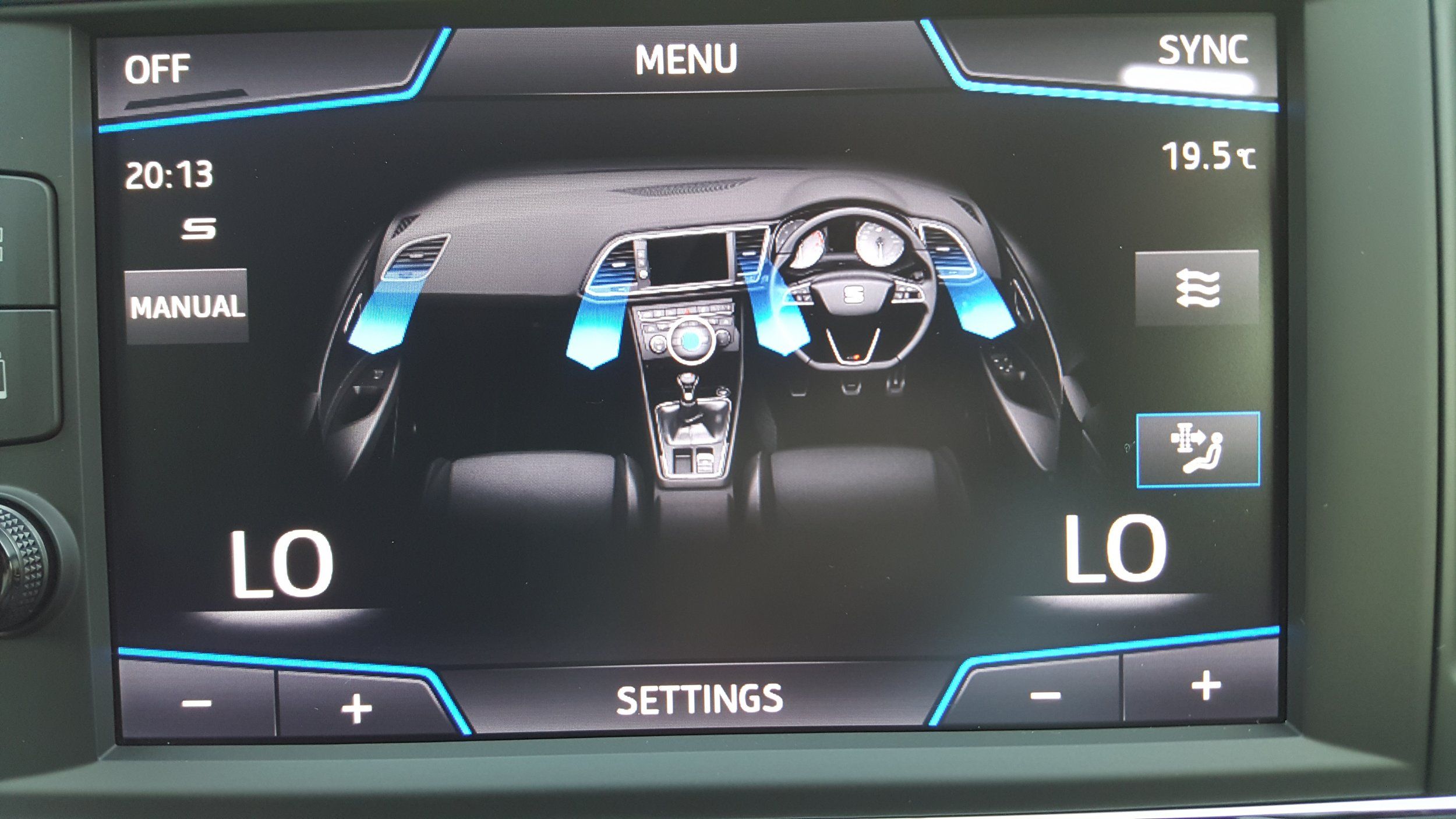

I did have a play about with the Air Con settings and came across this botton with the wavey lines over to the right...

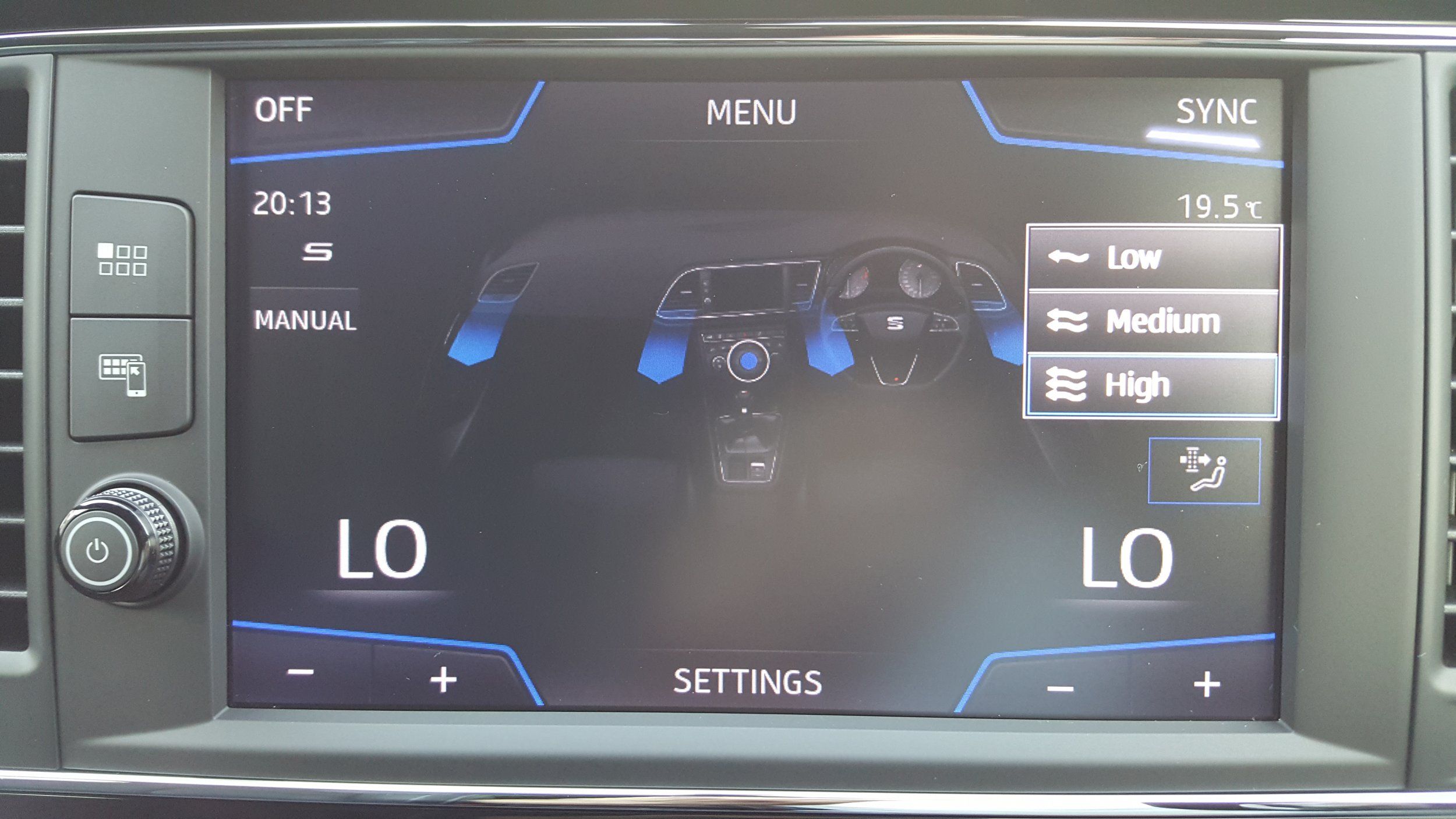

After pressing it, it came up with the following three options....
I changed it from Medium to High.
What does that actually do? Couldnt feel an immediate difference but didnt give it much time to kick in to be fair.
That's just adjusting the fan speed (on the left hand side you can see you have it in manual mode).
You should have a profile button on the dash above the climate controls (on the left next to your hazards switch). In a Cupra it has the flag icon on it, in everything else it has a P on it - should have the start/stop activation button and PDC buttons alongside
This lets you change your driver profile - which sets steering feel, accelerator response, and climate control for some reason. You need to press it and make sure it's not set to Eco, or that the mode your using (like individual) hasn't defaulted to A/C in eco mode.
I appreciate your response but I addressed that Air Con setting in post #4 above. It is not set to Eco.
Additionally, that button I highlighted above does not adjust the fan speed although I admit that I still dont know what it actually does. I toggled it up and down and the fan speed did not change.
Reactions: Cuprabenwytm
As I understood it the low/medium/high setting is how aggressive the automatic mode will be when trying to reach the set temperature, with high being the fan and compressor working as hard/fast as possible to equal the difference between current and requested temps. So this would require automatic to be enabled and something for it to do.
