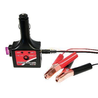

This might be a safer bet? Wonder if this would work?
http://www.ebay.co.uk/itm/Computer-Memory-Saver-Car-Radio-Code-Digital-Clock-/380936692082?pt=LH_DefaultDomain_3&hash=item58b198a172
