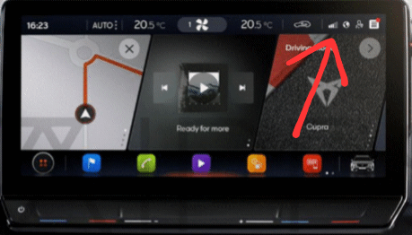

Signal strength should appear in the top right depending on the equipment and software installed.

In my car those bars is for the reception of my cellphone
In the Settings menu, you should find something related to Network and in-there you should have the option to enable/disable the builtin SIM; if I'm not mistaking, in that section you also see the signal-strength of the onboard SIM (not the one of your personal phone). At least that's how it looks on the facelift; in the meantime I forgot how the menu was looking on the pre-facelift version, sorry!

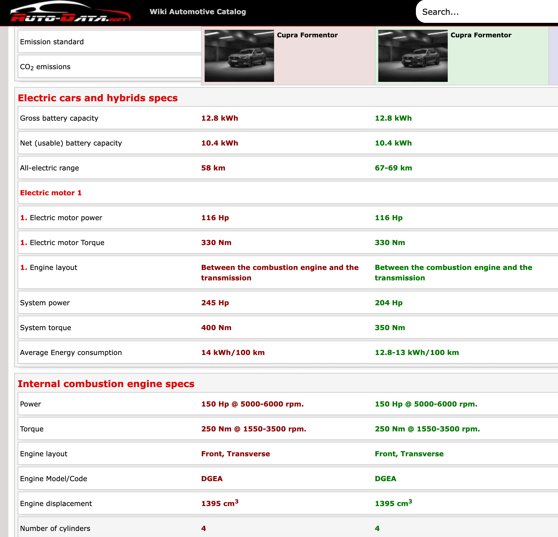

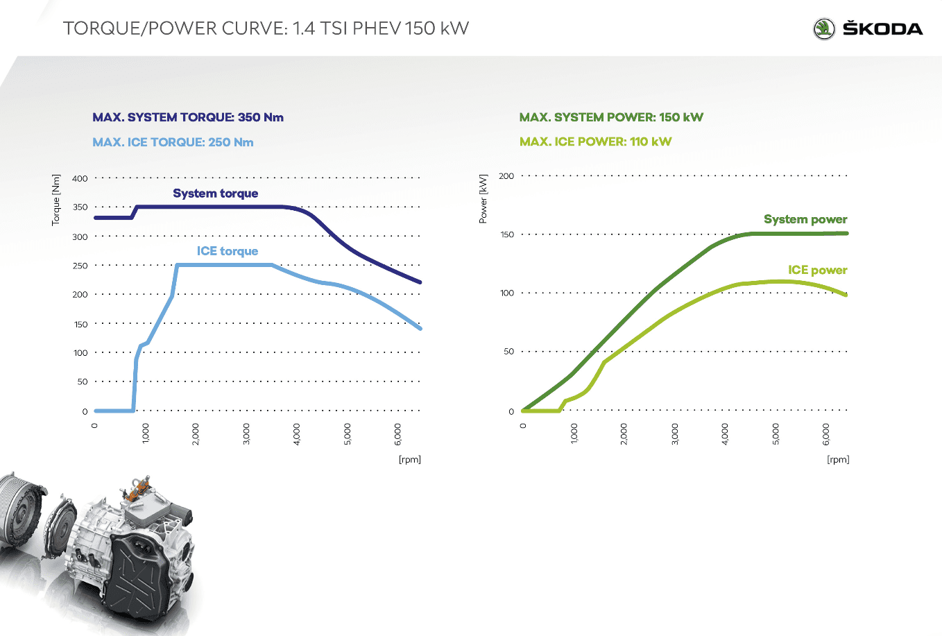

And yes, the hybrid had a strong tendency to loose grip when you start moving (even on clean roads, depending on your "foot weight"). I don't know how other manufacturers manage the standing start, but I think VAG does a terrible job: the starting power is correctly managed, but the starting torque is the same with the high-speed one! The car tries to move using all 330 Nm from 0 km/h :rolleyes:
Try doing it with the 245hp & 400nm of torque! Just spins for fun!
Reactions: Superswede
I know what you mean, but unless you launch the car in a standing start, it will still use the same electric motor with the same specs (power/torque) that is used by the 204hp version. Because most of the mechanical work at start is done by the electric motor, not by the ICE (even when the ICE is ON).

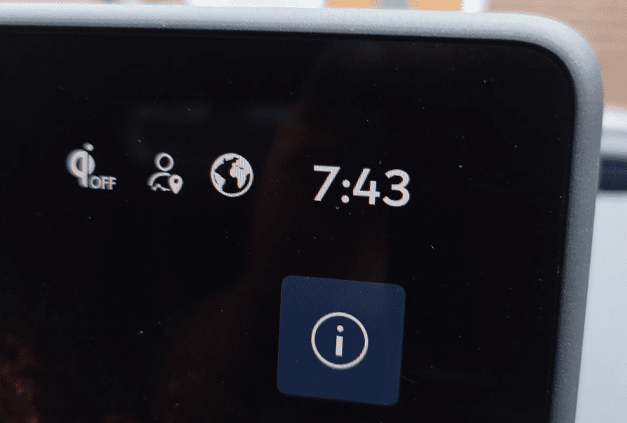

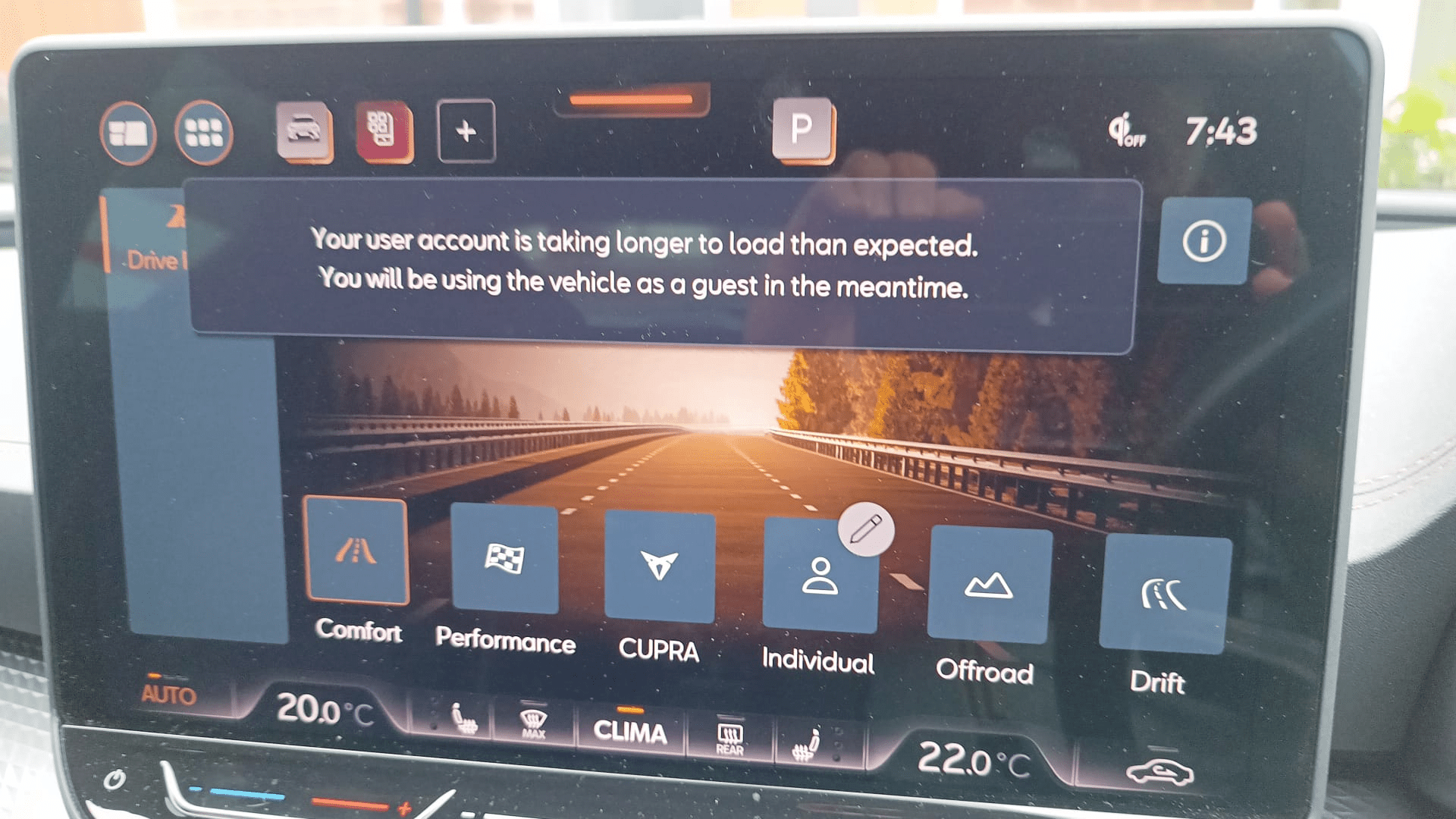

My User Settings also disappeared yesterday. No reason at all - they just wouldn't load.
I started the car this morning and still no personal settings and no 'globe' icon...
...however, as I was sitting there I noticed that the 'globe' icon suddenly appeared (I have no idea what the other icons mean)...
...went back to the car just now (45 mins after my first attempt), in order to follow the process in the first post of this thread and HEY PRESTO - MY USER SETTINGS ARE WORKING AGAIN!!!! WTF?????
Just so you know, my car isn't in a poor signal area - it's in my driveway, where it's been parked for 12 months with no connection issues.
Does anyone have an idea why this blip might have happened? It was very annoying.
There was a complete system outage yesterday for all VWG brands.
The three icons mean:
Qi-off - there's nothing on you're wireless charger
Man with a position marker - your privacy setting is on minimum and your location is being shared
White globe - the vehicle has a data connection
Reactions: trew
