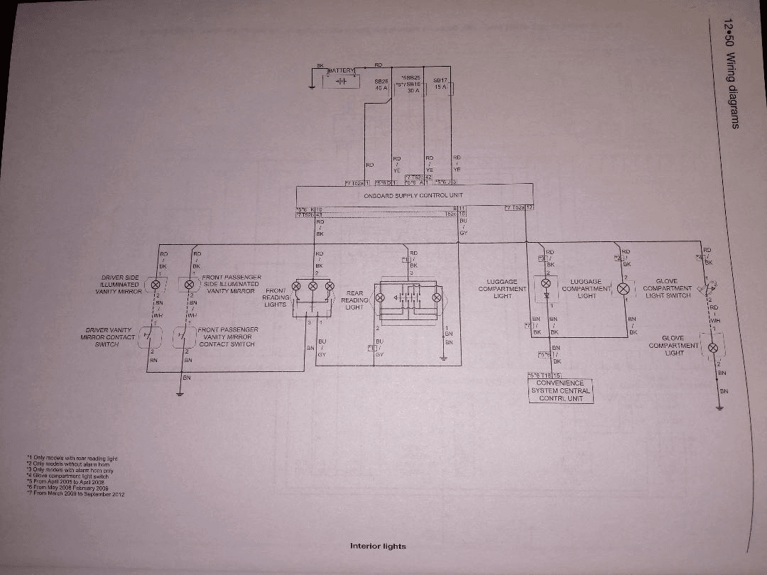

Checked all fuses. All ok. Has anyone a solid fix for this or had experience of it recently. I’m lead to believe it is powered from the BCM or convenience module Ive seen references to online. Had anyone any wiring diagrams or terminal numbers that I can check.

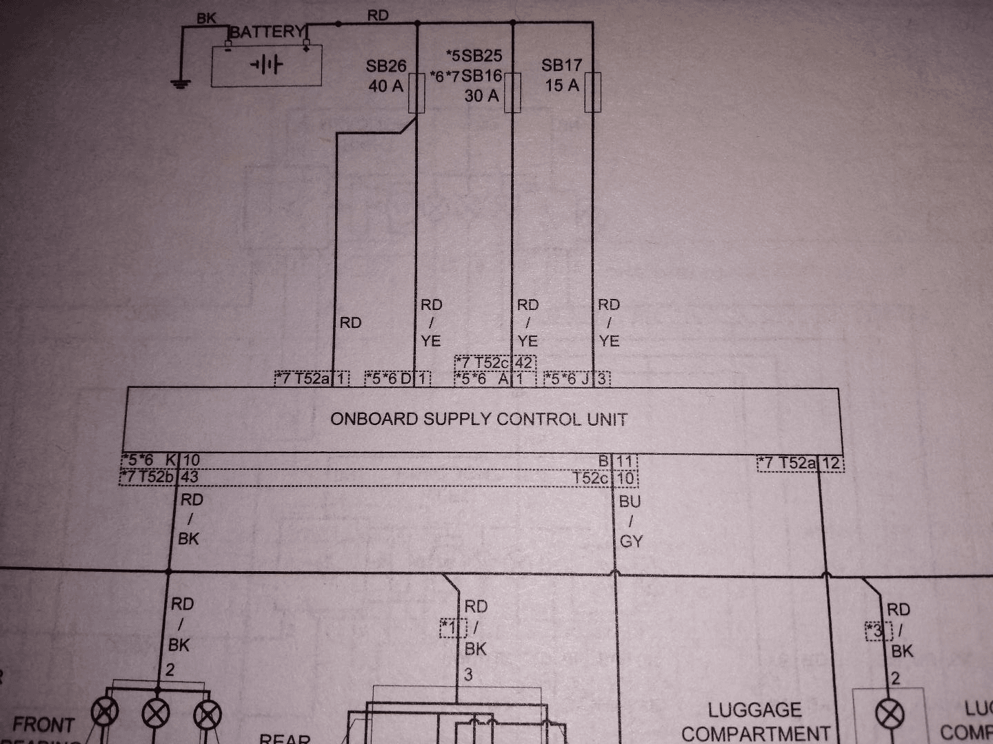

Are you able to take a closer picture of the terminal numbers at the control unit in/out and also the fuses. Thanks, much appreciated sir
