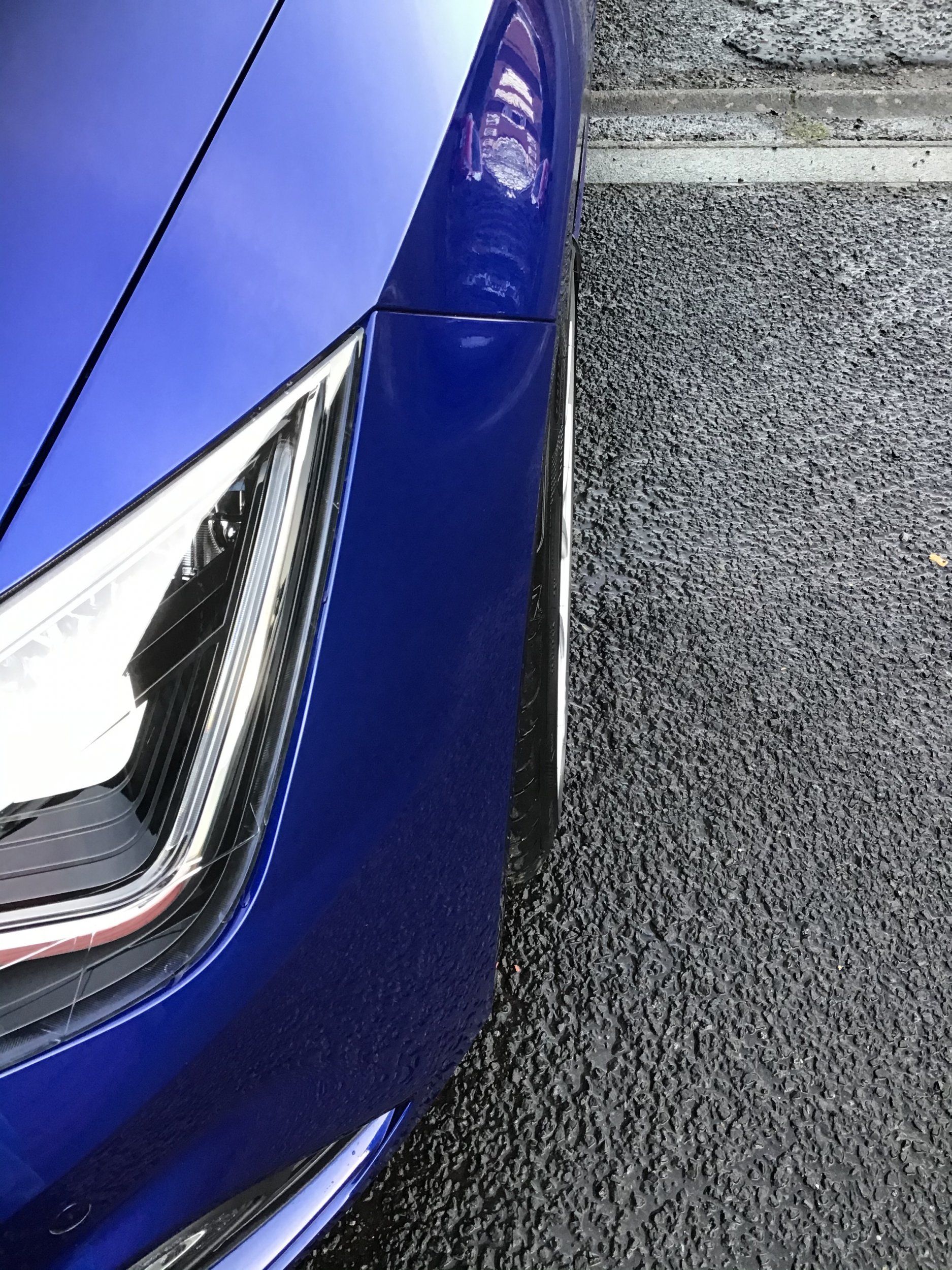

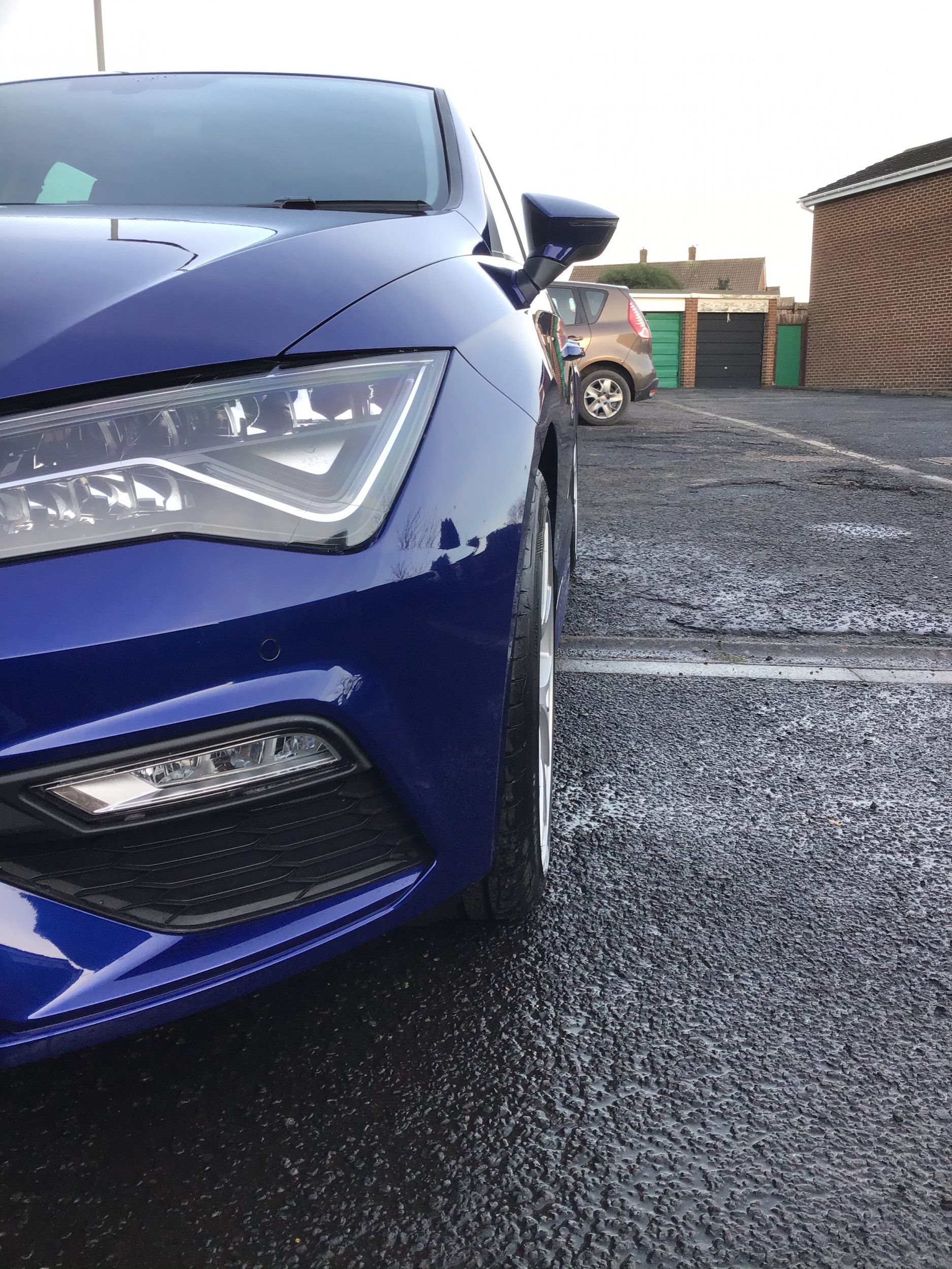

ET40 on an 8" rim would be fine with a 225 tyre without lowering and look about right as well. If you use that website I posted above and use the 235/35R19 19x8.5" ET45 as a limit, you should be fine.
I'm currently running a 19x8 ET40 setup at the front, lowered with 235 Michelin tyres and I only catch the inner arch liner on the biggest of dips/pot holes.

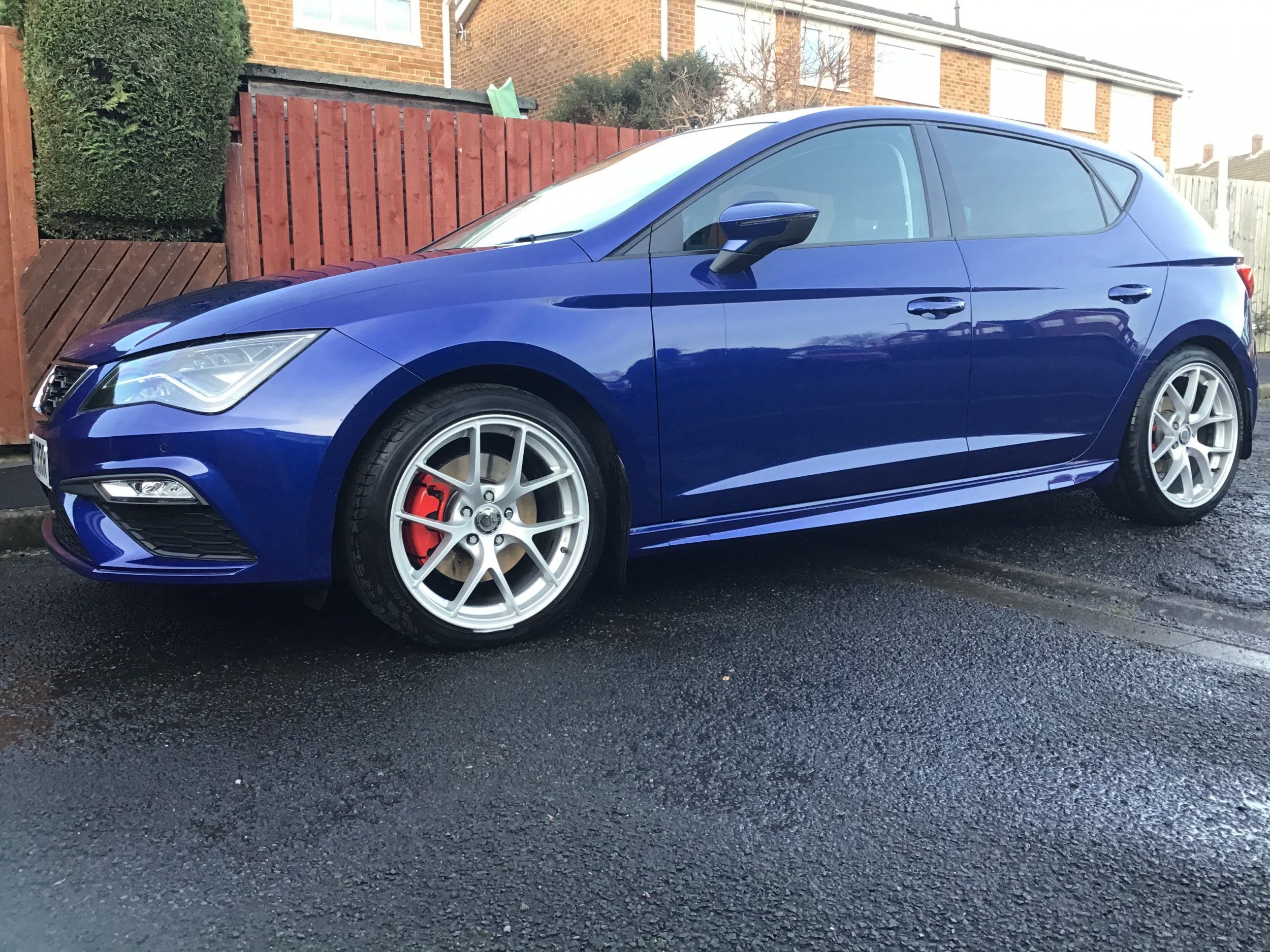

I have 18*8 ET45 with 225/40/r18 tyres on my fr. They fill the arches better than the original wheels with ET51. No rubbing at all, smacked some pretty decent pot holes too :LOL:
Reactions: Deli and OJ9693

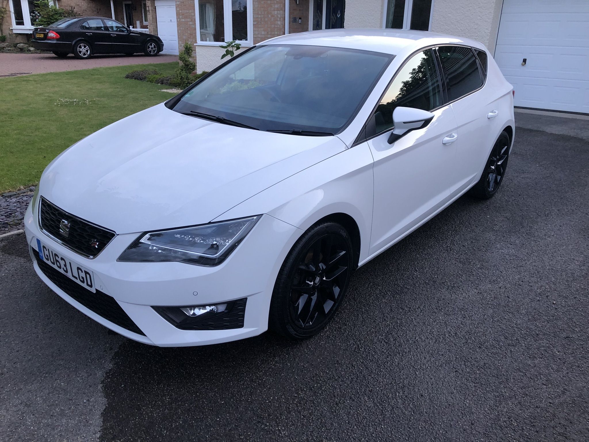

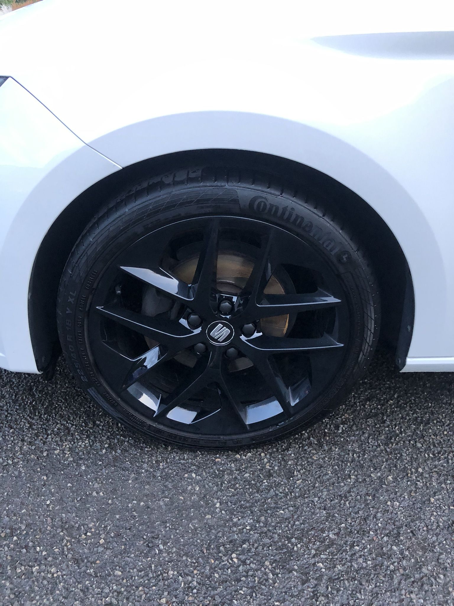

We had 18” Performance OEM alloys on our 150 FR.
I had them powder coated gloss black and sold the car like that. As long as you don’t go too wild on colour (ie gloss black, anthracite etc) they will be ok - I’ve added some pictures so that you can see the difference. I’ve just done the same to my diamond cut Cupra alloys - admittedly, they don’t look as good as when new, but when the lacquer started to peel from the stone chips on 2 of 4 wheels options were limited.
In terms of the ride quality, the suspension on the FR is fairly firm and there wasn’t much difference between 16”/17”/18” when our winter tyres were fitted.
