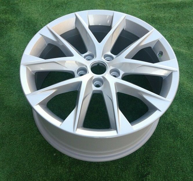

I want to touch up some kerb marks on the edges of three of my alloys and fully repaint another wheel I bought as a spare. I went to an auto paint supplier yesterday but they said there is no standard alloy paint colour and you had to just guess it! That can't be right? Can anyone shed light on this?
These are the wheels in question in silver:
I found a reference on a website to Audi L1H7 Oxygen Silver and it did a decent job on some minor marks on 17" alloys from a 2015 FR. Salesman noted wheels were unmarked when traded in so match can't have been too bad.
The same code also comes up as Le Mans Silver on some suppliers, not sure if that is different shade or not.

I've got three wheels with kerbing on the edges, nothing terrible but want to tidy and seal them up. Another wheel has bad kerbing halfway up the spokes so needs fully repainted. I'm hoping to get it to match the other wheels.

Just an update to this adventure:
I've just touched up kerb marks on three wheels and fully repainted one. The paint I used was L1H7 LE MANS from eBay seller WLW Auto Paints. I used lacquer from the same seller.
The colour match is pretty good. It depends a bit on how much lacquer you put on but I doubt you'll find a better match of the actual colour. What is interesting is that the new paint is a lot more metallic than the original Seat paint. In fact, once you pay attention the origonal wheels don't really look like metalic at all!
If you're painting a set I don't think this is a problem, I think the new paint looks better, but if you're trying to match original wheels or paint part of a wheel it might be an idea to ask the seller to make the paint less metallic if they can.
