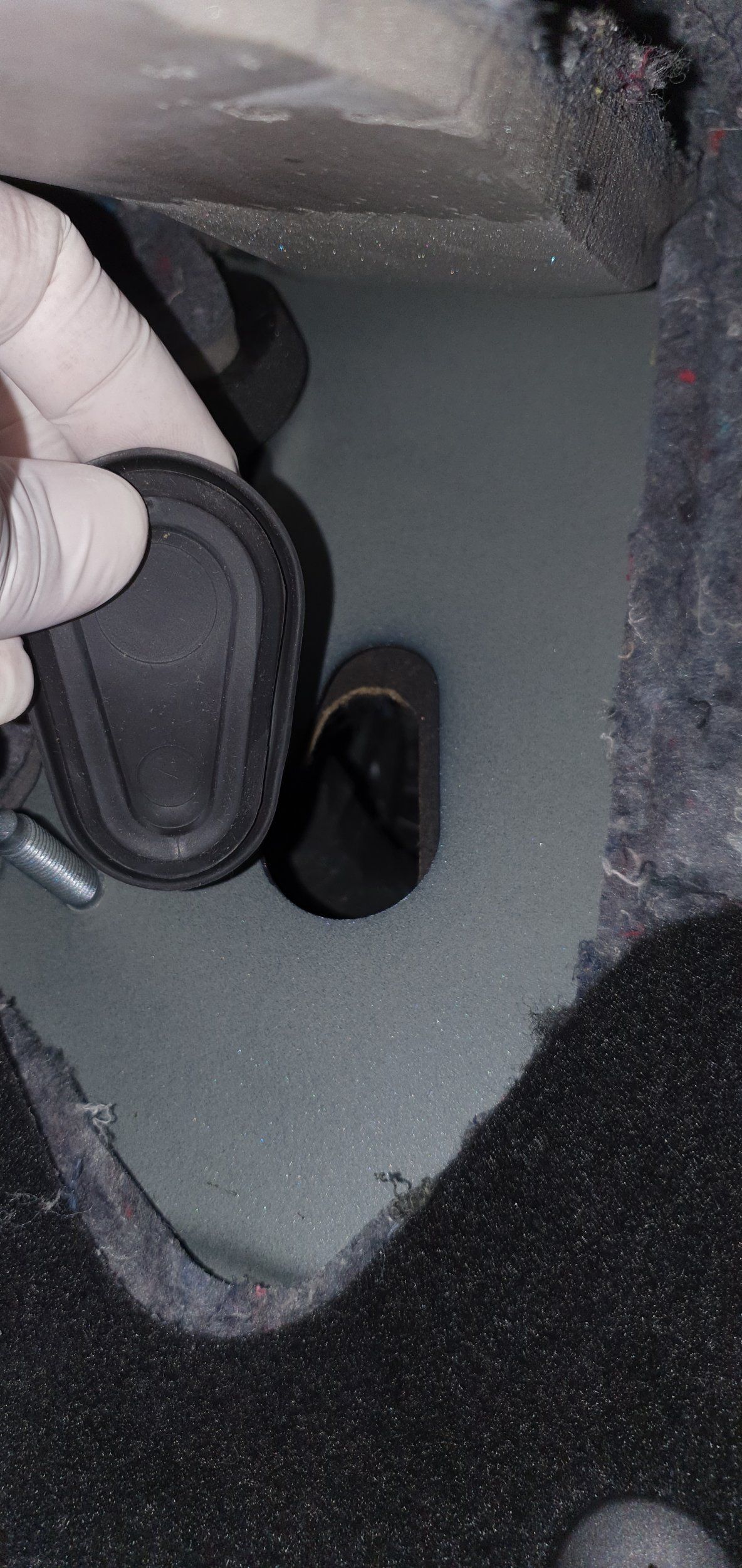

This what you're looking for. The photo is from my LHD car but I guess it's the same with RHD cars as well. Imagine this being behind the clutch pedal of a LHD car.
Coat hanger is the way to go as mentioned above. Battery can stay in place. You don't really have to remove it.
