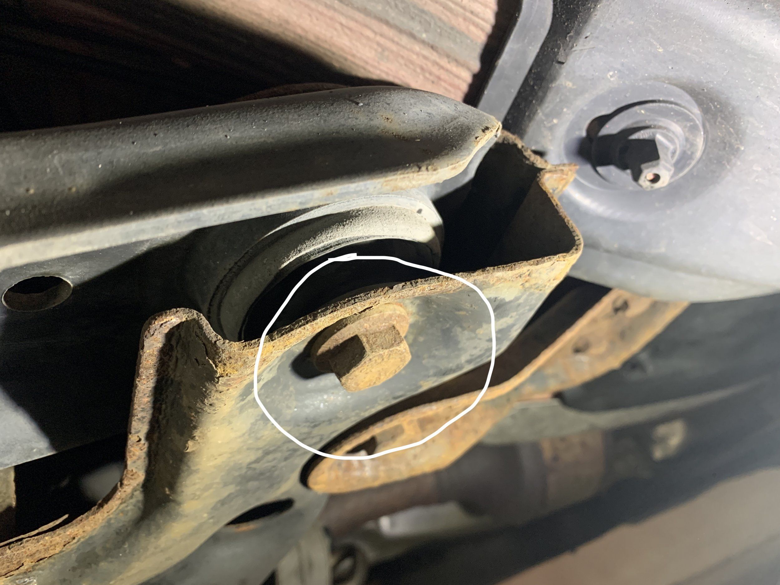

So looking under the car I was thinking about jacking up on the subframe bolt area. Any thoughts on this?

I had a good look at it and it looks fine, though have hit a snag I really should have forseen.
Trying to find a bit to fit the anti roll bar bush bolt. Thought I had one but I dont and no idea where to get one
I've forgotten what size that bolt is, I probably used a wobble joint and an extension to reach them, maybe even used a 3/8" socket set instead of a 1/2" socket set.
its the XZN spline tool. I got a set and they were either too small or too big. I can't be bothered with it anymore so got a mobile mechanic coming to do it for £40.

I thought they would be a worthy addition to be honest but the M8 which I am sure its supposed to be was far too small and M10 was too big and didn't fit. There was a bit of corrosion on the bolt which could have caused the M10 not to fit but there is no room in there and I didn't want to go hammering away in case it really was too big.
So after the cost of the bits(which I have now returned) it was only a tenner more to get a mechanic(who has worked on previous cars of mine) so they can worry about it.

I've just checked up on both 2015 Ibiza and Polo parts listing and both, which I expected, use the same bolt which is described as being "hex flanged M8 X ??mm" - but for you, seeing is believing, I'm only going by what I've found on a 2002 Polo and a 2009 Ibiza, time to check what is on my wife's 2015 Polo then!
There is a hex on the bolt but when my hex socket was on there it started rounding the corners due to corrosion so that way was a non starter for me. On top of the spline not fitting neither way was going to work.
Had the bushes replaced yesterday and car is quiet again, squeaking has completely gone. Happy days :)
