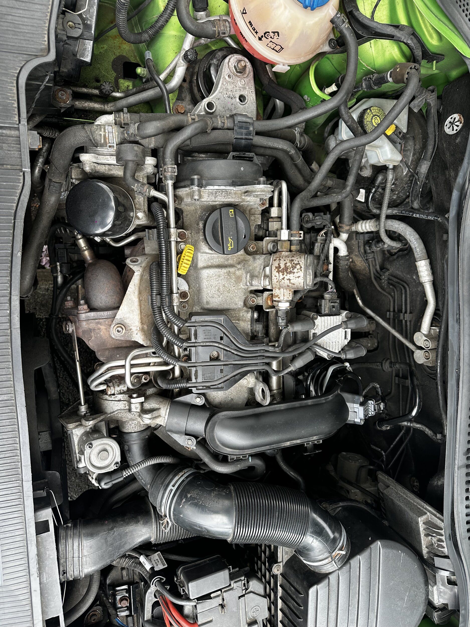

Hi can anyone help for the past couple months I’ve been chasing 2 codes p0068 and p2279 there both to do with air intake and vacuum I have cleaned the throttle body replaced the maf sensor with a new bosh oem one and just recently replaced the pcv return valve (old one was snapped) but the code is still coming up it only flags up when my cars been idling for 20-30 seconds ? Never when I’m driving sometimes happens when I park up after a drive I have the vcds software to hand incase needed for any adaptations I just can’t seem to get it gone I’ve also sprayed carb cleaner around all the hoses and connections but still can’t seem to find the root cause
Thank you
Seat Ibiza 1.2tsi czbz 2015
