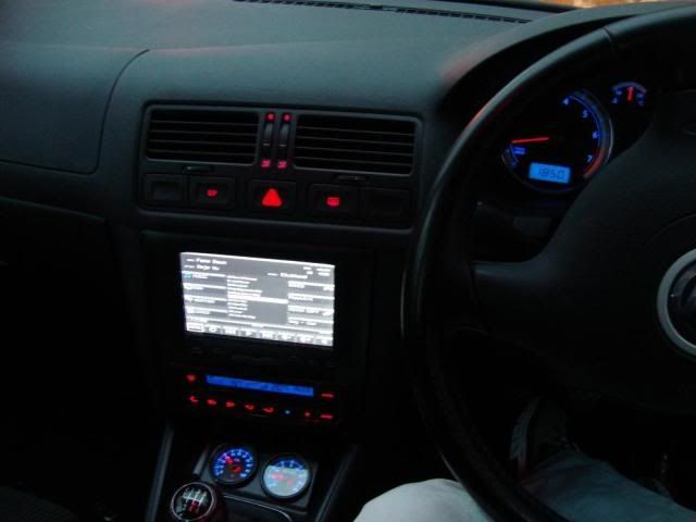

nlited xp sp2, roadrunner, map point, vagcom - a must for any vag owner really.
soon to be stripped out as due to me running a 3.5" it doesnt like alot of the roads so swapping out for a 2.5 as soon as ive some pennies. will also be installing HORM and EBWF to speed the system up a little more.
pics

what it does do is - music - mp3s, cds - normal and mp3, dvds, videos (avi,mpg,mp4 etc), gps, vagcom.
also allows me to run back up camera, pictures, weather, internet.
basically i wanted a decent system that would do music, videos and gps but without spending silly money. i made this for around 300 by picking up some bargins on ebay
if you buy them ready built then they arnt worth the money. i did look at this in the beginning but they were wanting circ £500 for a decent system before screen which most want around £150-200 on top.
the only thing i bought 2nd hand was the screen which i got for £80 inc delivery - guy had actually bought it was a spare for working on in the house so had hardly been used. power supply and motherboard were quite dear at around £50 but that was for a 1.6 twincore in miniiTX format
