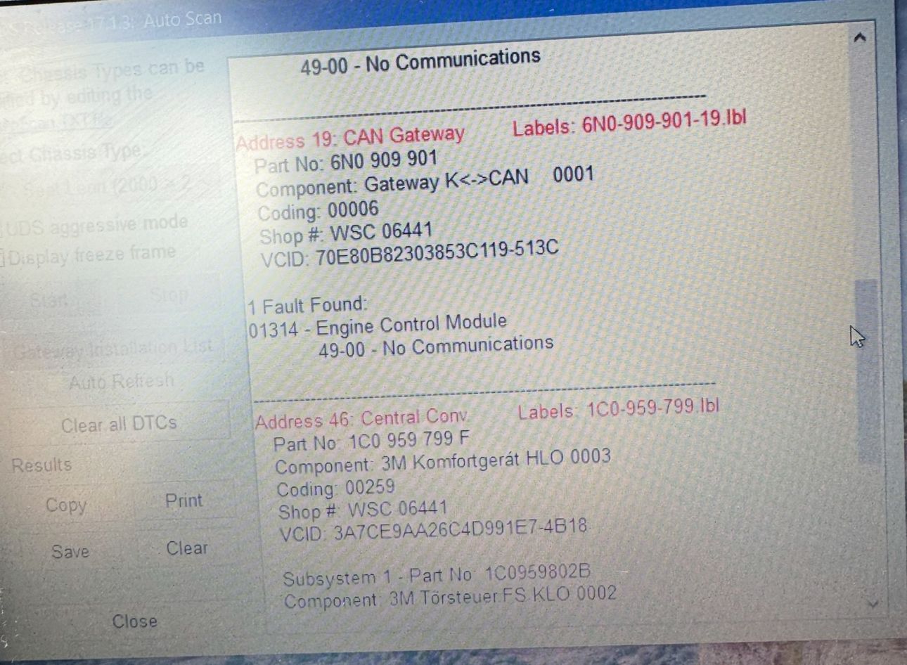

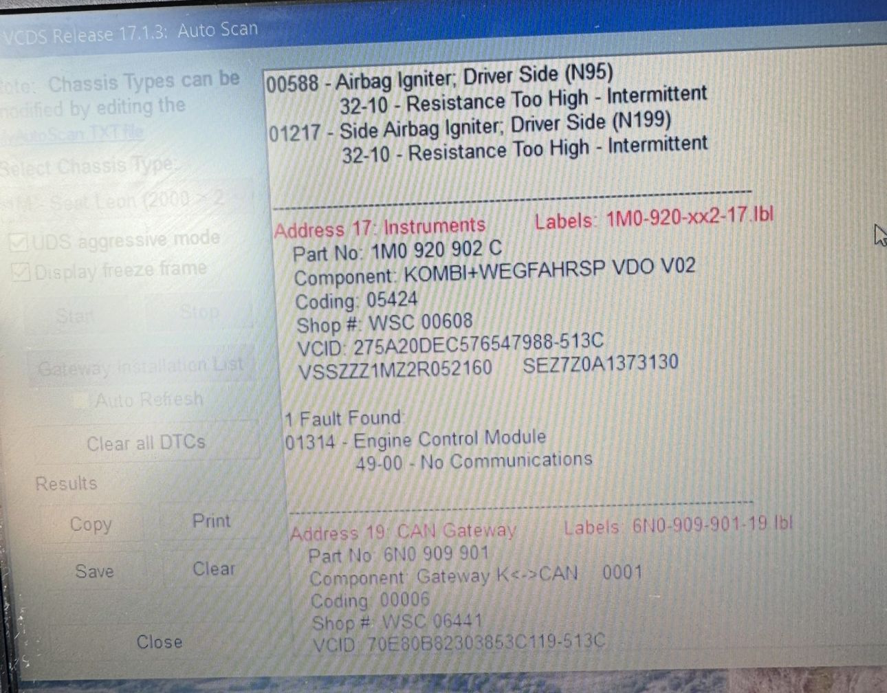

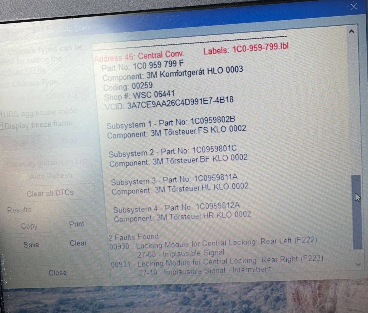

Any fault codes?
I got this code when I scanned it last time (last Thursday.) I haven’t scanned it yet.
“1 Fault Found:
01314 - Engine Control Module
49-00 - No Communications”
what do you think?
I got it under a few modules, as in the screenshots:

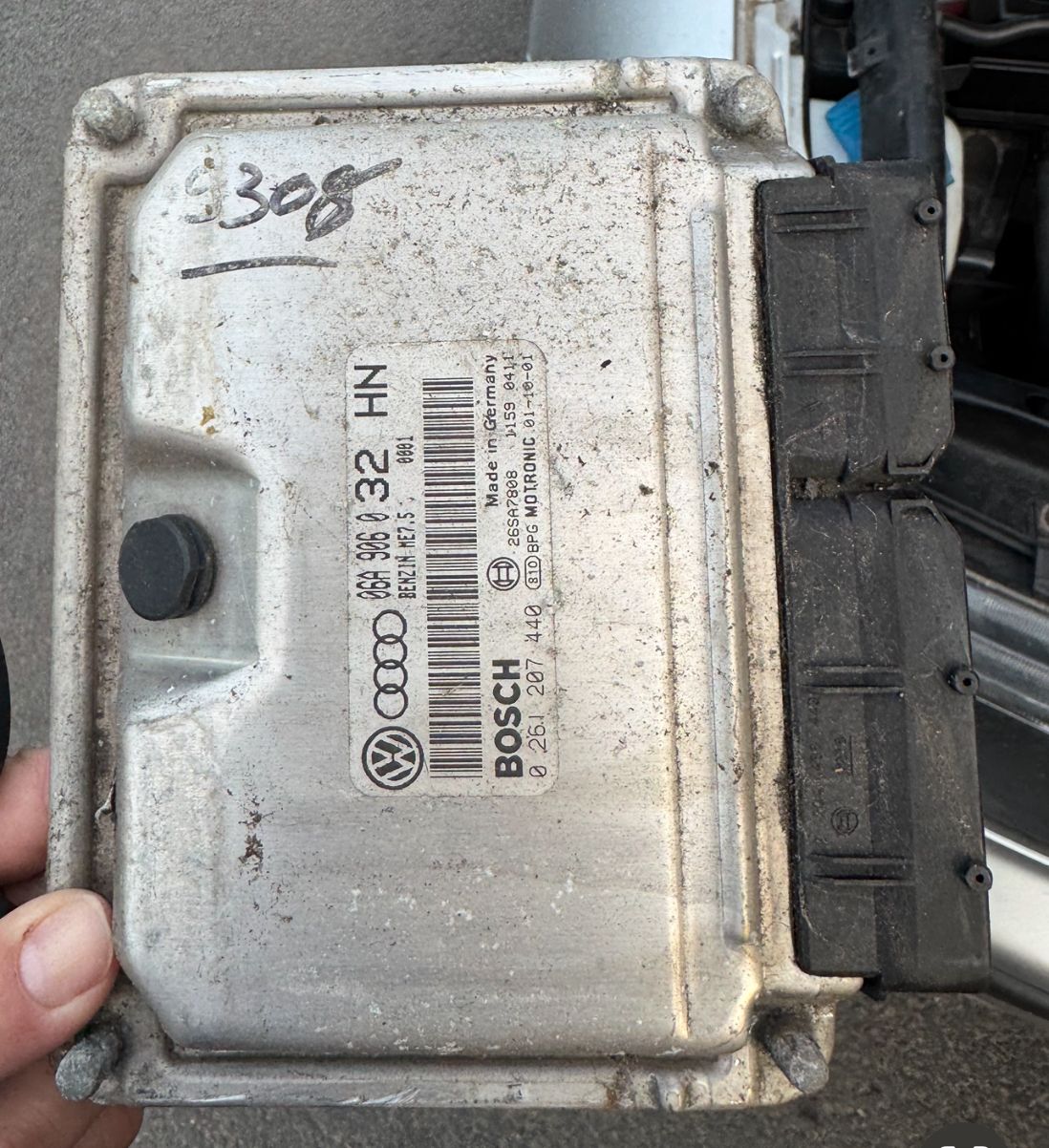

I bought an immo off one after getting the right part number from AUTODOC lol. Cba and just want it to work. Is this a common problem? How would this happen? Just age? The one I needed 06A 906 032 HN
Usually is water ingress leading to rust some conections. I read could also be the ground point that is near it. After you get it out, check for rust or seized connector and try it again before buying new one.
From the factory the cars had a plastic cover over the ECU, most cars lose this over time and if you're unlucky, rain gets in and kills the ECU.

Update: it didn’t work with the new ecu. Same thing with no engine light etc.
This is the photo of the ecu in my car. The connections looked fine tbh etc everything was plugged in correctly/ not loose

And the new ECU was programmed to your car? Or you just swapped and started the engine?
Ohh it was an immo off one as I said. I plugged it in and there was still no engine light/ other sounds so it sounded like it was fully dead/ not even registering the Ecu at all! At this point I’m gonna get it booked in for an auto electrician but it will be a while since they are fully booked till early next month lol. It’s sad but life I guess
But it seems the ECU reads Cluster, Immo and Key. Even with a Immo off, the new ECU won't recognize the deleted immo and the cluster. It will mostly trigger anti-theft mode. But that it is me just wondering in theory.

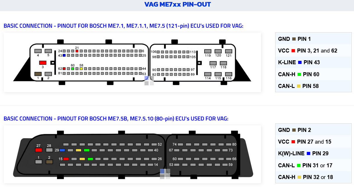

Did you get this sorted? Fault code points to it being a broken wire on the CANBUS wires going to/from the ECU.

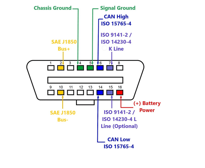

One of those should match the PIN out on the ECU. With the battery disconnected, you should have continuity between the pins in the plugs for your ECU (CAN-H & CAN-L), and pins 6 & 14 on the OBD2 socket by the gearstick.
Note that if you test them, be sure to use fine tip probes to measure them! Don't push large probes into the sockets as you can spread the pins which will cause you even more headaches. IF you find you have a break in one of those wires, the the break is almost certainly going to be somewhere in the harness between the ECU and wherever it joins the main loom.

If canbus looks OK, the check you have power and grounds at the appropriate pins also
