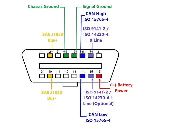

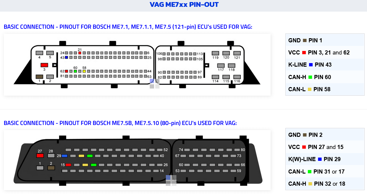

One of those should match the PIN out on the ECU. With the battery disconnected, you should have continuity between the pins in the plugs for your ECU (CAN-H & CAN-L), and pins 6 & 14 on the OBD2 socket by the gearstick.
Note that if you test them, be sure to use fine tip probes to measure them! Don't push large probes into the sockets as you can spread the pins which will cause you even more headaches. IF you find you have a break in one of those wires, the the break is almost certainly going to be somewhere in the harness between the ECU and wherever it joins the main loom.

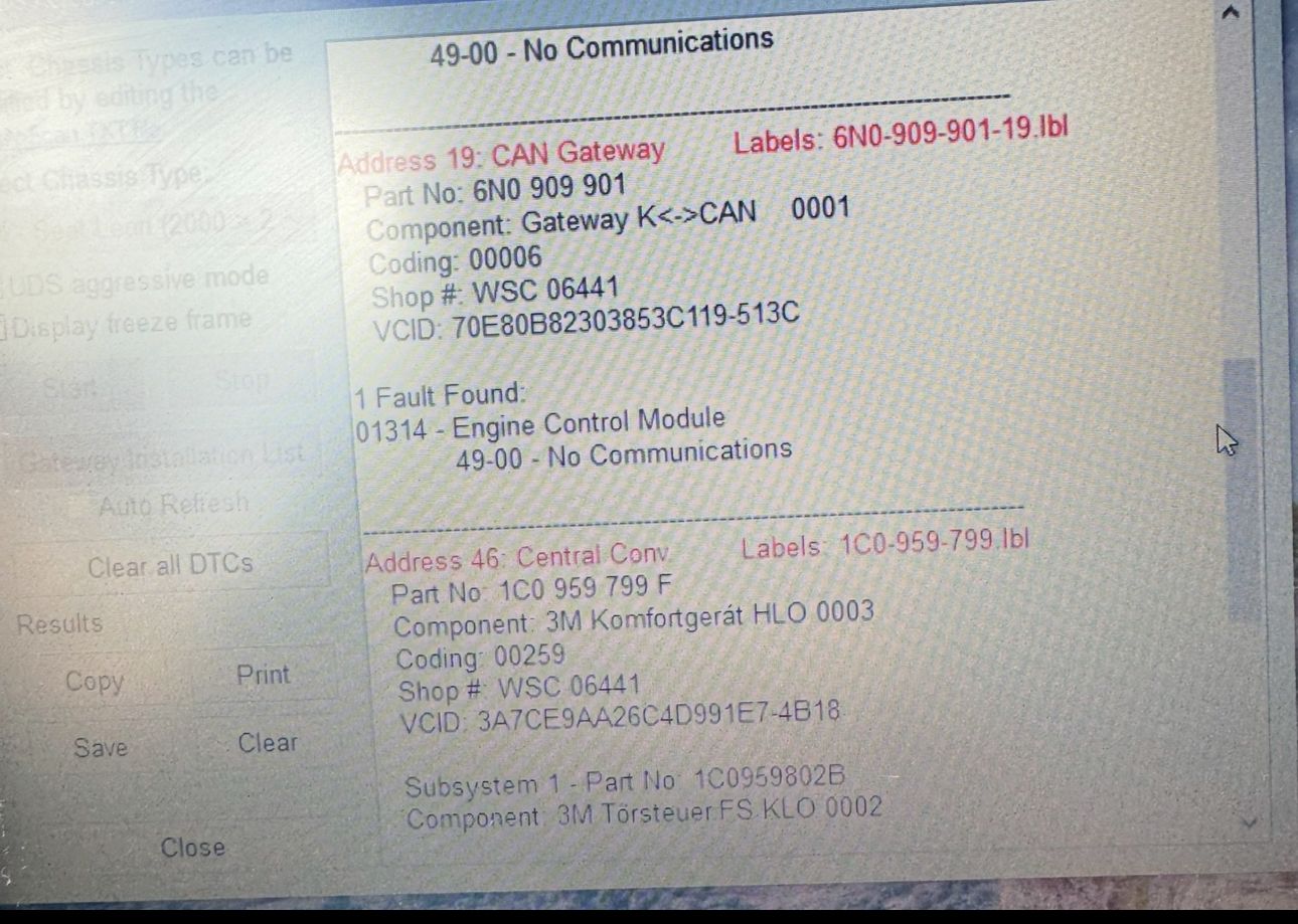

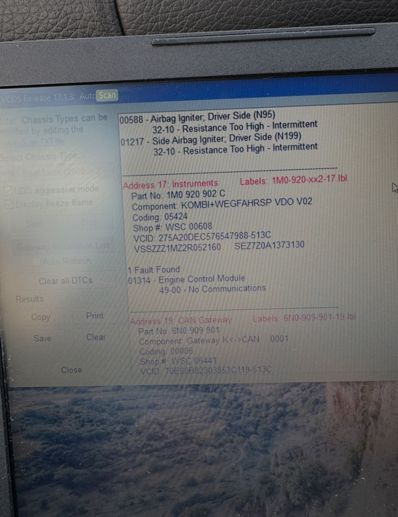

Yeah about 2(?) or so months before this happened the airbag light came on for the drivers side and when I went to try and fix it with a resistor I had no joy. I did notice when I scanned it at that point while doing the airbag light many modules were not being recognised when scanning like the engine control module where on vcds it would say no communications etc. I guess slowly dying(?) also when I did try out the new ecu and took out the old one, tbh it looked clean/ nothing major etc.

Looks like the gateway itself is fine. It's online and communicating, it just can't speak with the ECU. The wire is likely broken/corroded somewhere between the 2 modules. Either that or ECU is offline due to no power/ground, but my first guess would be the CAN lines. No way of really telling without measuring.
Nah this was before, about two weeks before it died. Look at the report the aa said about my car. It doesn’t connect at all now afaik. When the recovery man came to try and fix it he had no connection. Tbh I haven’t tried it since and just waiting for the auto electrician to come out
Looks like the gateway itself is fine. It's online and communicating, it just can't speak with the ECU. The wire is likely broken/corroded somewhere between the 2 modules. Either that or ECU is offline due to no power/ground, but my first guess would be the can lines. No way of really telling without measuring.
Iirc it was like that for many modules later on I’ll post the whole scan
