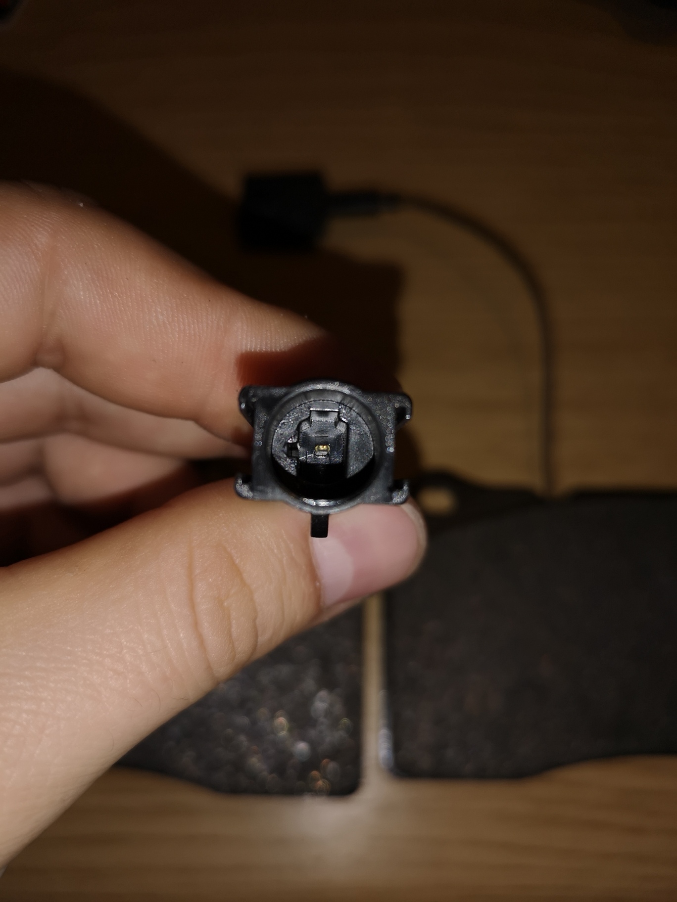

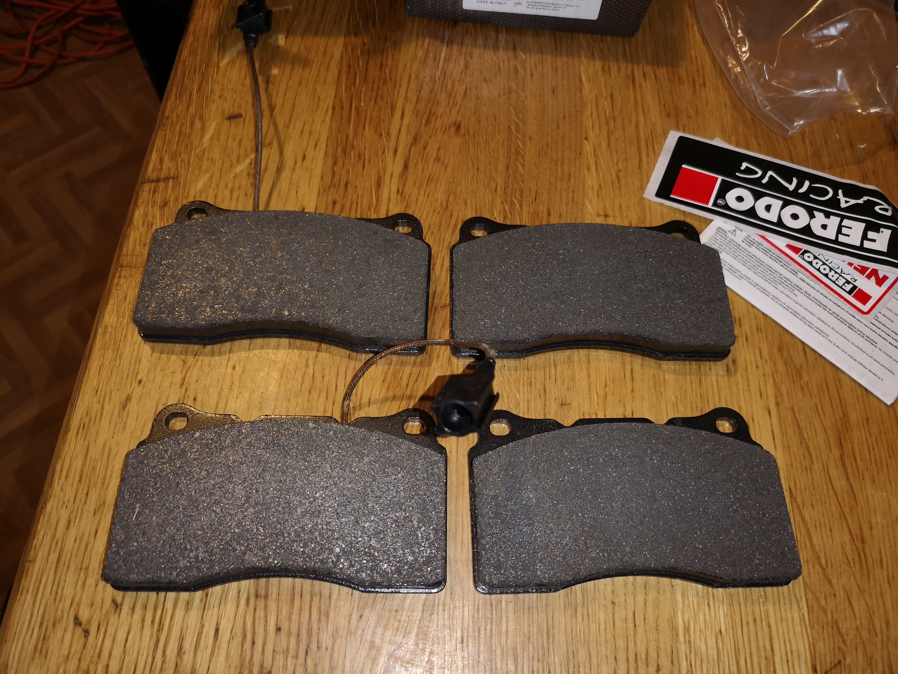

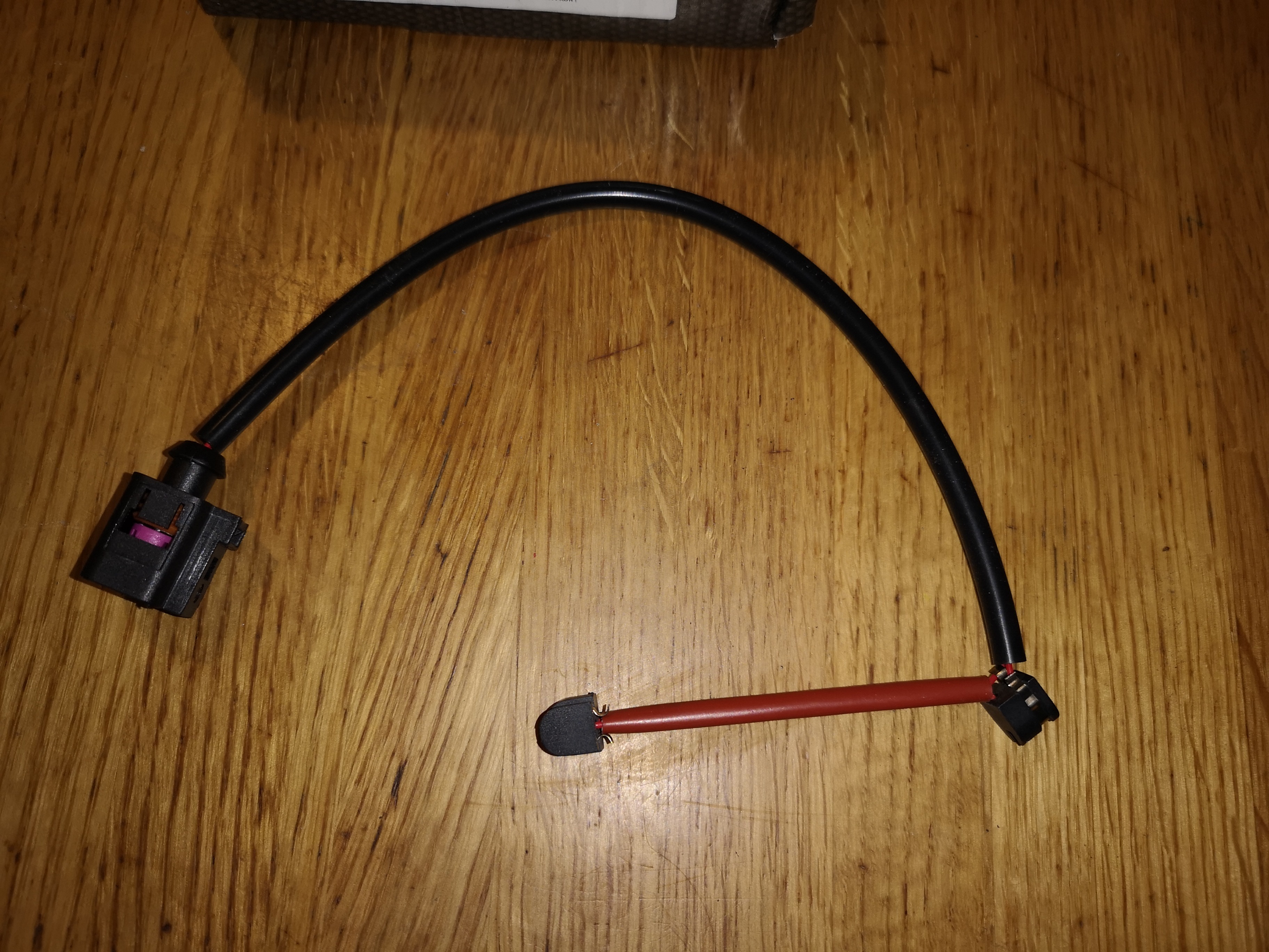

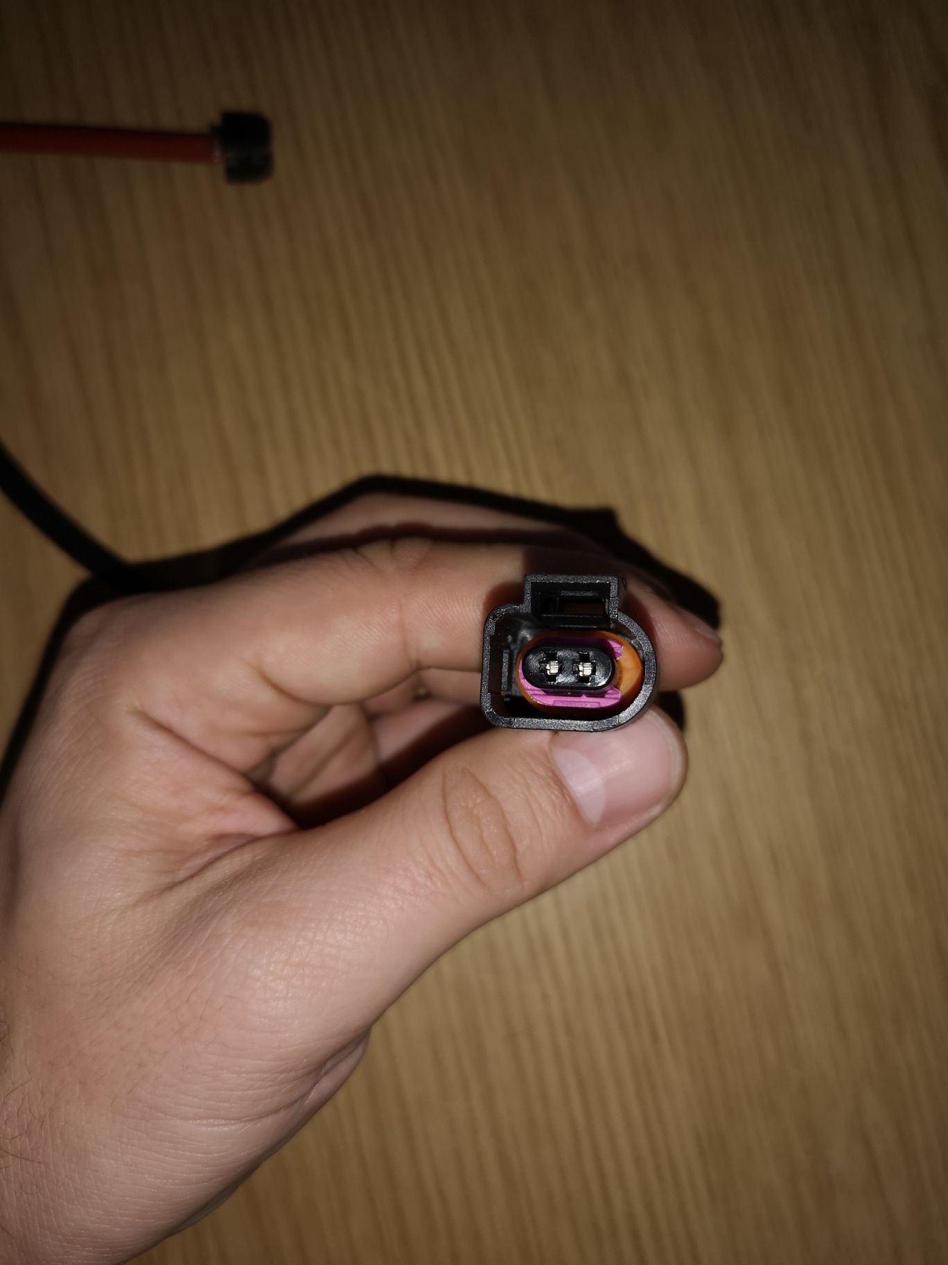

Today Im receive FDS1334 pads and looks like they are not compatible for Cupra...
If you check my pictures on second picture is new OEM sensor which have only one connector and two wear "pads" first for one brake pad and second for another brake pad. On first picture you can see new brake pads and two of them have cables with connectors.
Looks like I will need return them and go for some another brake pads...

just cut the connector you don't need both sides

As Im write they are not compatible. There is no way to connect sensor from one or two brake pads to original plug. Brake pad have one wire but OEM connector need two wires. Probably another "wire"/contact go by calipers but VAG do not work that way... If you don't need sensors they are ok because you can cut both wires, make bridge plug from original brake pads sensor connector and use them without sensor otherwise you cant use them... I will return them and buy another brand...

to be honest there is nothing wrong with the pads they fit the calipers perfectly the pad warning light can be made to work with the OEM wiring or just plug the wire in and don’t attach to the pads and visually check them every 6months
They are motorsport derived brake pads so they aren’t going to make the warning sensor fit every model of vehicle fitted with brembo calipers
It really isn’t a issue the pads fit the application they are made for just the sensor that needs modified and my own case I didn’t bother with the sensor at all and will just keep an eye on pad wear (and I keep the original OEM pads in the box in the boot of the car as it’s a 15mins the swap them back if needs be)

Yes they probably fit to calipers but Im not talk about mechanical fitment... They are Street pads, R90 Homologated and car need to be street legal there is no way to use this pads on Cupra or TTRS. Probably connector and wiring fit some other brand(Alfa, Lancia, Subaru, Renault...) but not VAG cars. VAG cars normaly have 2 wire sensor connection but FDS1334 have only onw wire. Probably there is way to use them and rewire sensor by soldering another wire to steel on back or side but I think this will not last long enought...
People who will not connect wear sensor will probably for very small difference in price go for DS2500 pads but others which look for replacement for OEM brake pads which are preoblematic(To much steel inside and warping discs) can't go with FDS1334! I don't know why ferodo didn't make place where we can plug original wear sensor...
Im alredy decided to return them and go with some other ones(Probably Tarox Strada) which are designed to use with wear sensor...

Problem is that you write wrong information on forum on another thread where I explicit ask for pads WITH wear sensor for Cupra and yes they have them but not useable for VAG group. Wire which go from pads have only one wire and one pin and VAG's have 2 wires and 2 pins. In one of my previous post Im upload picture of VAG connector. And here is connector which came with that pads(only one wire/pin).
I just want to warn other users which would like keep wear warning and not every few months look pads that go away from that pads...

It’s work for VAG you have to adapt it takes 5mins I knew before buying the Ferodo pads they don’t do a VAG connector
