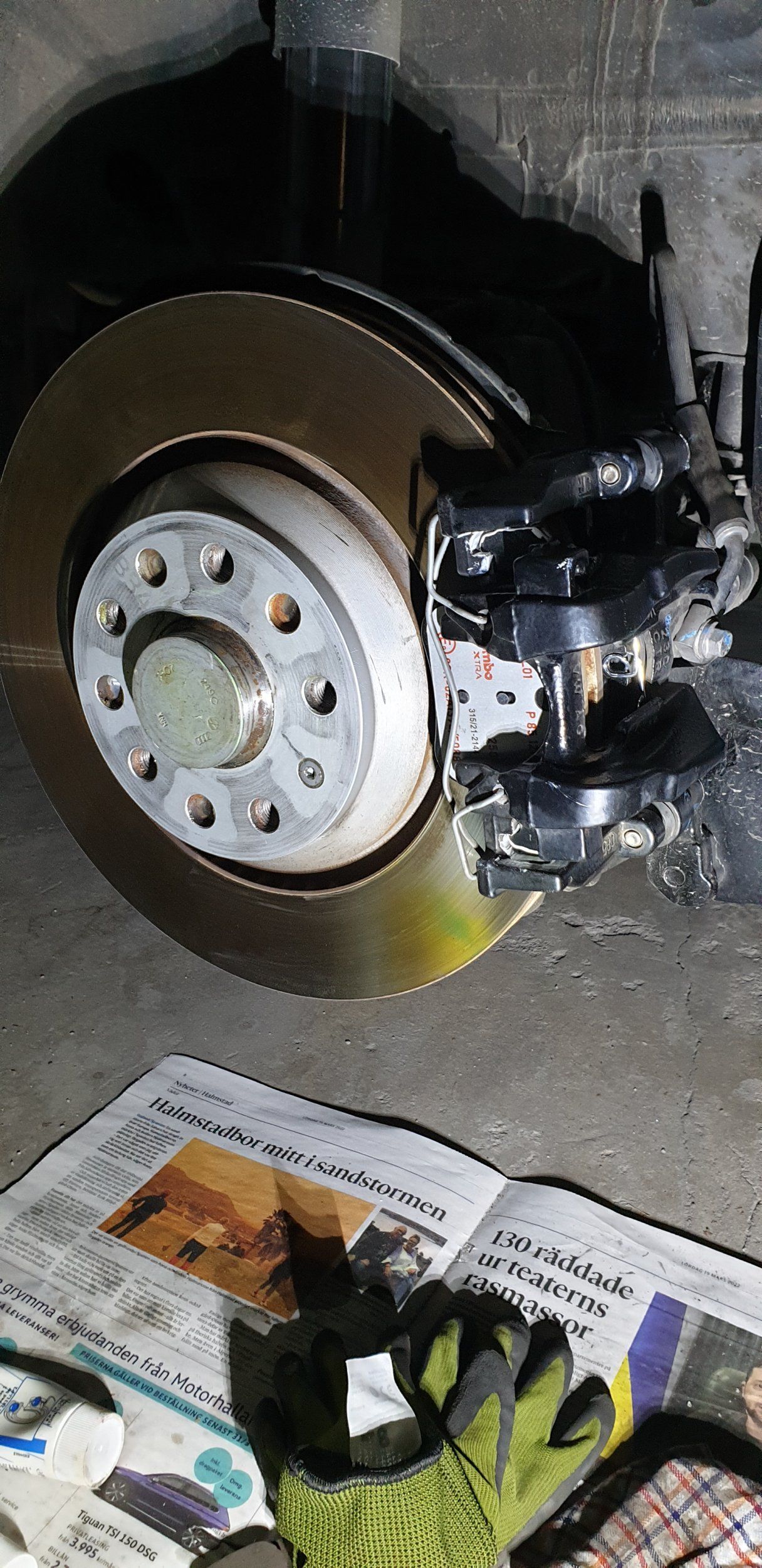

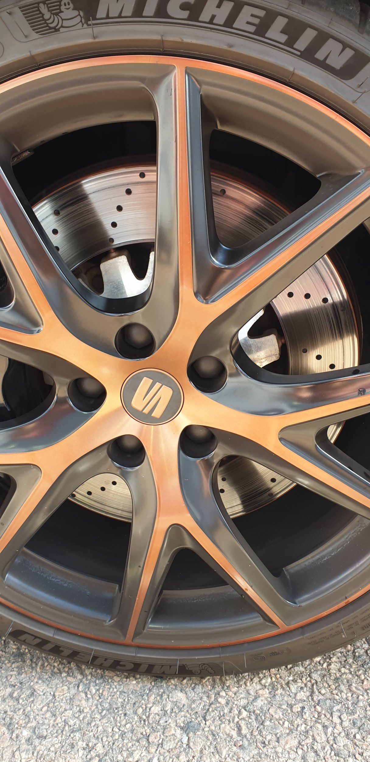

I used the Brembo ones:
P85 159 Front with squeal shims. See pic for the half moon cut out on the anti noice shims
P85 124X Rear, (XTRA)
I have just driven the car for 50 miles (75 km) on ordinary roads, Very good braking force so far. On track I can’t tell yet.

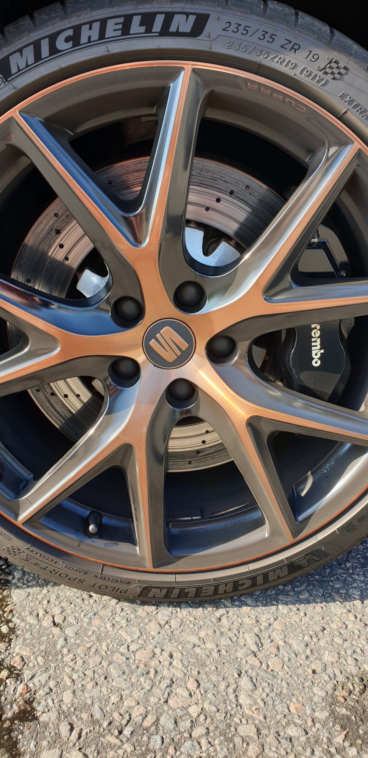

Left (sitting in the car) front disc. Looked good on both sides.

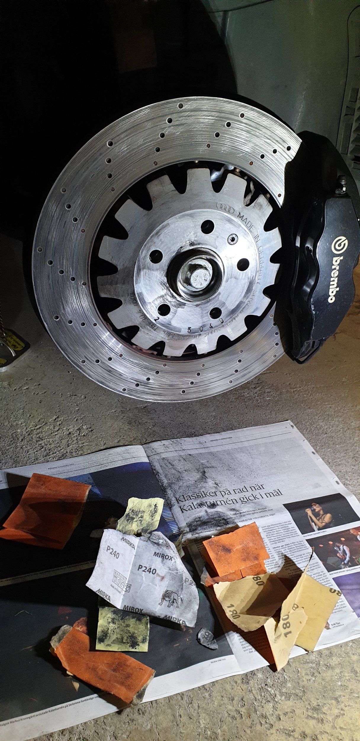

Right front disc. Wheel side had some brake pad residuals burned in to the disc. The inside looked good. No big deal. As I mentioned, a very hot day! Have experienced this before also on my former Golf 7 R under similar conditions. Normally I would just drive the car and let normal wear erase the residuals on the disc. But not this time....
Next day I decided to remove it with a sandpaper by hand. Best result was with Mirka grit 240. The “no name” grit 180 were not good at all.
The reason for sanding right disc was that I felt some minor vibrations during soft braking on my way home from track. It went away after sanding!
Summary - I am satisfied with the pads! Could buy them again.

Interesting feedback.
Being a counter clockwise circuit - you would expect more heat in the right hand brake if you are braking in the bend due to more load on the outside tyre.
That heavy friction material transfer on the right hand disc is not good and a sign you have exceeded the friction material 'comfortable' working temperature. Basically the friction material has given up and unevenly depositing itself on the disc - which is the judder you felt.
Personally I would pick a different front pad friction if you are planning to do track days again.

@SuperV8 - Yes. I believe you are right in your conclusion.
I was a bit confused about why the inner surface of the right hand disc looked okay but the outer had some pad deposits. I will check them again after next track visit (don’t know when). Hopefully not so hot outside temp, up to 30 C (86 F), perhaps then go for something else.
We all know that the OE discs are identic left/right same item no, not directional. Cooling could work different on left/right side. In any case to hot for the pad on right hand disc.

Your RS3 brake cooling ducts will be acting mainly on the inside friction face.
You are also right on the direction veins, not being handed.
The Veins on the OEM disc below pointing to the right - mean they would be optimised for the LH side - but working backwards /inefficiently on the RH side.

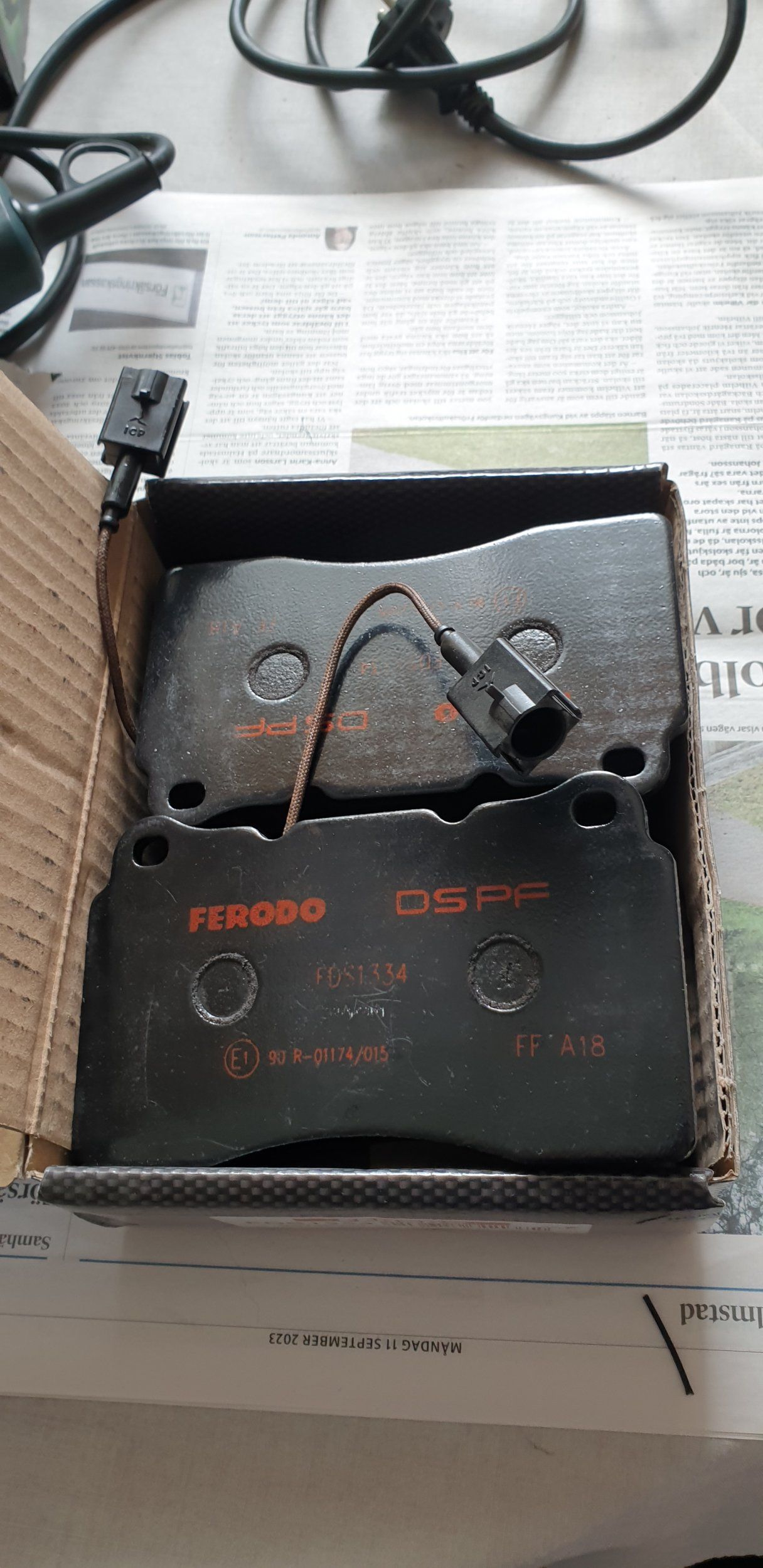

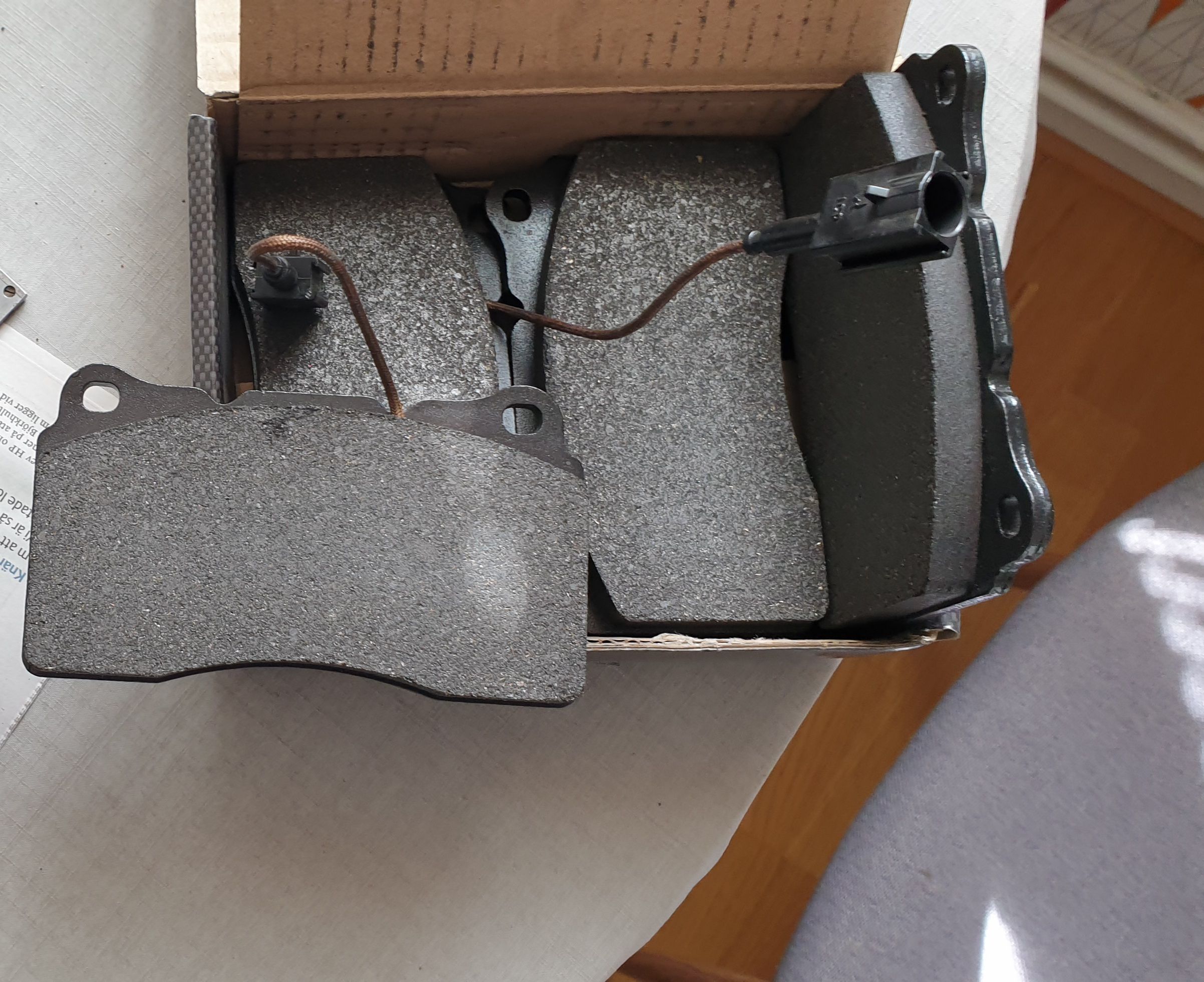

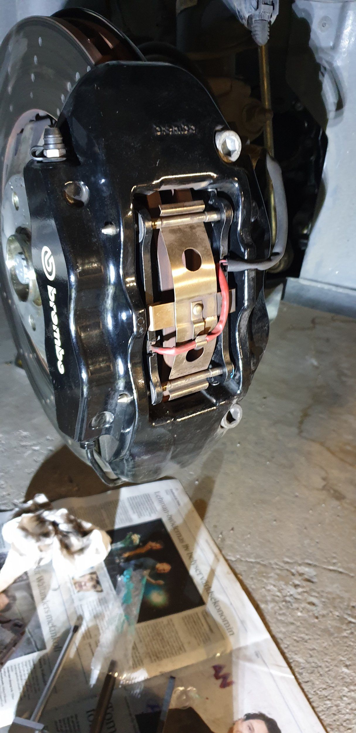

Now I have changed front brake pads to Ferodo DS2500, FDS1334 street/track. I suppose this will be a better solution. The old (Brembo P85159) got worse :).

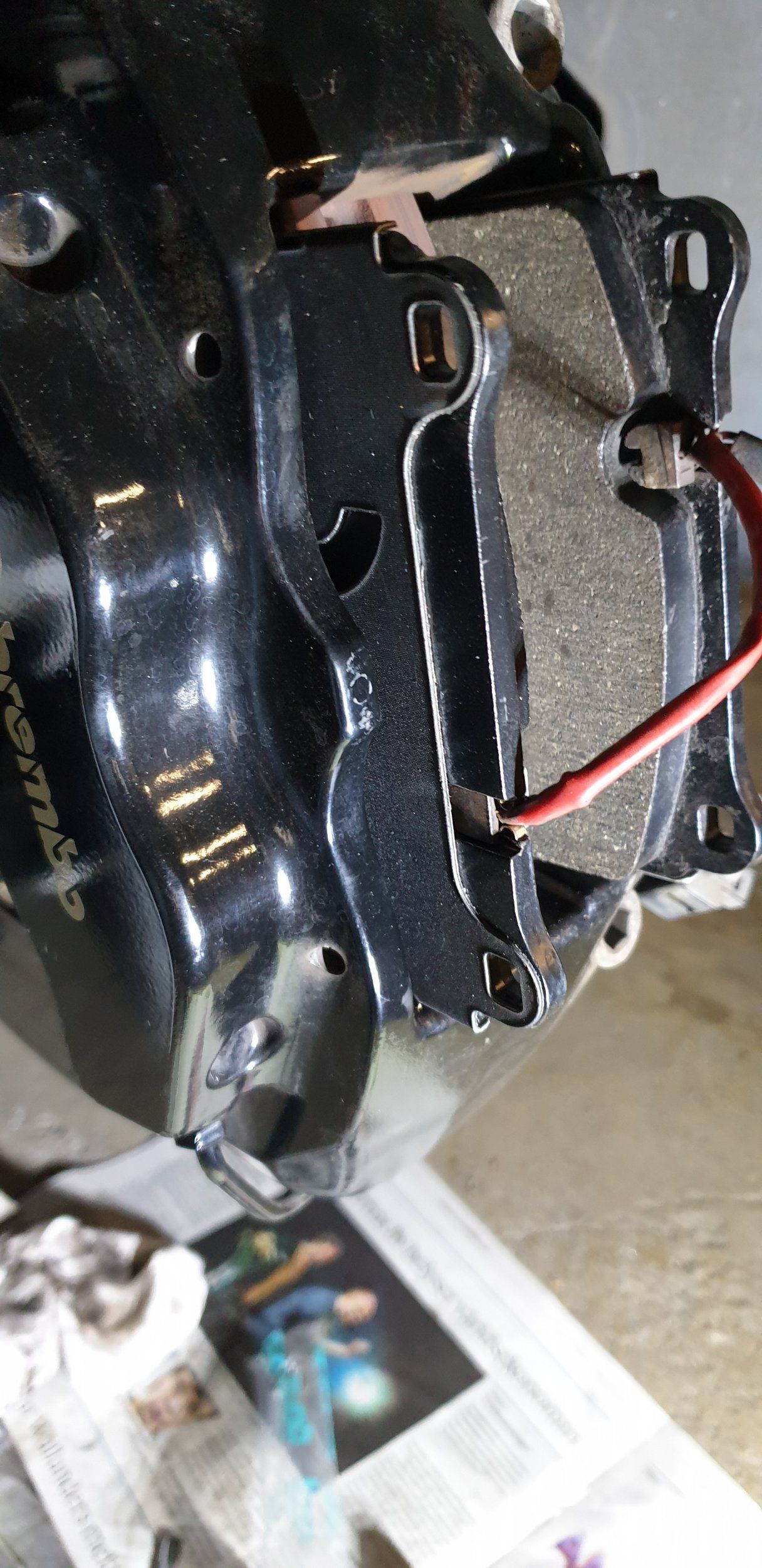

The cable is just one singel cable, I have cut it off. VAG always work with two cables, so I solered a jumper cable plus heat shrink tube to the connector.
