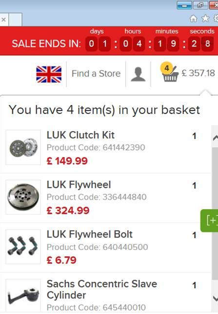

ECP have a flash sale. Are these all the parts I need for the job and will the sachs slave release bearing work with the LUK clutch kit as they dont list an LUK part and I dont think you get it in with the LUK clutch kit at the top of the list? I think this is a really good price for the parts whilst sale is on...??
Is this all I need and the Sachs will work with the LUK kit?
This kit is OEM equivalent right so should be pretty decent?
That looks like all you need
I've got the same LUK DMF/bolts fitted with Helix clutch and no issues
