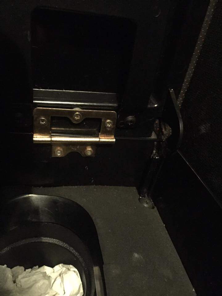

I bought the hinge kit (think it was from Darkside) and worked a treat plus much stronger than original hinges

That picture looks like a completely different armrest to the one i have in my mk2 leon, i bought mine with the hinges broken, ive.tried using some sikaflex to bond the hinges back together but it takes ages to dry and its difficult to hold for so long. The Ebay kits ive seen are all for the mk4 golf armrest which is what bruceR's looks like. Going to try a fix on the weekend will keep you posted

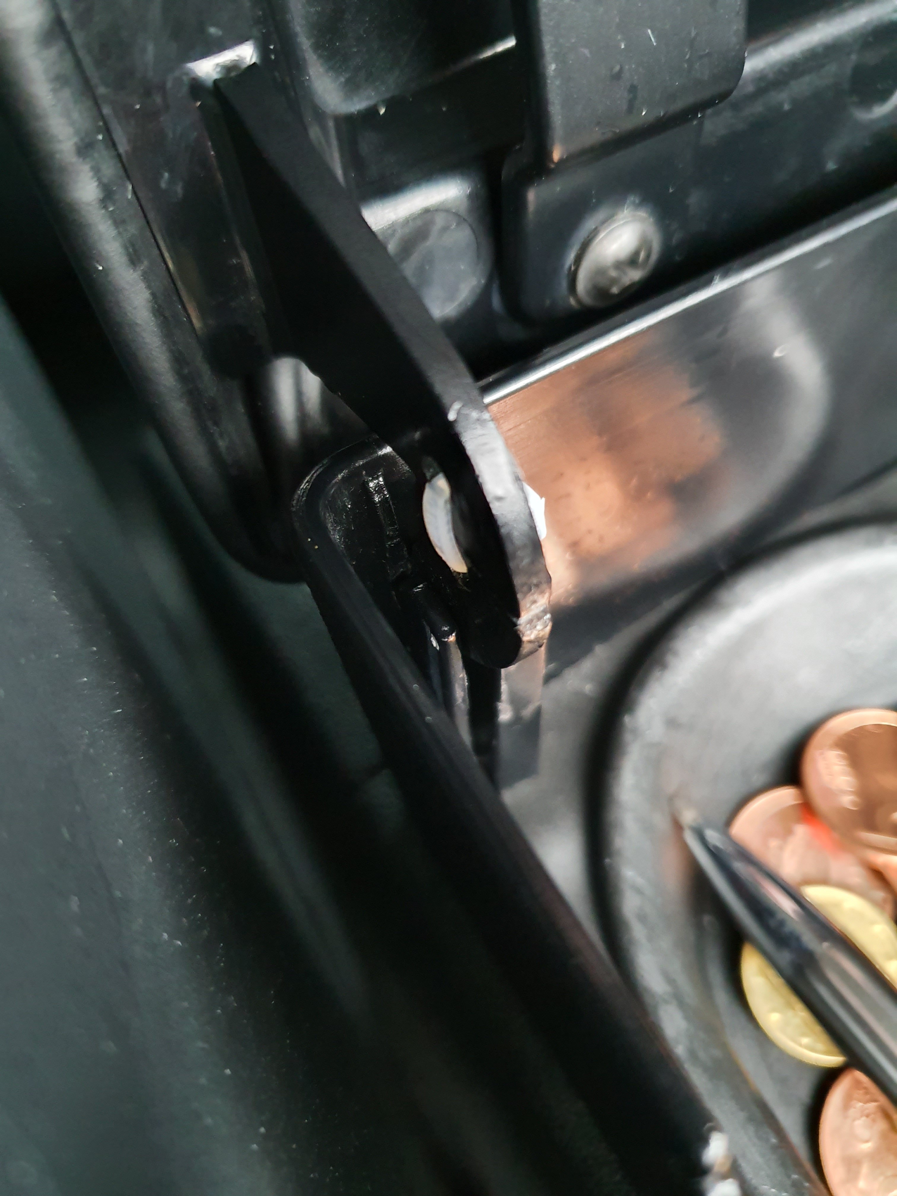

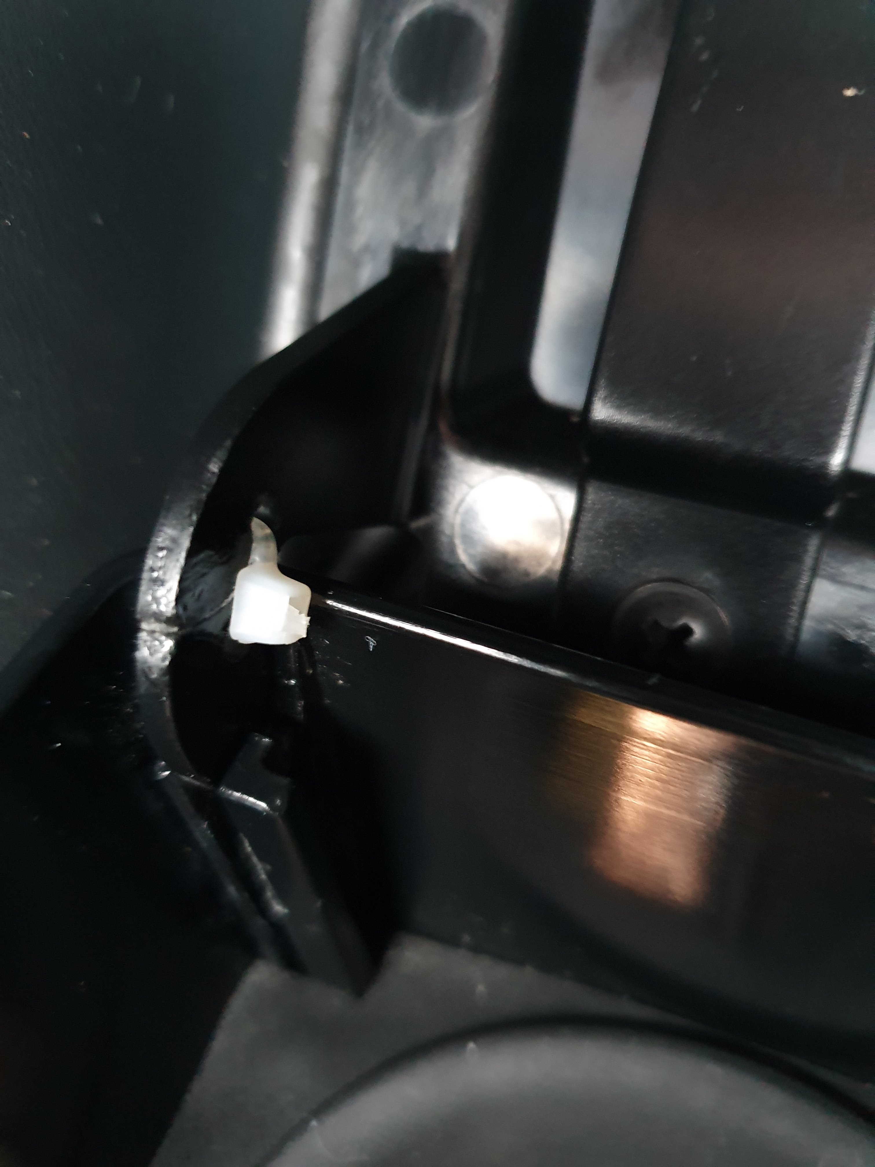

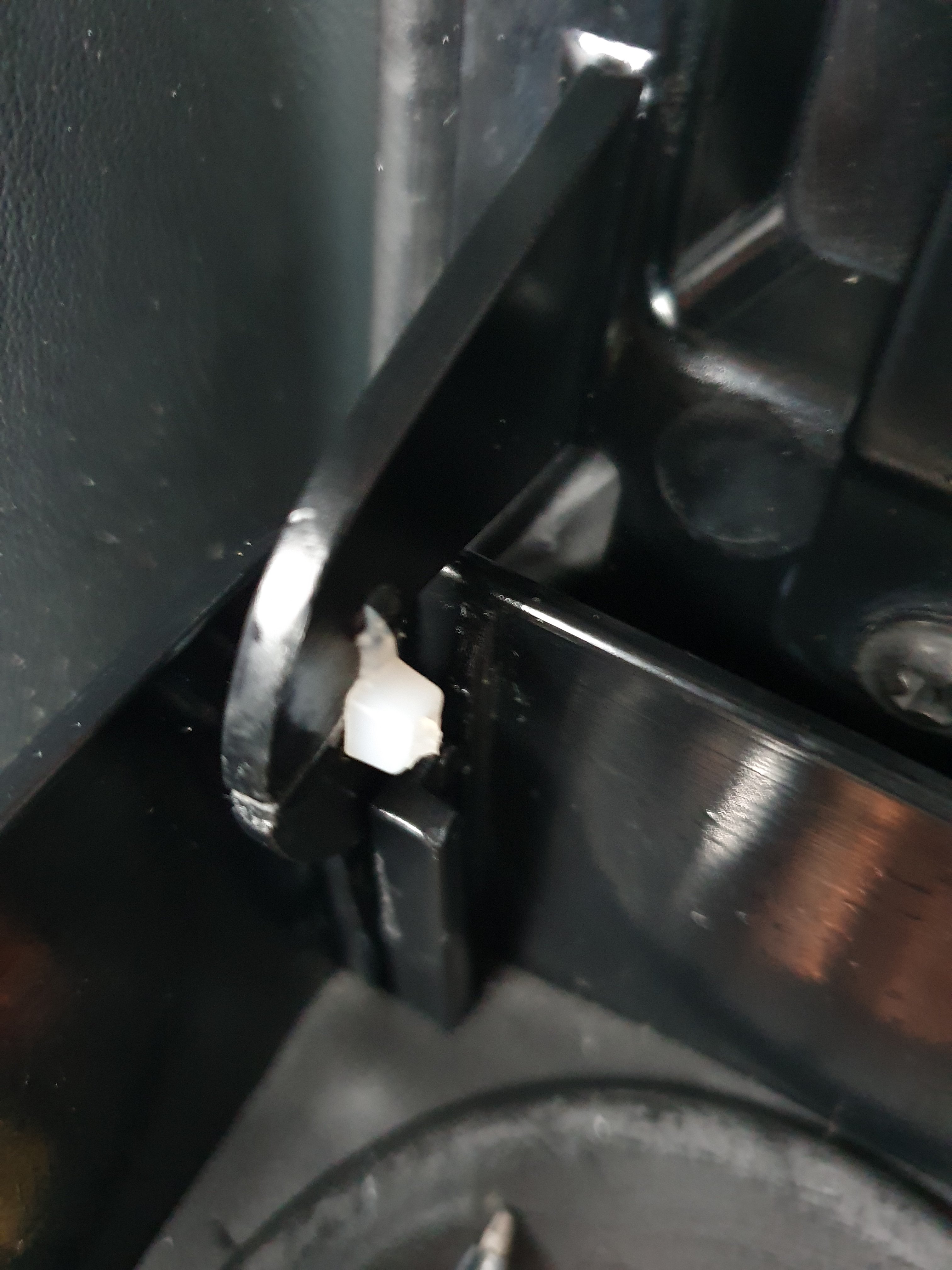

After a few failed glue attempts, today I took lid off armrest and broken hinge piece out armrest.
They pop out using long nose pliers for leverage...
Then drilled holes in both parts of broken hinge and used small cable tie to fix together (again using long nose pliers to pull cable tie as tight as possible)
Put lid back on armrest (hinges pop back into place and so far so good it's perfect)

Well my armrest as started to annoy me a little now as unless rest my arm on it it rattles. John you idea looks great but mine has snapped right in the bend, so wouldn't work for me.
Have given up on glue so will have a think. Really poor quality plastic which doesn't help.
