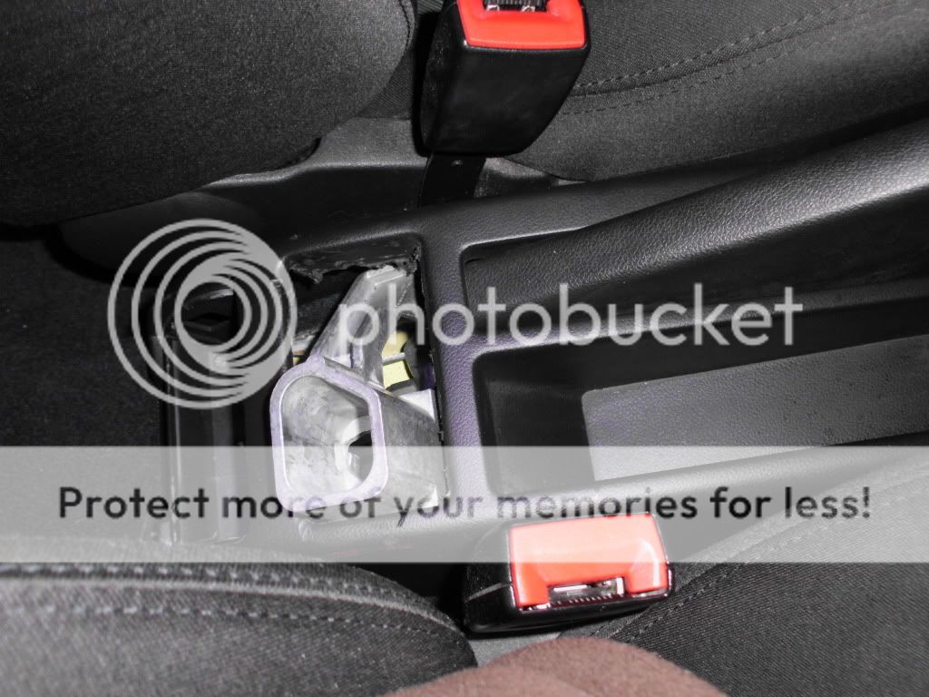

You need to cut out the coin tray at the back for the arm rest to fit to the floor and yes you will need to remove the centre console. (The one that runs between the seats, not the one with the radio in it) Sorry no idea what a Armster is so cant comment on which is best.
More or less, its easier to remover the ash tray (one screw) there are two screws under the rear ash tray and the ones down either side and yes remove the gear knob and gator, the worst bit is getting the obd port out. If i have missed anything i am sure someone will point it out LOL.
