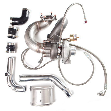

Logged a mate of mines golf last night.
Kit was originally installed and mapped on Upsolute on 440cc's, 73mm MAF by Impossible Performance. ATP mani, strange link pipe from mani to turbo, not seen it before.
Now ive no experience in loggin AGU's, no map sensor etc... so i done as many logs as i could.
If anyone can figure whats goin on with this car it would be greatly appreciated. To me the lambda values look lean as hell but its dumping loads of fuel and the plugs are black. But low g's would suggest the leaness.
Any help would be greatly appreciated on the logs or what to re-log
All logs were from 2.5k to 6k+ in 4th (02m box)
Thanks.
Phil.
Problems shown with the car are engine speed sensor is intermittant, speedo works now and again, theres a problem with the tank breath, the flap has to be open at all times and thats about it.
It pulls well but g/s show 171, which if im correct is about 255bhp.
Any help would be great.
