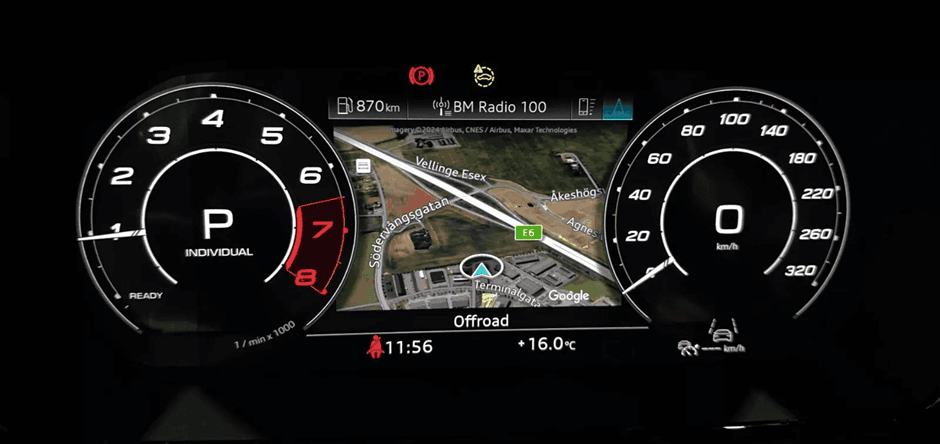

In contrast with the MIB2 system I had in my previous car (an Audi), which looked like this:
So my question is, is it possible to swap out the MIB2STD from the Leon MK3.5, and retrofit an Audi MMI (4G or later) setup?

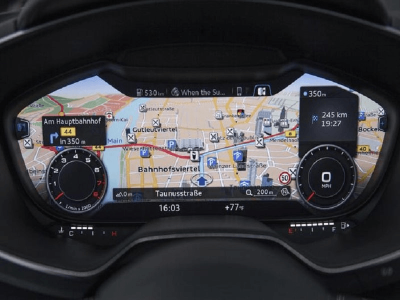

This, with a view of having your MK3.5 display something like this:

Think we are back to @East Yorkshire Retrofits if you want Audi hardware in a Seat. The cockpit image looks to be a lot clearer. That is why I was musing on the Audi TT although I think that was a Mib2 high... the MMI version of it and yes they use the common Mib2 high maps. I don't think you have the real estate of space in the cockpit but I could be wrong. Mib1 standard maps goes into Audis and Mib2 standard as well. That was / is interchangeable on common equipment but connect services wasn't.

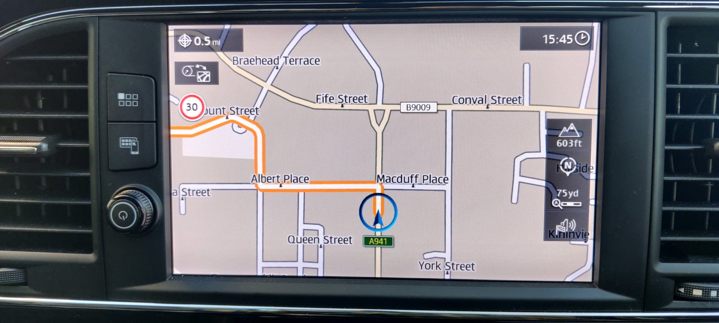

Regardless of what hardware is being used, is it possible to have an OEM setup (I'm discounting aftermarket parts such as Xtrons, Plucenter et al), that would mean 3d maps (containing 3d buildings, 3d roads) or Google maps, are displayed in the virtual Cockpit?
I have attached a picture of the current presentation, which (although functional) has pushed me back to using AA due to the dull and frankly depressing nature of it.

Will let @East Yorkshire Retrofits give you a quote ;). That's the Audi TT setup
Probably a bit retro these days as cars come with the big panel front screens these days. I can't totally see how that one works without a touch screen. You can't be fiddling with the virtual cockpit to input things. Must be a little frustrating doing weird click button actions.

Quite a few people updated from mib1 to mib2. Some implementing mib2 high with the 3D building projection maps that add a touch. Basic setting of mib2 is to toggle between the flat view and the 3d view but not 3d projection view. Only the mib2 high did that one.
To make your screen a bit more exciting you toggle on the 3d projection. Then you have the auto zoom button... I'm sure you know that. Where people traditionally moan about the artifical clouds that appear in the screen at the top part with a what is this. That's your initial step on that screen. Bring some icons up and put in into 3d. Doesn't look so bad then. That's all in the manual.
