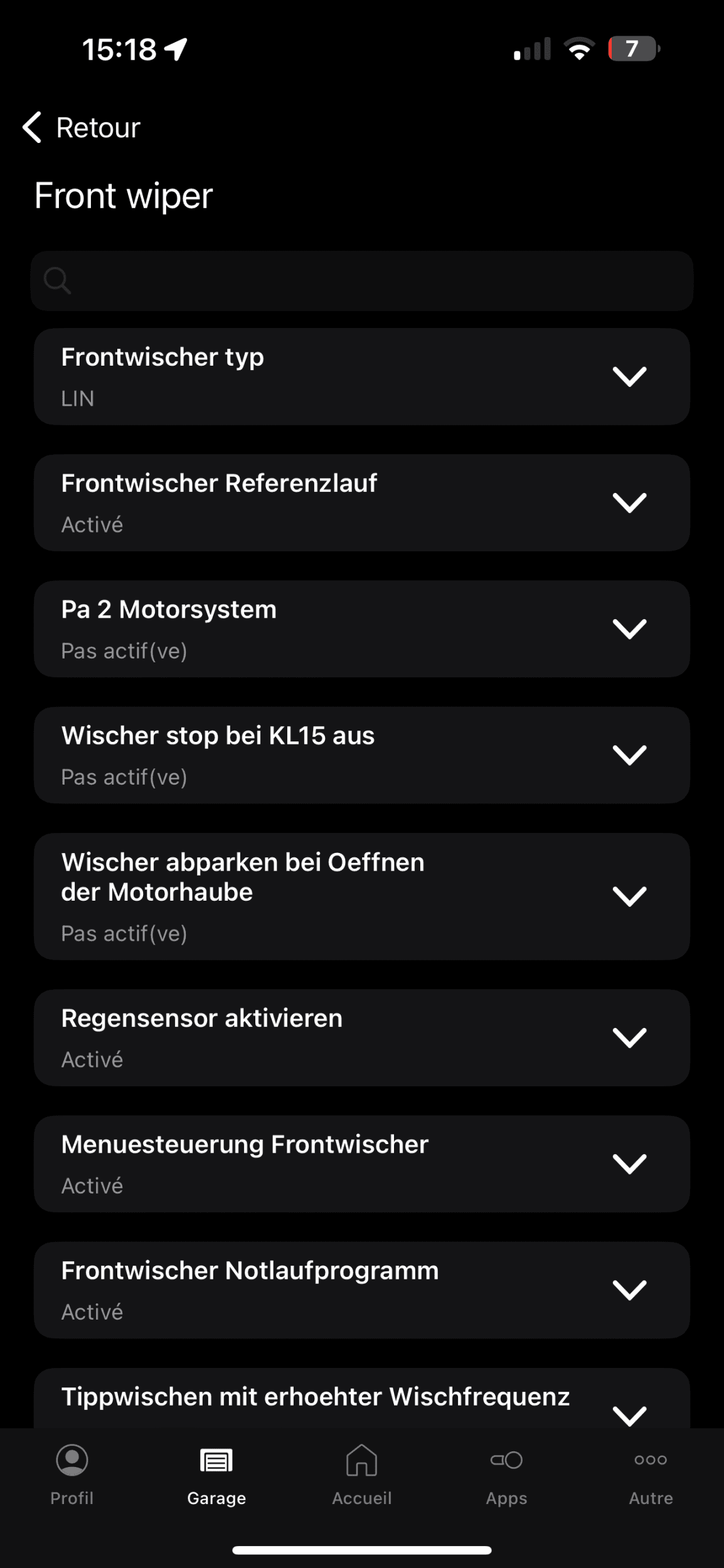

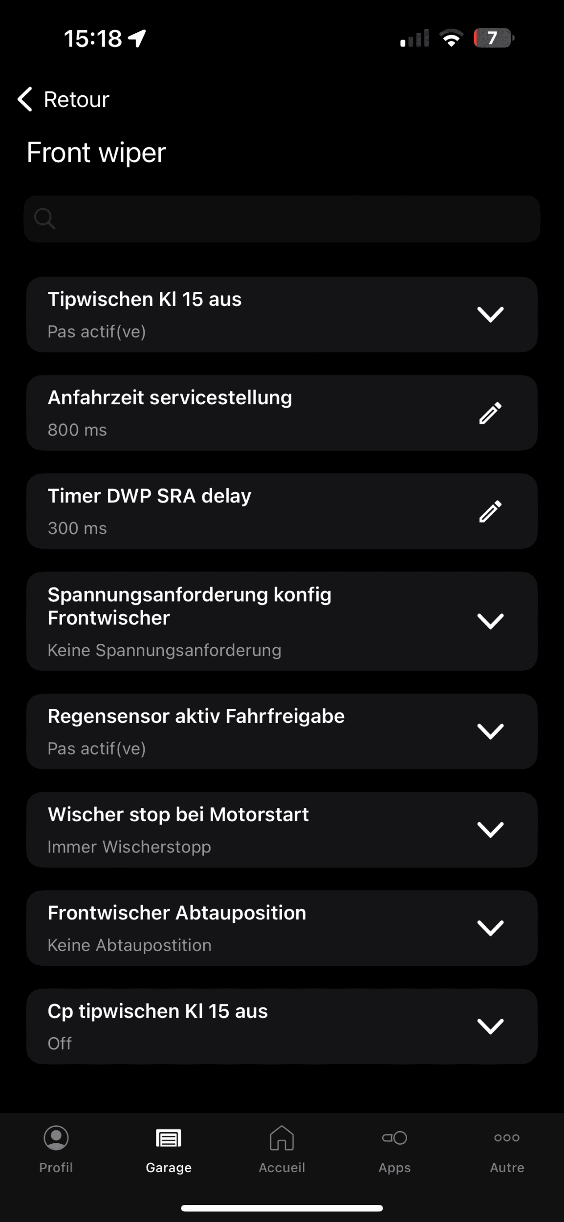

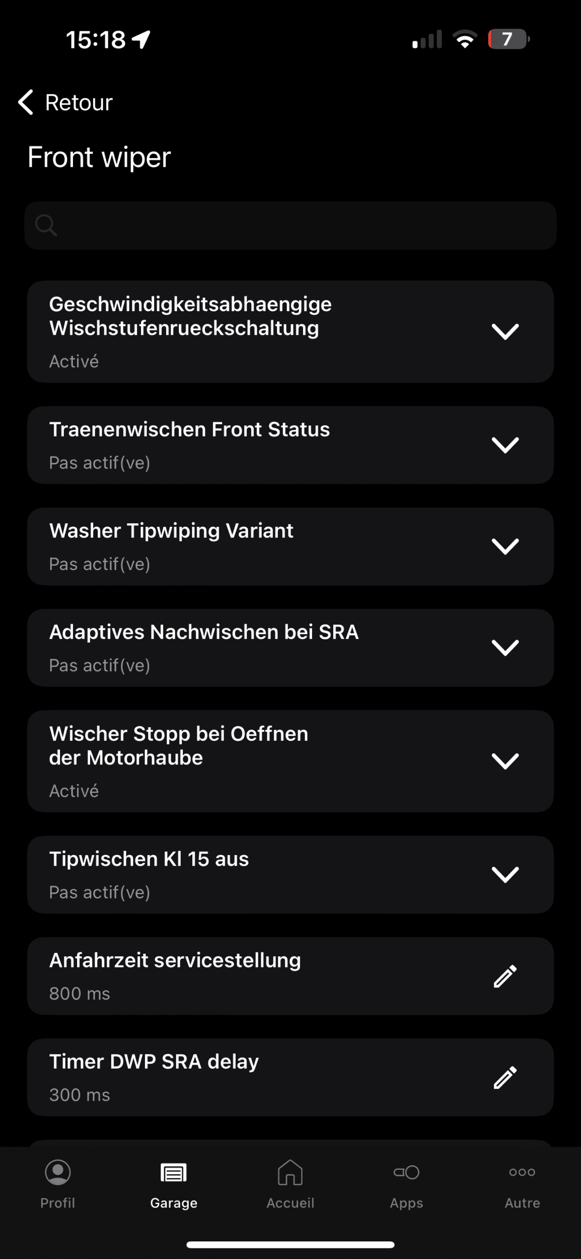

Litlle precision, i already have look on front wiper menu in central electrics.

I don't have automatic parameter in infotainment menu but i think i was maybe found the problem.
In 09 - Central Electrics units --> Adaptation --> Front Wiper --> Frontwischer Notlaufprogramm is set to Active.
The term "Notlaufprogramm" literally translates to "backup program" or "emergency program", implying that this function could be activated if the system detects an error or problem. IDK ?
If someone can tell me on his car the same parameter is in active or disabled ?
I already try to put it to disable for test but i have the message : function not available ><
If someone can tell me his car has the function set to disable, i may try to found the security code or see a dealer to correct the problem.
