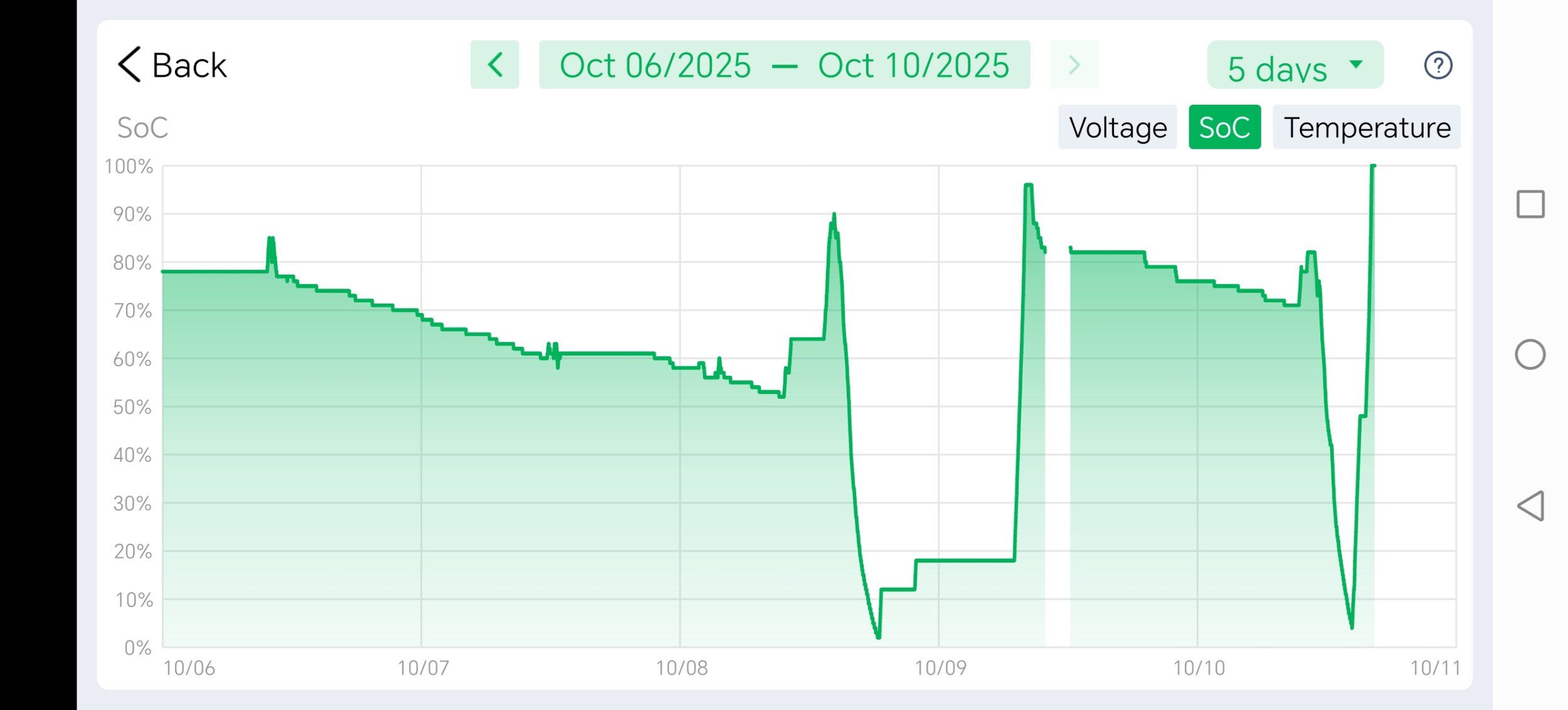

Hello!
Yes, similar issue with my Leon 1.5 etsi and I decide to monitorise 12V battery. Look what happening in attach picture. I a few hours the 12V battery is almost completely drain. That means almost 10 amps or more in stationary mode. What could consume so many I don't know and the dealers just change the battery.
They don't solve the problem because is very difficult to find it.

Just guessing it is a heater such as rear window heater or aircon/heater that is coming on and draining the battery. Is the interior of the car hot or cold, or is the rear window warm?
Hello!
same
When yoi have the ignition on, withoit runnjng the engine the system can already draw 18A easily.
If you have estimated 10A means the car is not switched fully off.
But see etsi that is an mild hybride so 48v system no hynride with 300v battery.
With the hybride if you keep schedule the ev charging this will keep the car awake and will drain 12v battery.
For does best to connect and directly charge the car

Look what happened in stationary mode. Draining is so fast and randomly that is almost impossible to detect where come from but is huge. Tens of amps. Even for 70 Amh battery. Apparently the car don't want to go to sleep.
