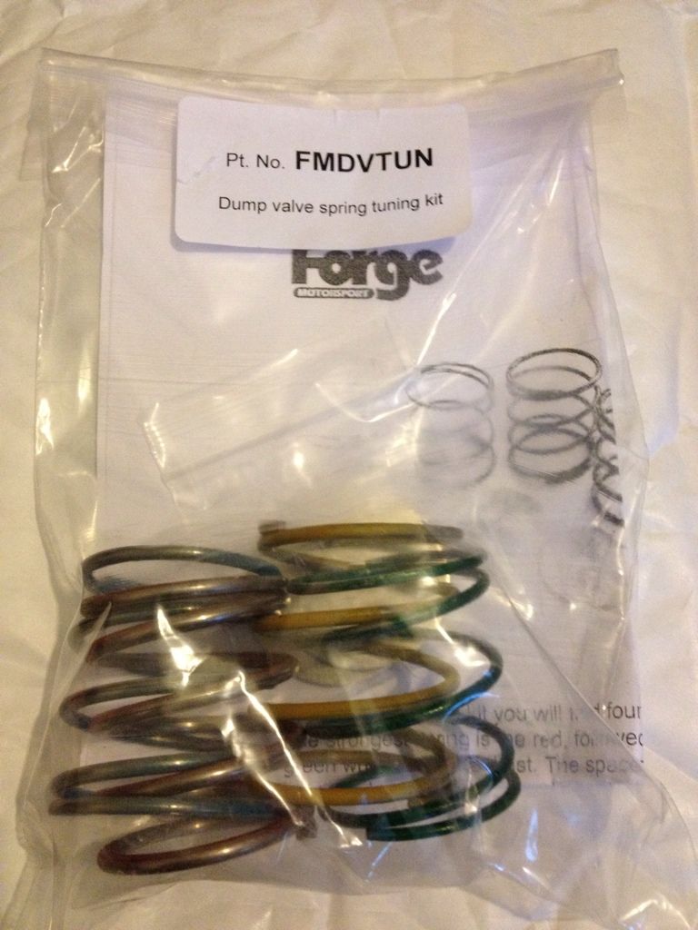

I've ordered myself a 007 refurb kit and a yellow spring this morning. Since fitting the intercooler the cars been dumping randomly, I presume as it can't hold the higher boost.

Had my little package arrive from forge today, my refurb kit and new spring for my 007p.
Looks good, just got to find time to fit it now.

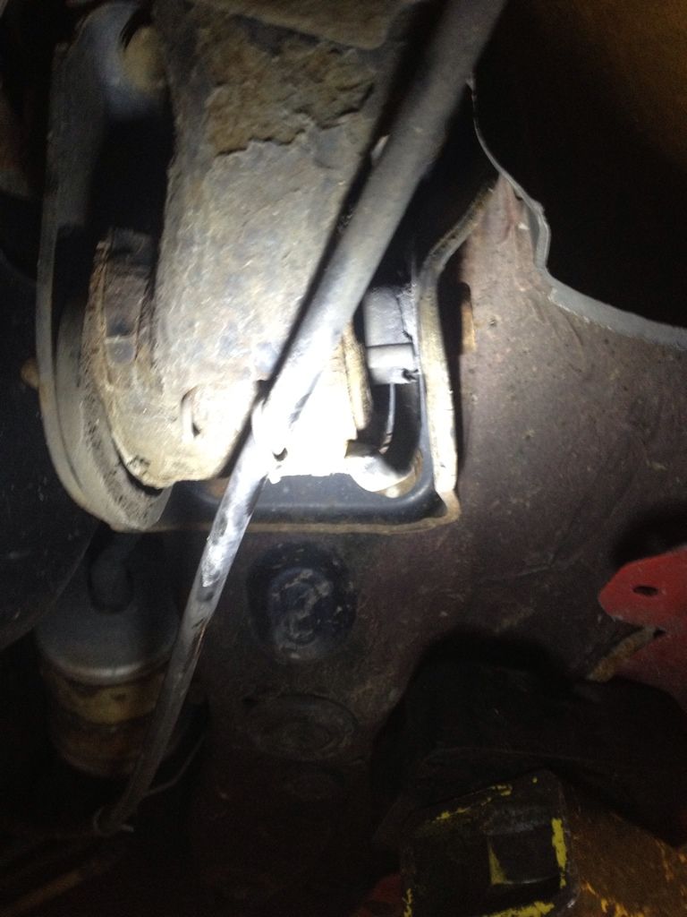

I took my car to a mates garage today for an oil change.
While up on the ramps I took the opportunity to check out under the car.
Well to much disappointment I have a split CV boot, nothing really new there, I need 2 new tyres thanks to severe uneven wear and finally I have absolutely knackered rear beam bushes. All need doing for my MOT next month :(
Ouch. On the plus side you have an excuse for poly bushing now :)

With regards to the DV servicing kit, yeah it does only take 10 minutes but (i know you probably wont) but do not over grease the piston as it will stick. That little pouch of red grease should last you ages. Only need a tiny bit of grease on the seals and even less on the piston.

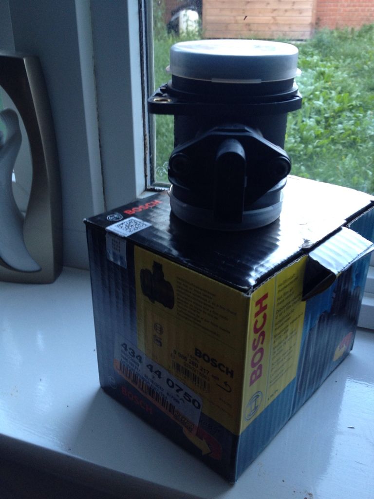

I've had a couple of problems in the last week, my MAF died in a top fashion so had to replace that. Also kept blowing a boost hose, so me and Tim ended up taking the pipe work off of the drivers side and re-flaring the pipes to stop them blowing off.
One broken down car :(
And the new MAF
Since doing that the car pulls really smooth, guessing the MAF has been dodgey for a while.

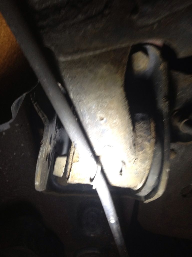

The first of the polybushing began today.

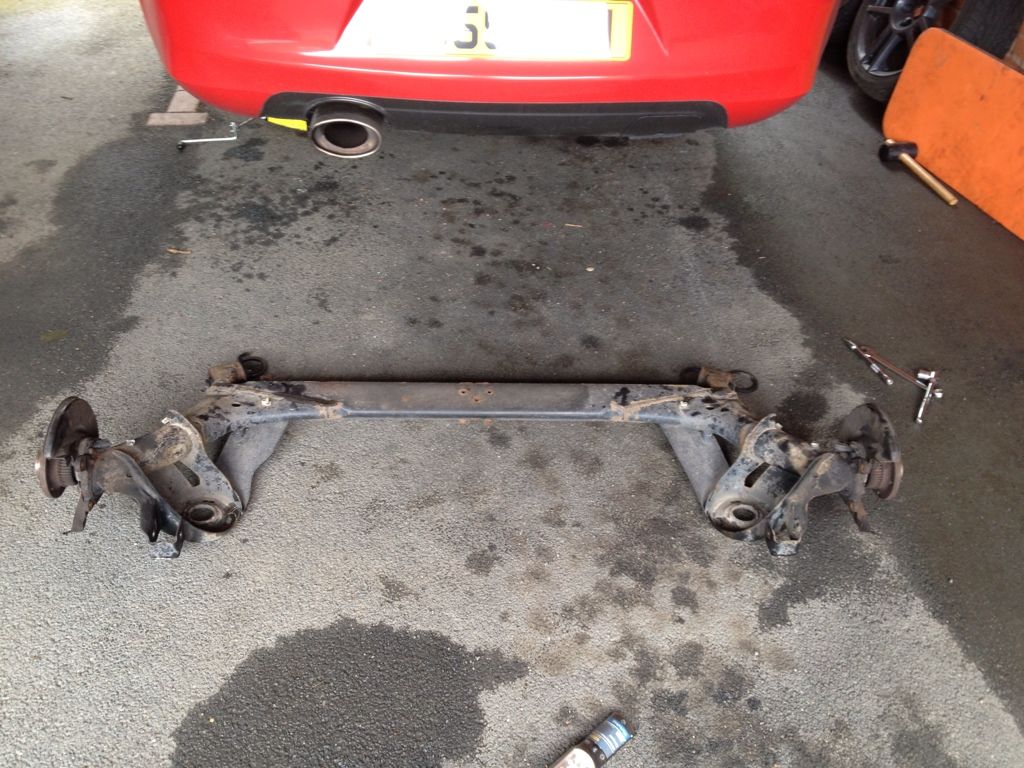

With my MOT coming up and the rear beam bush being in desperate need of replacing I set about the mission of doing it! 9hours later it was finished.
The rear beam dropped.
The bushes were literally falling apart.
Tim cutting the sleeves out of the beam.

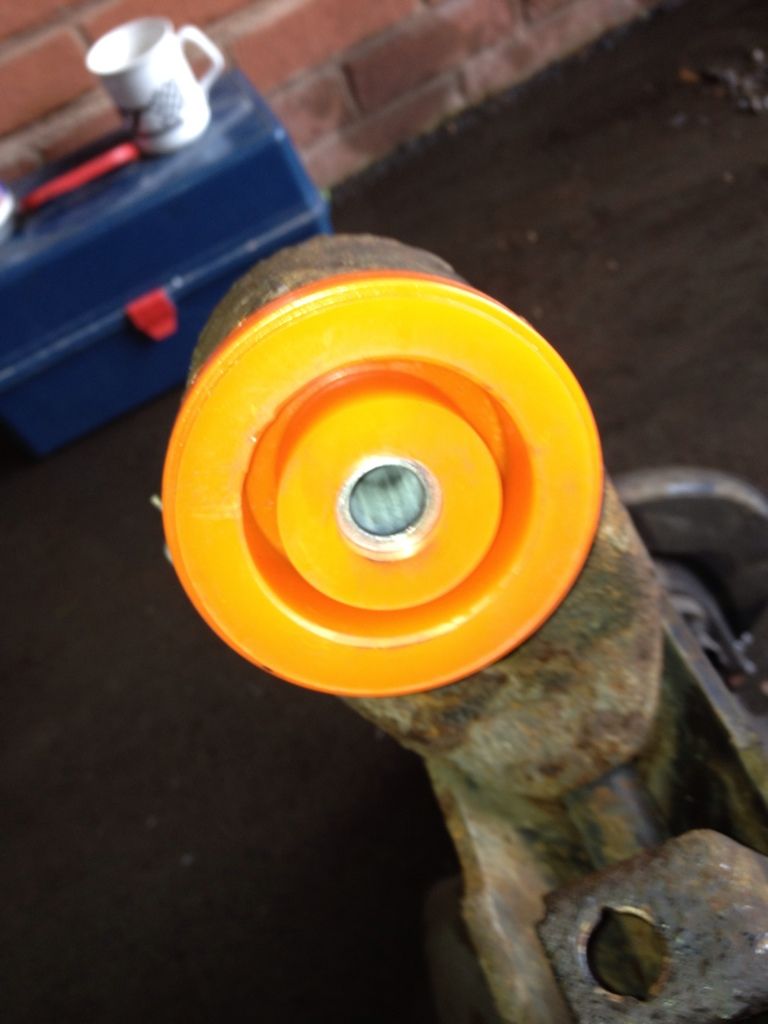

Old vs new.

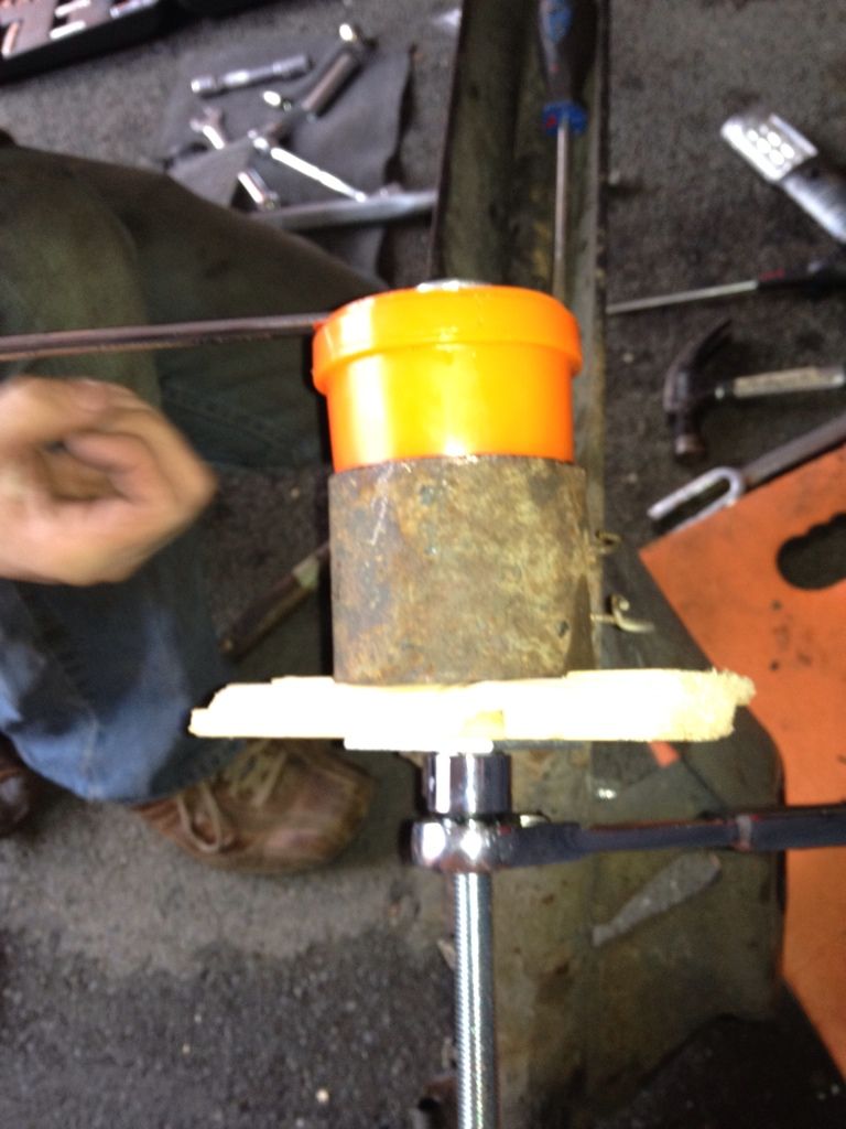

My custom made press, a long threaded bar, a couple of plates and a piece of wood.
And finally in.

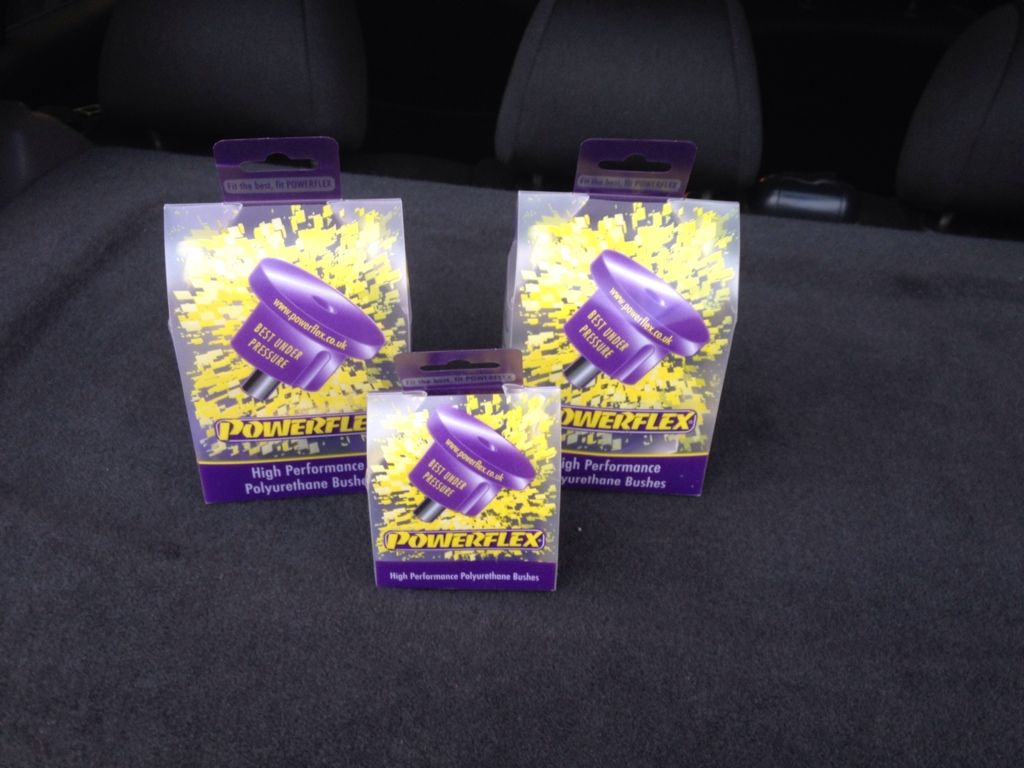

Made a little purchase during the week
All in preparation for my front end change to the LCR setup which now needs to be done for 30th of September for the trackday at Blyton Park. :)
