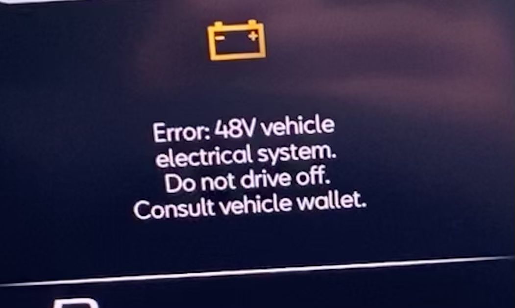

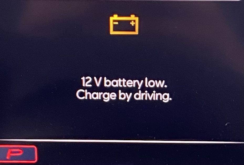

So yesterday on 2 separate occasions 2 different faults showed up on the dash (see pics attached).
After turning the engine off and on the faults disappeared. Has anyone else had this?
Quite often when I start the engine I get a fault ping up, sometimes about a park error or a distance error - but it generally goes too quickly to read and doesn’t stick around.
As it’s a brand new car I’m wondering if it’s just a few computer gremlins rather than issues with the battery already?!

Called out SEAT assist to diagnose the errors on the dash. The technician said there is an ‘outstanding campaign’ on the car to change software on 3 of the control units.
Basically similar to a recall, but not for safety reasons. So I have booked it in with SEAT to get it all updated.
Just thought I would update the thread in case anyone experiences similar.

So to update this further again. A few weeks ago I had even more battery error messages which resulted in my brand new car being flat bedded by the AA to the dealership!!
It was there a few days undergoing diagnostics, and they eventually said there was a wire loose going to the battery - which I’m extremely sceptical about.
Today I have again had the 12v error (first pic in original post). It happened after my partner was sat in the car with the radio on and engine off for 30-60mins. Just wondering if anyone else gets the first error and if it is normal if using battery related things without the engine on?

I get the 12v error after about sitting in the car for an hour without engine.
Ok thanks, so not necessarily back to the first load of battery issues. Will keep an eye on it.

Hi guys, just thought I’d update this thread as it’s been a few years!
Last week my 12v battery was displaying multiple error messages. It went into SEAT, they said they tested it and it was fine ?. Less than 24hrs later I couldn’t even get the car to start and AA came out and tested the battery on my drive, within 15mins he told me it was a defective battery.
Back to SEAT, they’ve now agreed (after 4 years!) that the battery is indeed faulty and they have replaced it - no cost!

Hi there, at Monday morning i also got the two battery errors as posted by OP
Car is a 2021 Leon FR 1.5 e-TSI
Error: 48-volt-supply. Do not drive.
Low 12-volt battery. Charge by driving.
The 12 volt battery is just bad i guess, it sometimes spams my instrumentcluster with low battery warnings. Even sometimes when its 3 degrees celsius... Battery shouldn't be low, my drives to work are 98km each way
It was -6 degrees monday morning when i got the 48-volt error. I scanned the car via OBDEleven, and it told me that the battery was just low (29%) - So not sure about that.. Never had the issue before, but its also the first time it was that cold in the time I've owned the car (Got it April 2024)
I left it in idle for 30 minutes and did a complete reboot of the car and it's electronics, then the error went away
Anybody else got 48-volt error at these low temps? :)
