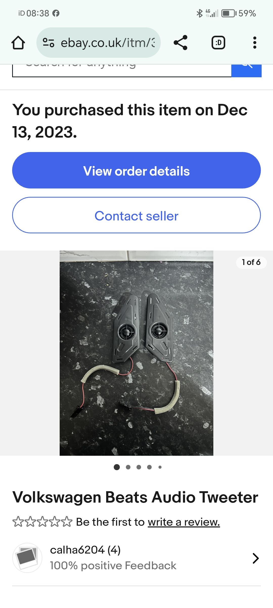

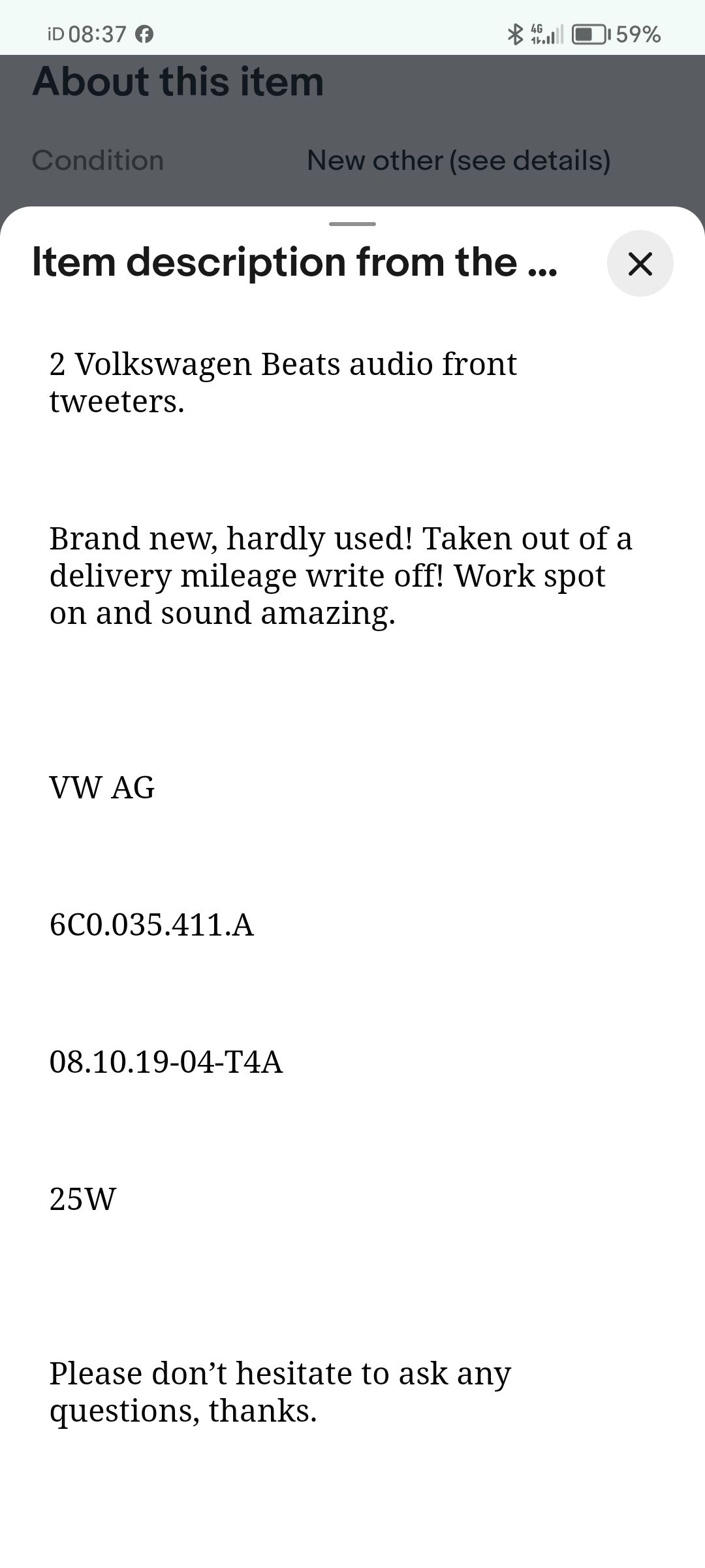

I have just fitted rear door tweeters,(Beats from golf mk8 and extra crossovers as beats tweeters have no crossovers build in)
there are empty grills for them next to door handle, just covered out with bit of plastic. Sound is much better on the rear just need to figure out how to connect small sub maybe feed it from center channel?🤔 Sound good anyway.

Ah, yes you are right, I thought they are from golf, but just had a look and it says from vw so could be other model🤔. Maybe t cross or something.
Thay had this plastic plate but I have removed it to fit correctly and used bit of hot glue and some sticky foam.

They must be from polo or t rock front A pillar, anyway price was just £20 and as I said space was there for them so cheap little upgrade only thing they might be slightly to loud for rears even with crossovers.
