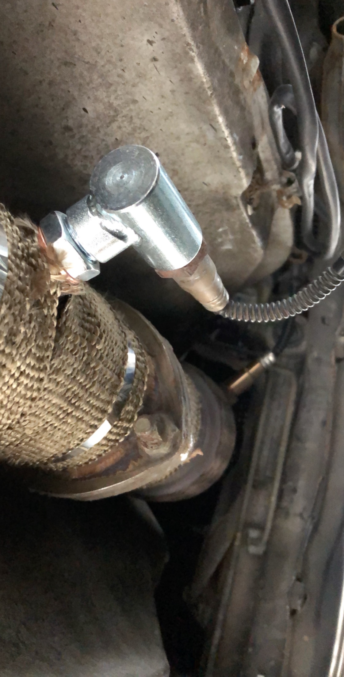

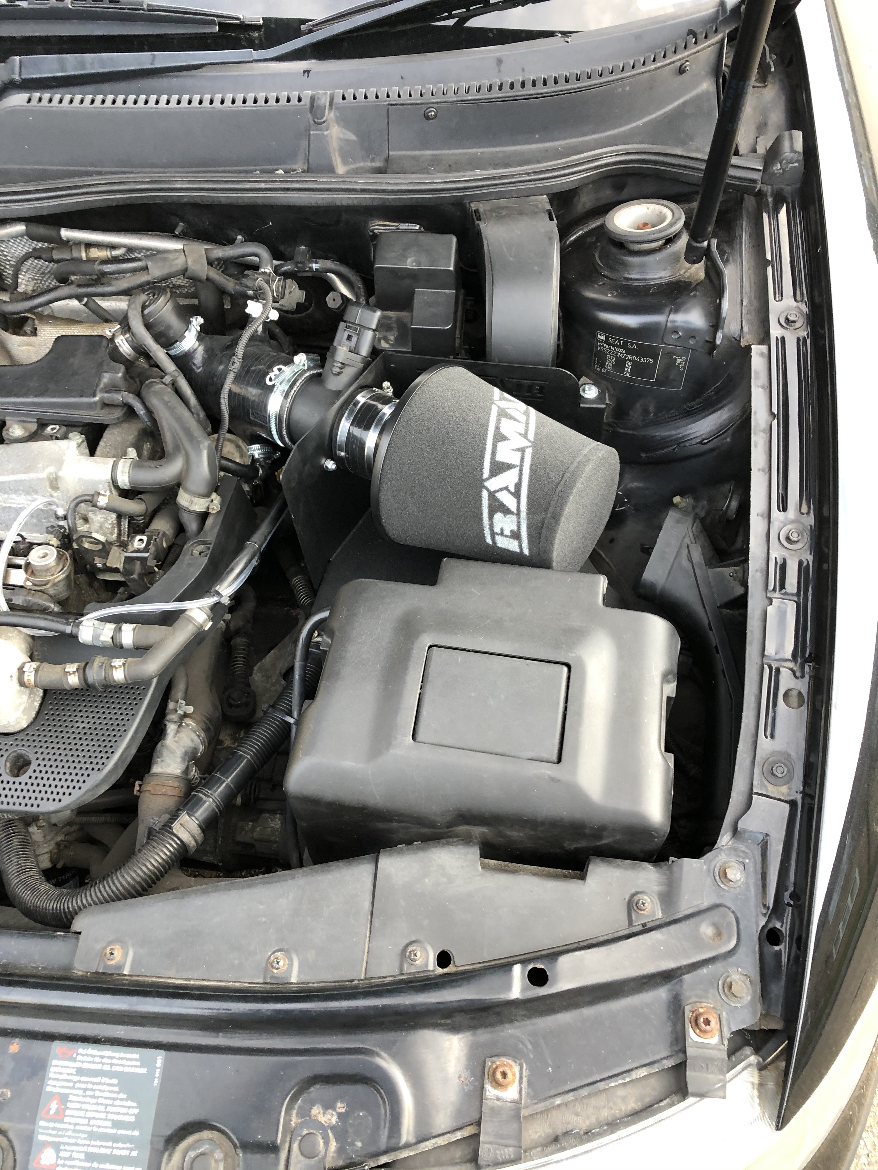

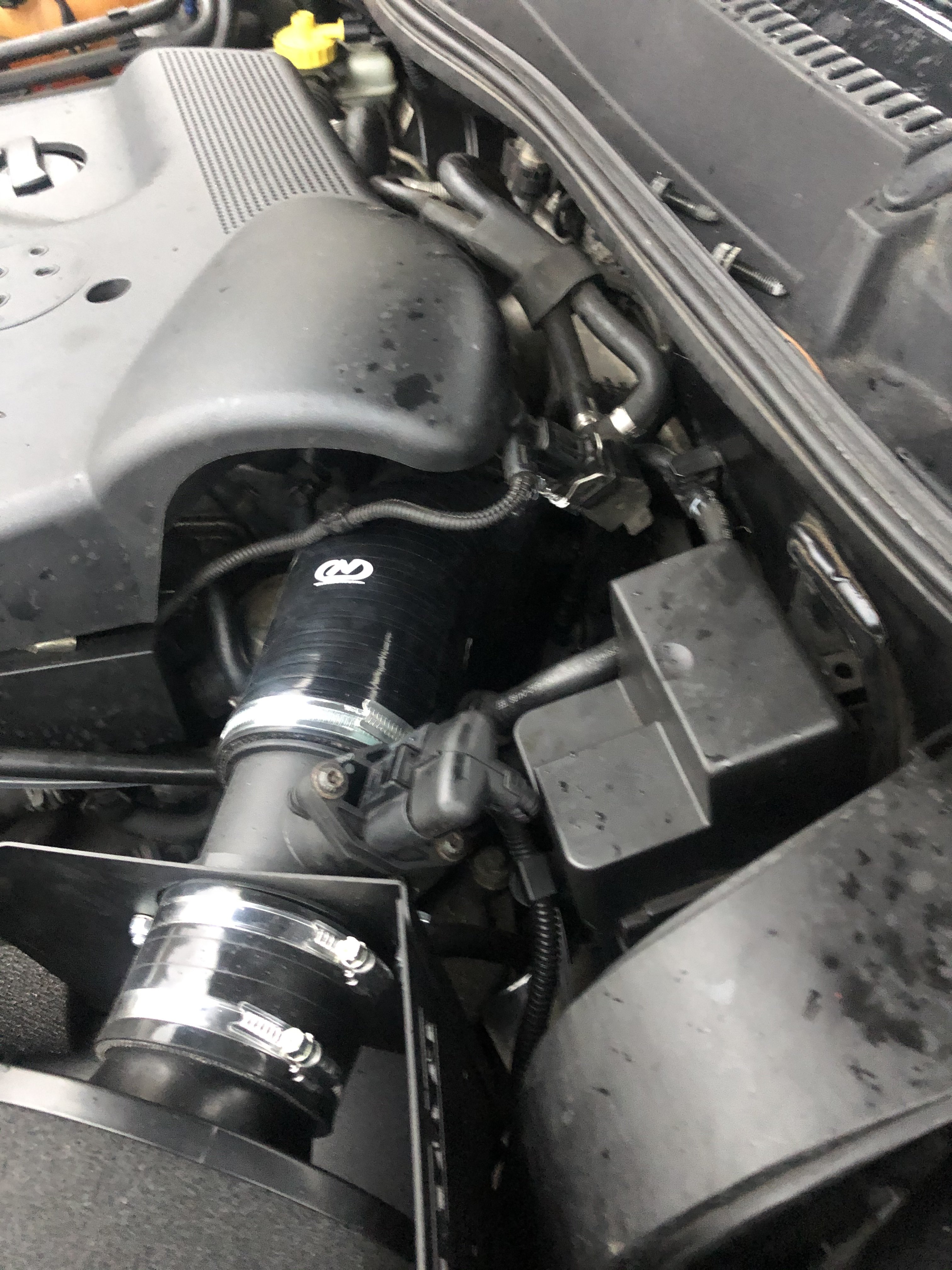

Instead of writing like 10 different posts just gonna bang out everything thats been done to it since owning jt in the one post so Started off with getting a ramair filter mainly for the turbo noise but want to get a few things fitted before it gets a remap, was real pleased with the noise but was itching to get abit more of a burble from the exhaust so got a 3” turbo back downpipe and decat off of someone on facebook for abit of a steal and i know people say “dont heat wrap exhaust they’ll corrode blablabla” but when you can pick them up for like 50 quid id rather have a couple pops from a hot downpipe ! Was abit of a b**** to fit whilst using the worlds smallest jack and axle stands but heyhoo got it fitted in the end ! Next up was some nighteye bulbs, i know people say they blind other road users but i got them aimed right down so they dont do anyone in the eyeball and im pleased with them and finally today after having to walk the dog then doing a food shop with missus i went out and fitted a creation motorsport over aized tip which was a ARSE ! Everything is too big and nothing fits properly so gonna have to take it off next week and do a few adjustments with a hacksaw

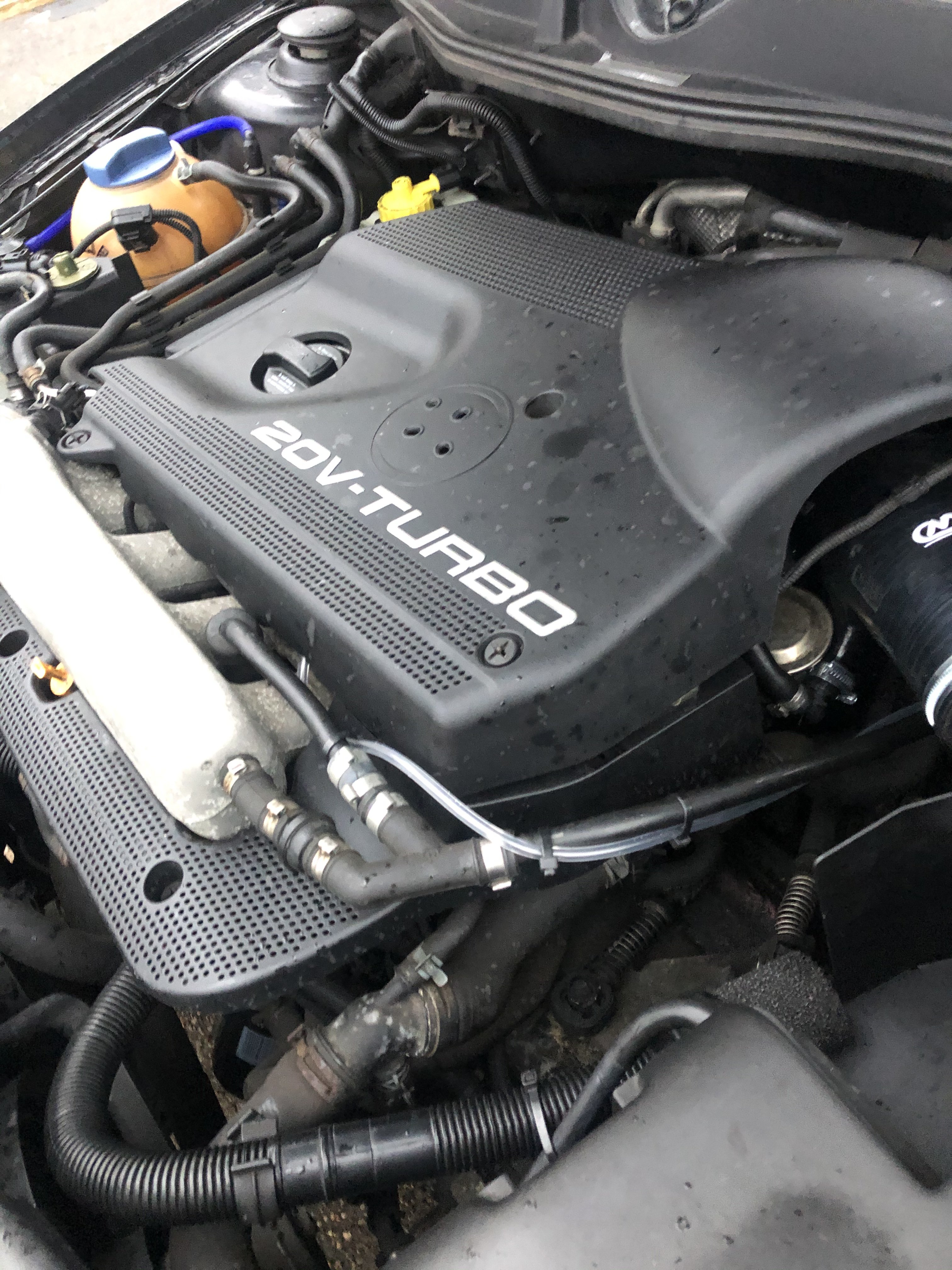

Also forgot to mention i fitted alittle boost gauge and its vac is at -24 and boosting at arounf 12psi, is that normal for a unmapped auq ? also fitted a lambda spacer to try get rid of the eml light from the decat but that hardly worked so gotta get that mapped out and hs anyone else had the same problems with their oversized cms tips ?

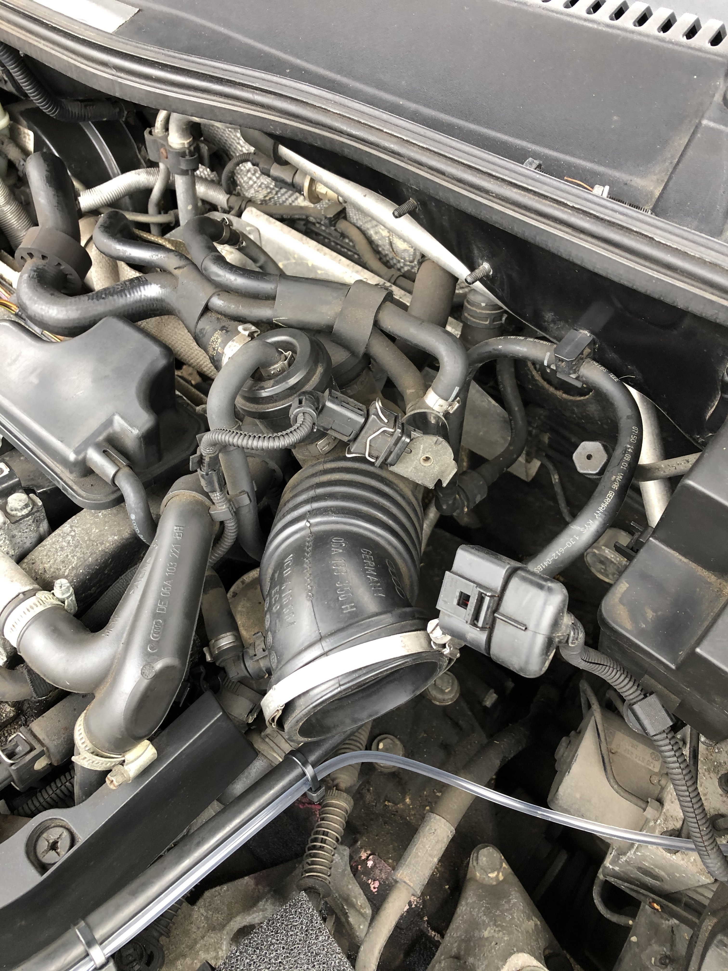

Just wondering if any of you guys know the cause of these codes that are popping up, i got p0030 and p0135 which i knows from the lambda sensors cause of the decat but since fitting the oversized tip ive started to get p0141, anyone know what thats about ?
PO141 is heater failure on the O2 sensor(s), its quite possible you broke a wire when moving things around as I think the wiring is routed in and around the TIP area

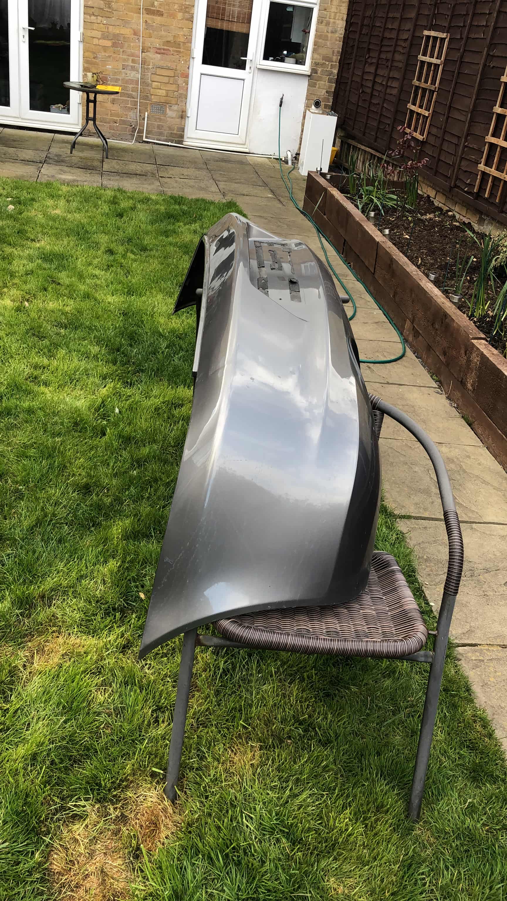

Little update, with all the isolation time i went and picked up a cupra r front bumper for 50 quid that needed abit of repair seeing as i picked up a rear cupra r bumper for 30 quid thats been sitting in my shed for about 4 months that just needs a respray from grey to lc9z black magic !

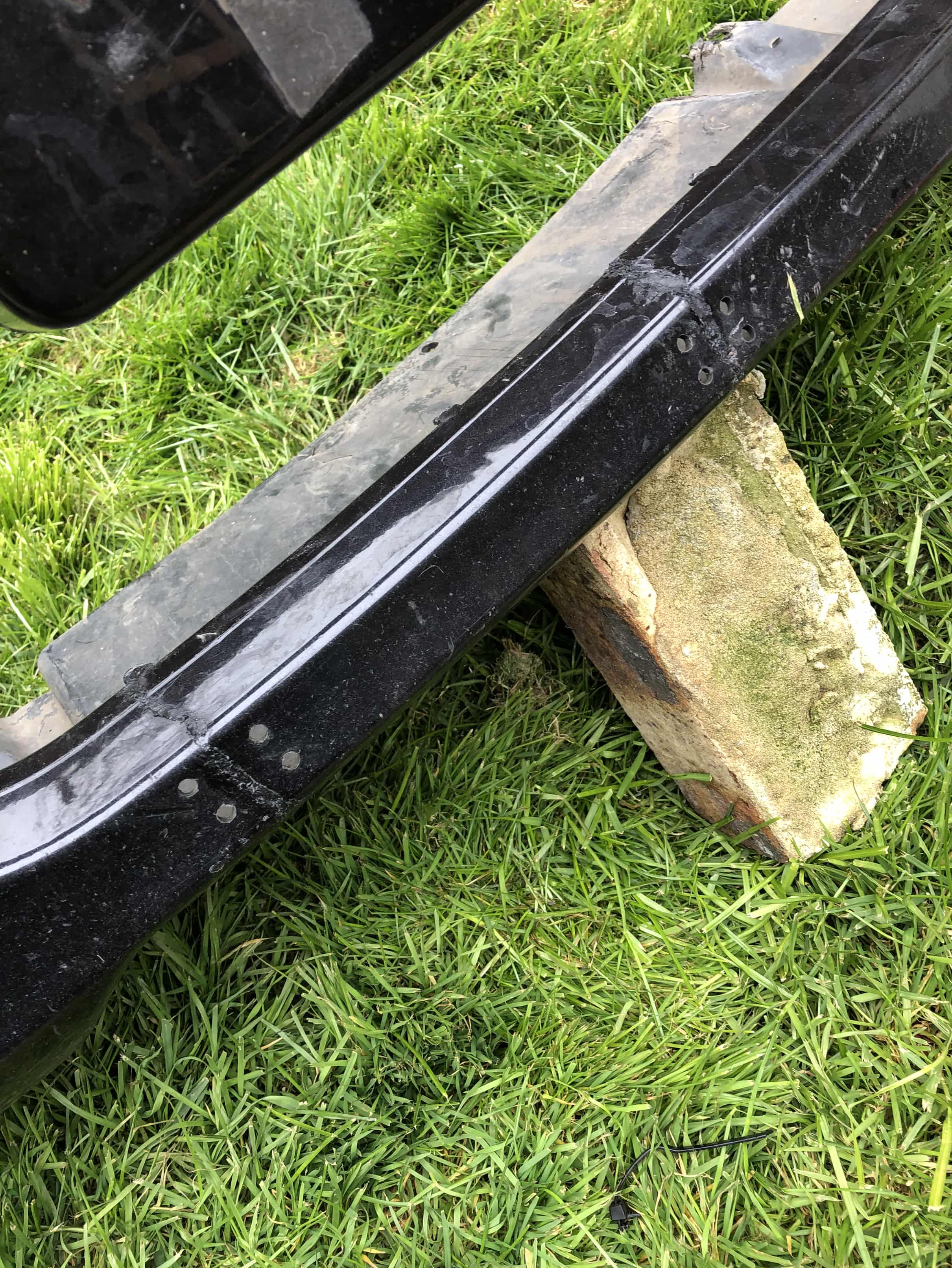

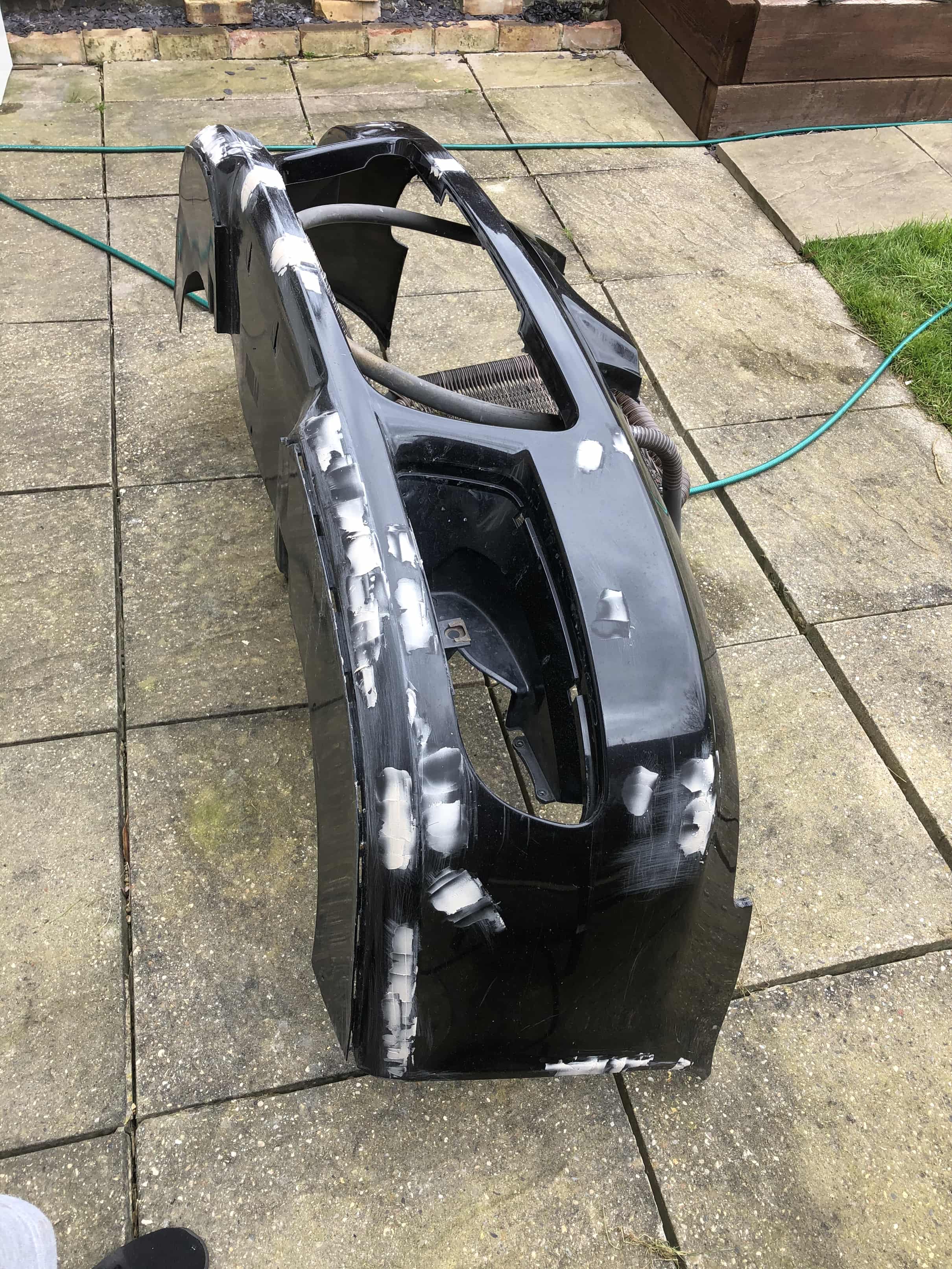

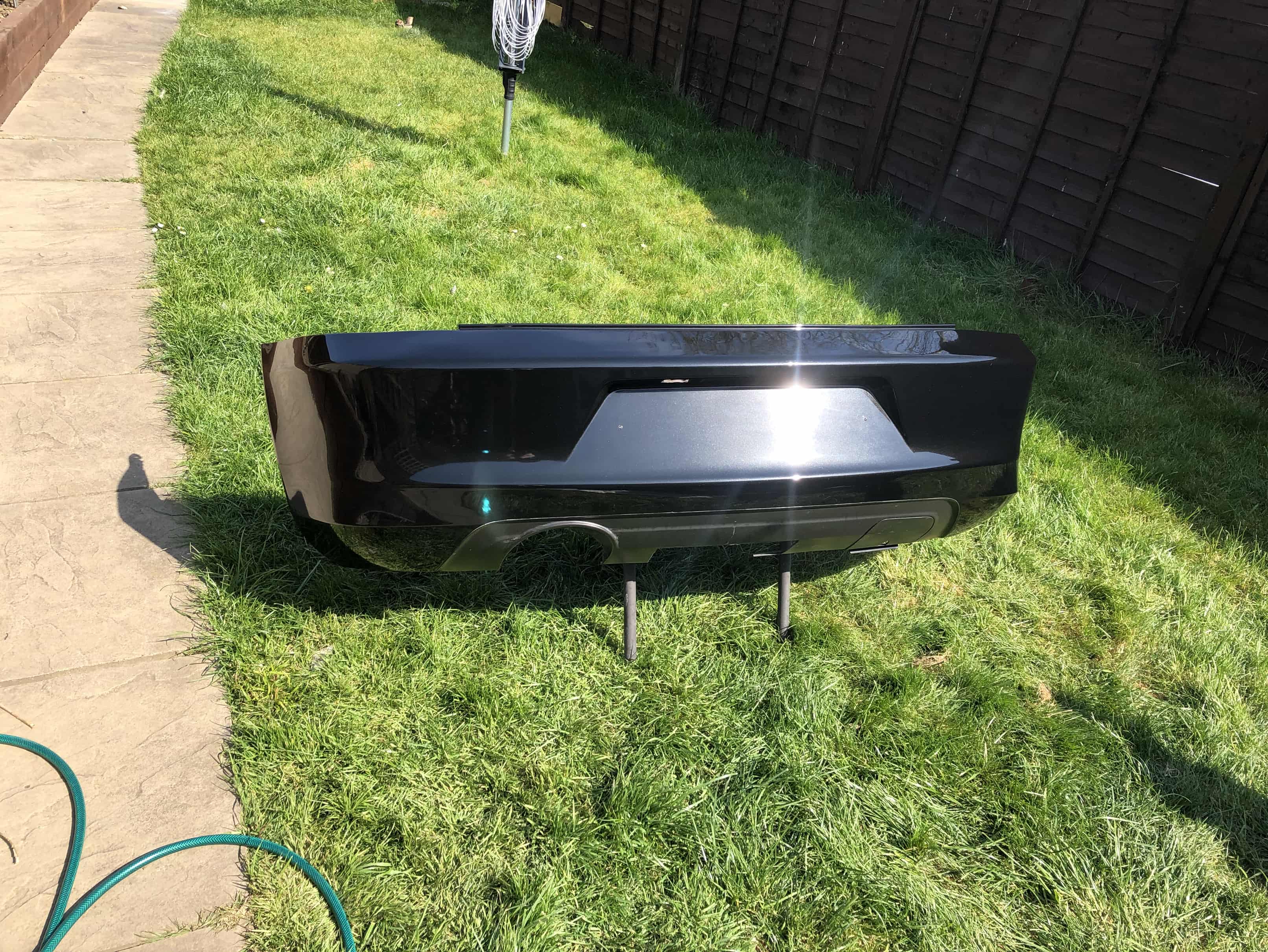

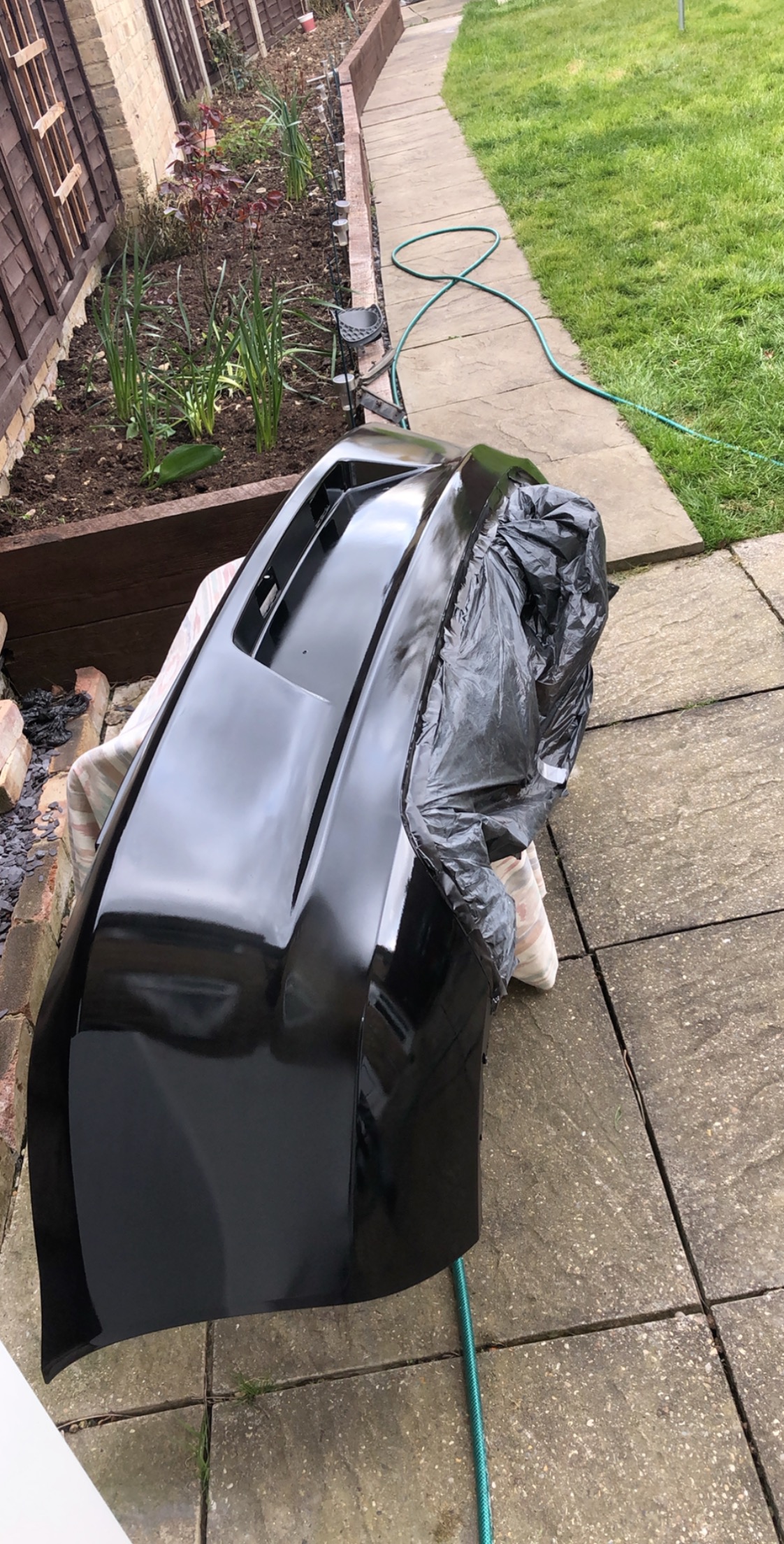

Anyways got to it yesterday and sanded, filled a couple bits and primered and base coated the rear bumper and welded the front bumper back together and fibre glassed the back for strength ! Then today i lacquered the rear bumper about 1500x, widemouthed the front bumper and done a bit of filling a sanding on the front ready for priming tomorrow and the rear bumper can be rubbed with rubbing compound, polished then waxed ! Didnt come out to bad considering its rattle canned !

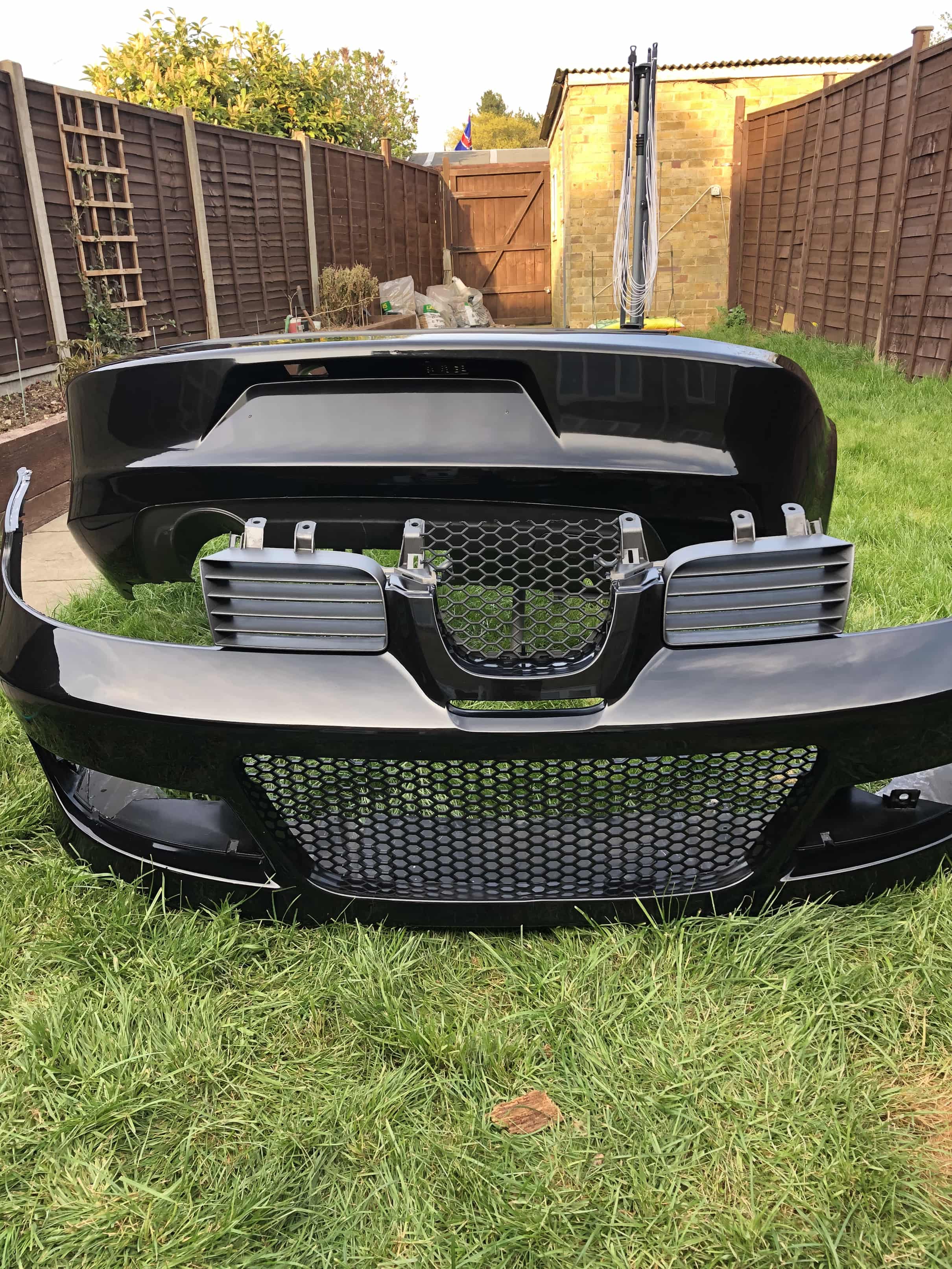

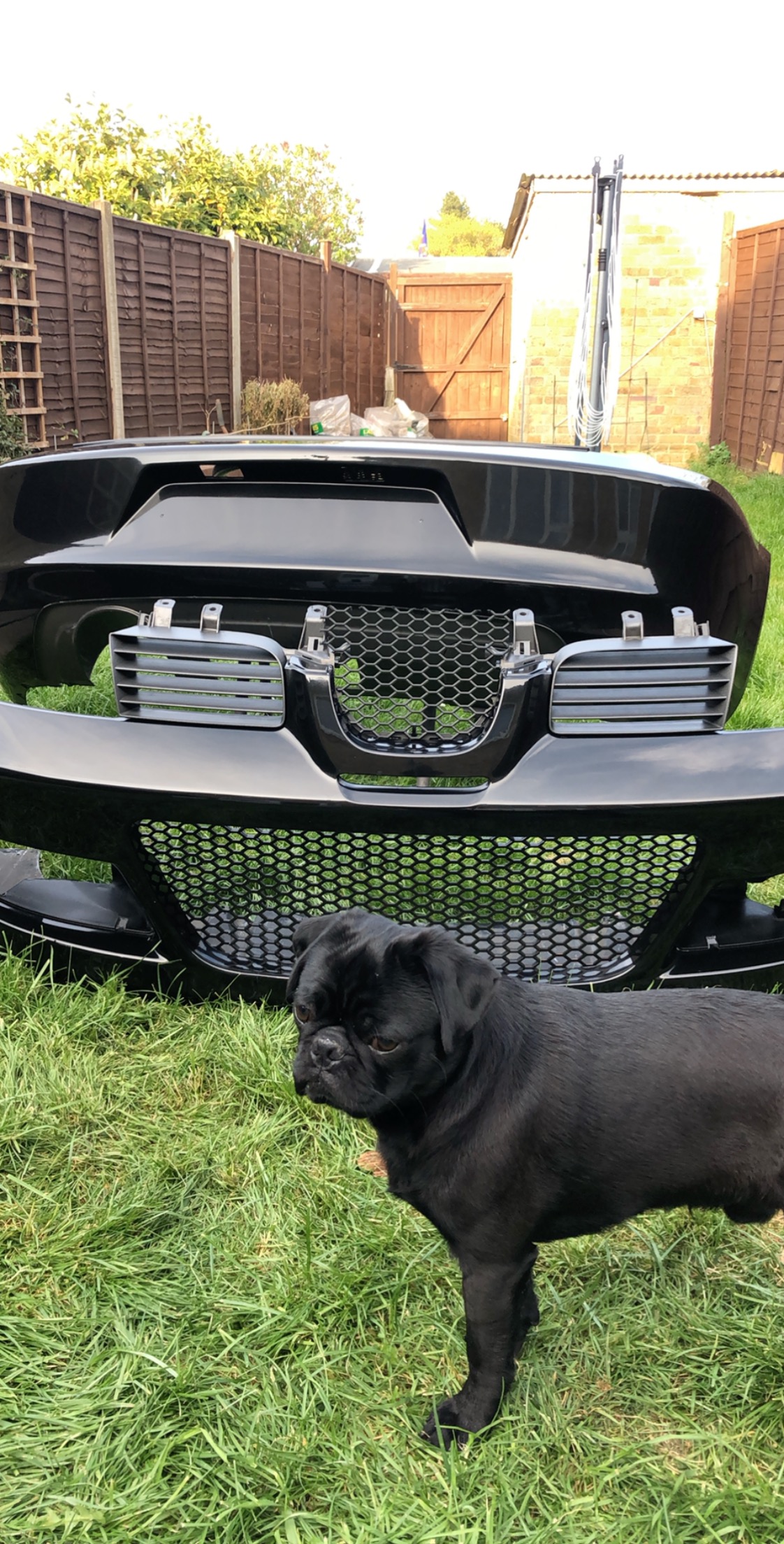

Both bumpers resprayed and front bumpers been wide mouth, came out pretty good considering they were rattle canned ! Now just looking for a link for bumper removals
