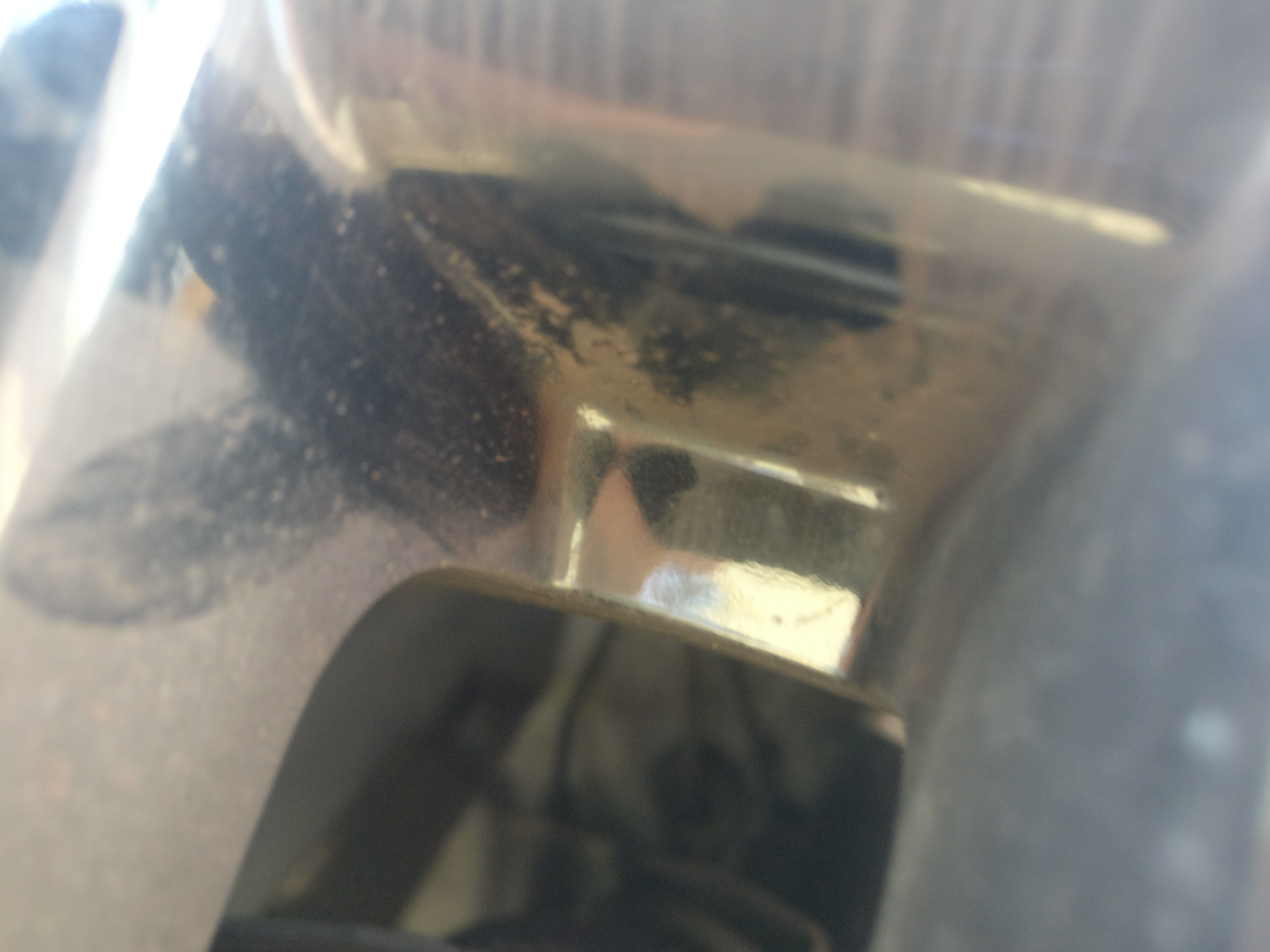

If it is corrosion, then no wheel cleaner will remove it; the wheels will need to be refurbished. However, if it’s baked on grime and brake dust that’s giving the appearance of corrosion
Sorry for crap photo. I've wiped some dust away and you can see the problem area right in the corner.IMG_20191023_125200.jpg
Sorry for crap photo. I've wiped some dust away and you can see the problem area right in the corner.View attachment 10743
I don’t think it’s corrosion. If it was corrosion, then I’d expect the black paint / powder coating to show signs of blistering, and I don’t think aluminium alloy corrosion would be reddish brown in colour.
I think it’s brake dust build up that’s baked on the surface. Brake dust build up can have a brownish colouration to it.
Thanks, that's a relief, hopefully I can get it off - gonna be a long job, there's about 100 of these little corners .
I do have one small patch of blistering on the machined surface, I expect there's not much I can do other than not make it worse!
That is a build-up from the brakes and shows that your alloys are not cleaned properly for some time. It can also show a issue with the brakes, as the cars with worn brake pads and/or other problems with the brakes can be having this kind of metal build-up in a very hard way. For cleaning it easily you have to use some wheel cleaner with the ph1 to ph5, that is acidic and removes this kind of “dirt”. All the neutral wheel cleaners can be nice to look when they are going purple, but i would use them more to clean the bodywork if needed.
