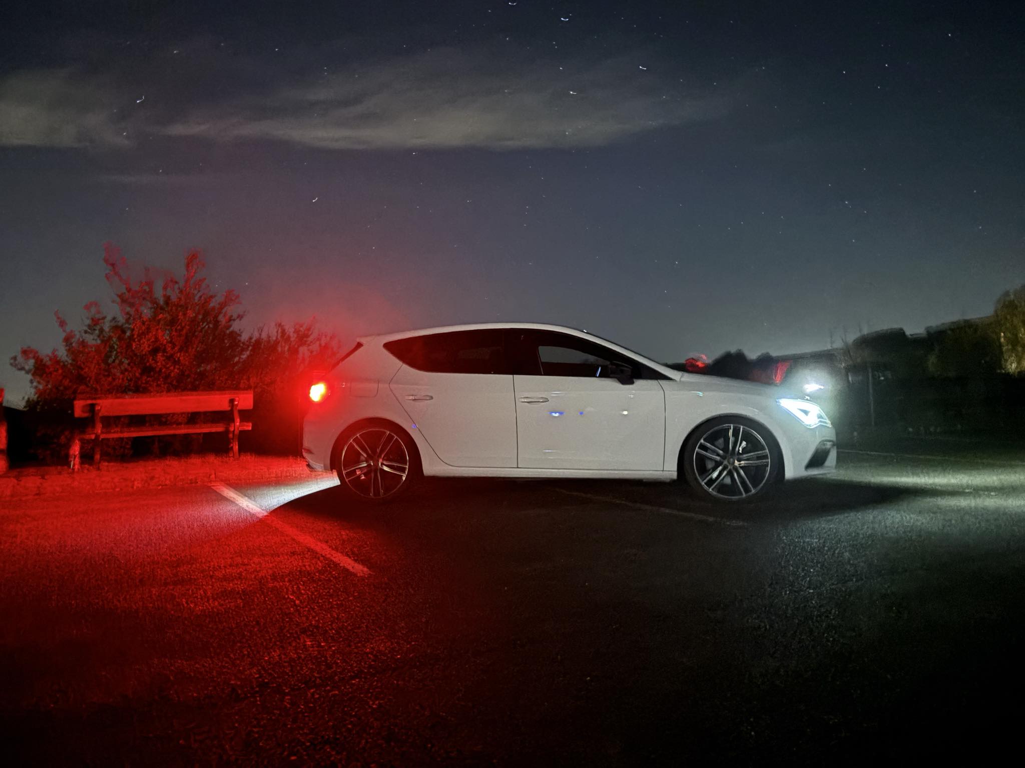

Hi Guys,
First of all i would like to say thankyou for accepting me into this forum and hello to you all.
I am looking at investing into some new wheels for my cupra as the state of England's road at the moment has meant i have now replaced 2 already and have another that is buckled and at a cost of £780 each it not an option to keep replacing them.
what do you guys think would look great and suit the car. im thinking 18" in bronze on a Whit Leon would mate the bronze badges.
Many Thanks,

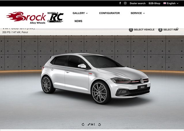

Some alloy wheel manufacturer / retailer websites include a configurator so you can see what your preferred wheel choice(s) would look like on your car (do an internet search on ‘alloy wheel configurator’). Here’s a screenshot of my car (VW Polo GTI) with my RC32 alloys from the configurator on Brock.de website;

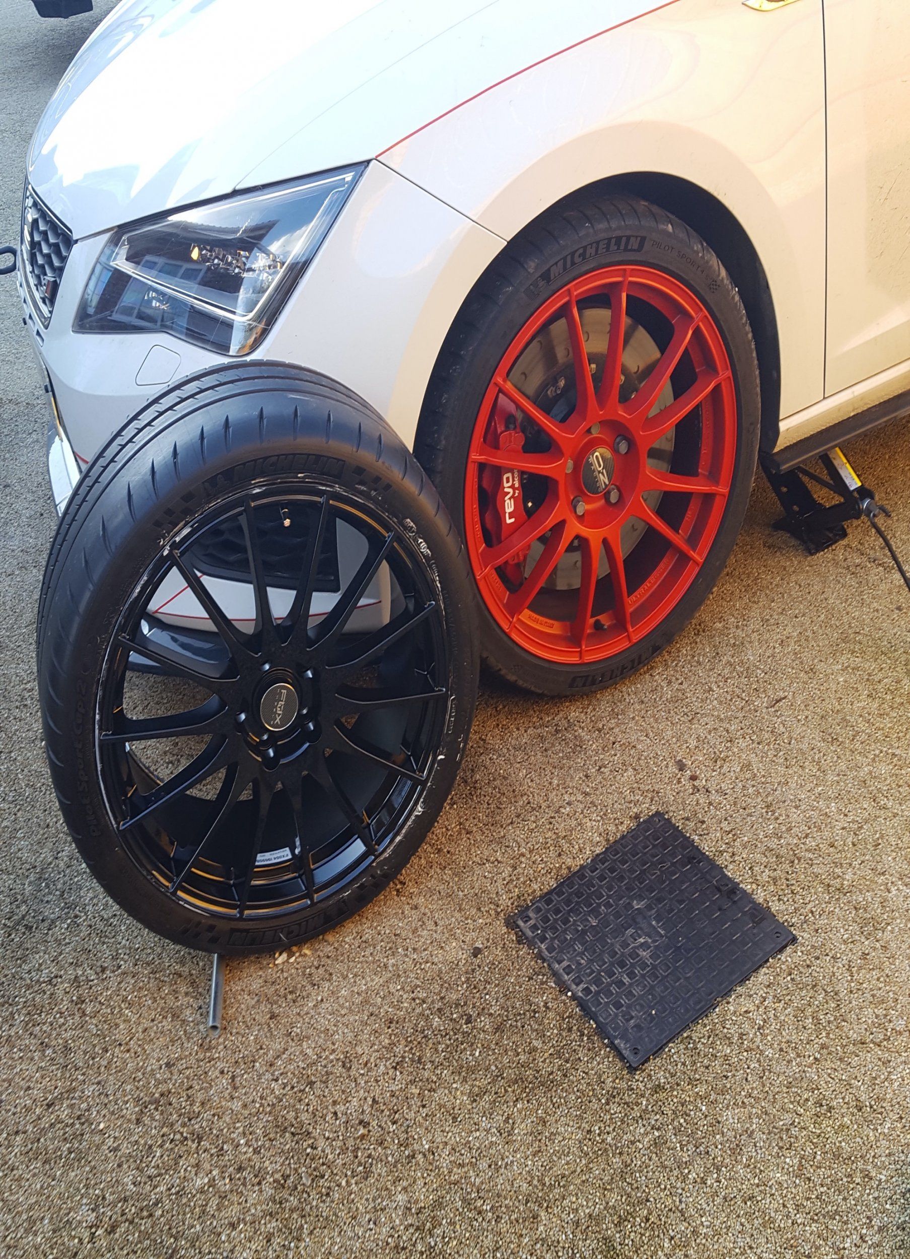

I have the OZ RACING ULTRALEGGERA HLT and been very happy with them, put up with a lot of bad roads and use on the track
I also have FOX FX004 I9690B and happy with those as well.
As for your original issue on Color I have replaced the Diamond cut ones with powdercoated grey and they looked good, The Fox wheels were originally black and that looked fine but had them powder coated fire engine red and personally I love it (but it is in your face)
