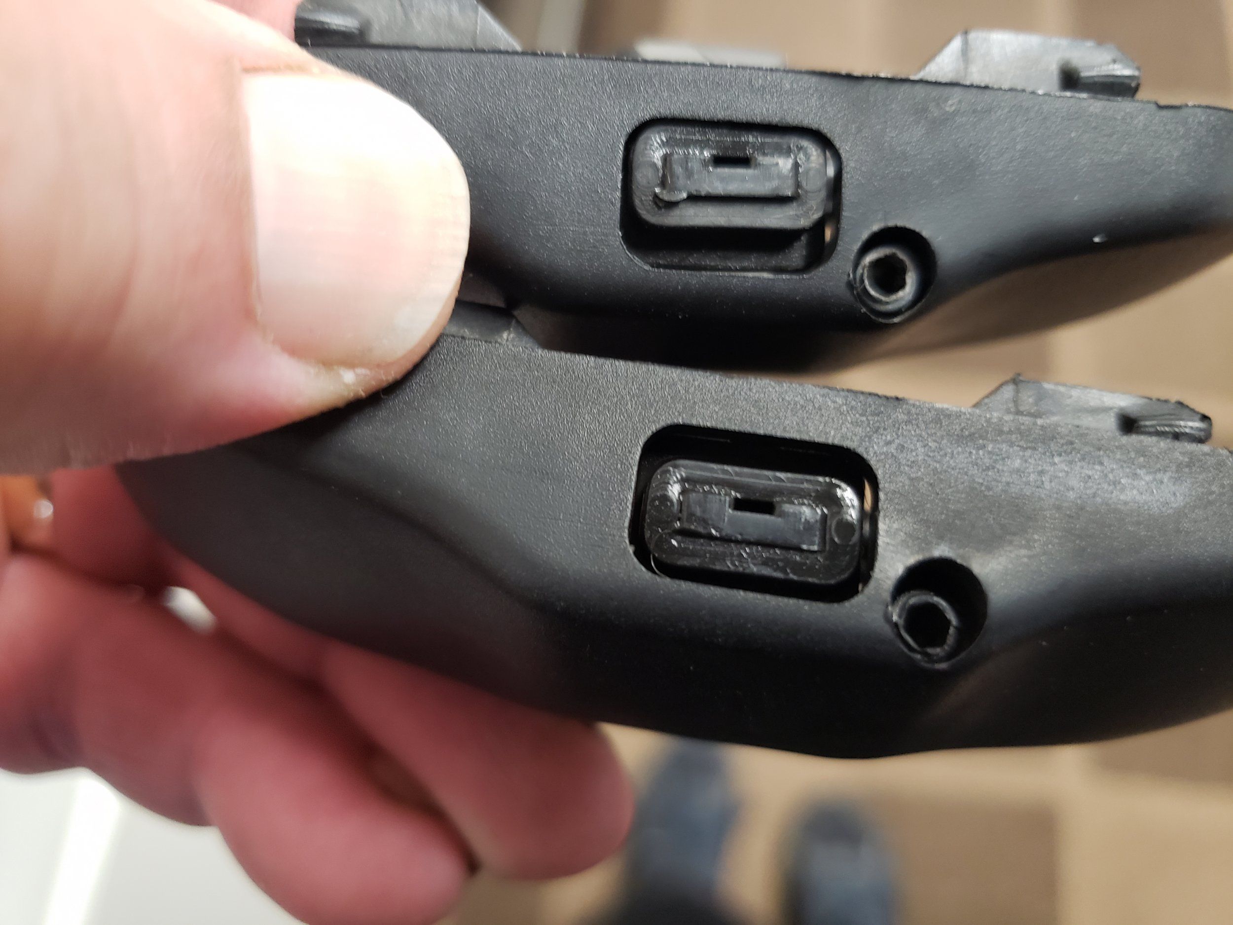

The ones I bought are the genuine VAG parts, 5M0 955 985C 9B9, certainly not cheap Chinese copies. They seem very weak on fluid delivery compared to the original 3 jet ones
Very unusual, I take it that they are adjusted fully up? Maybe you have a faulty pair, but unlikely :(

I bought VW fan washers on eBay and they were obviously fake. Didn't fit or work very well. So I'd be inclined not to buy these cheap eBay trick washers as there's a pretty good chance they're Chinese junk. The stock items might not be the best but they do work and are likely to continue working. All best are off with cheap eBay shite.

The ones I've got, and used on my previous car, were dealer bought, so definitely not Chinese Ebay crap
Yes, they were adjusted fully up. Never bothered putting them on the new Leon. Do you reckon the wiper arm nozzles as in my link in the first post will work?

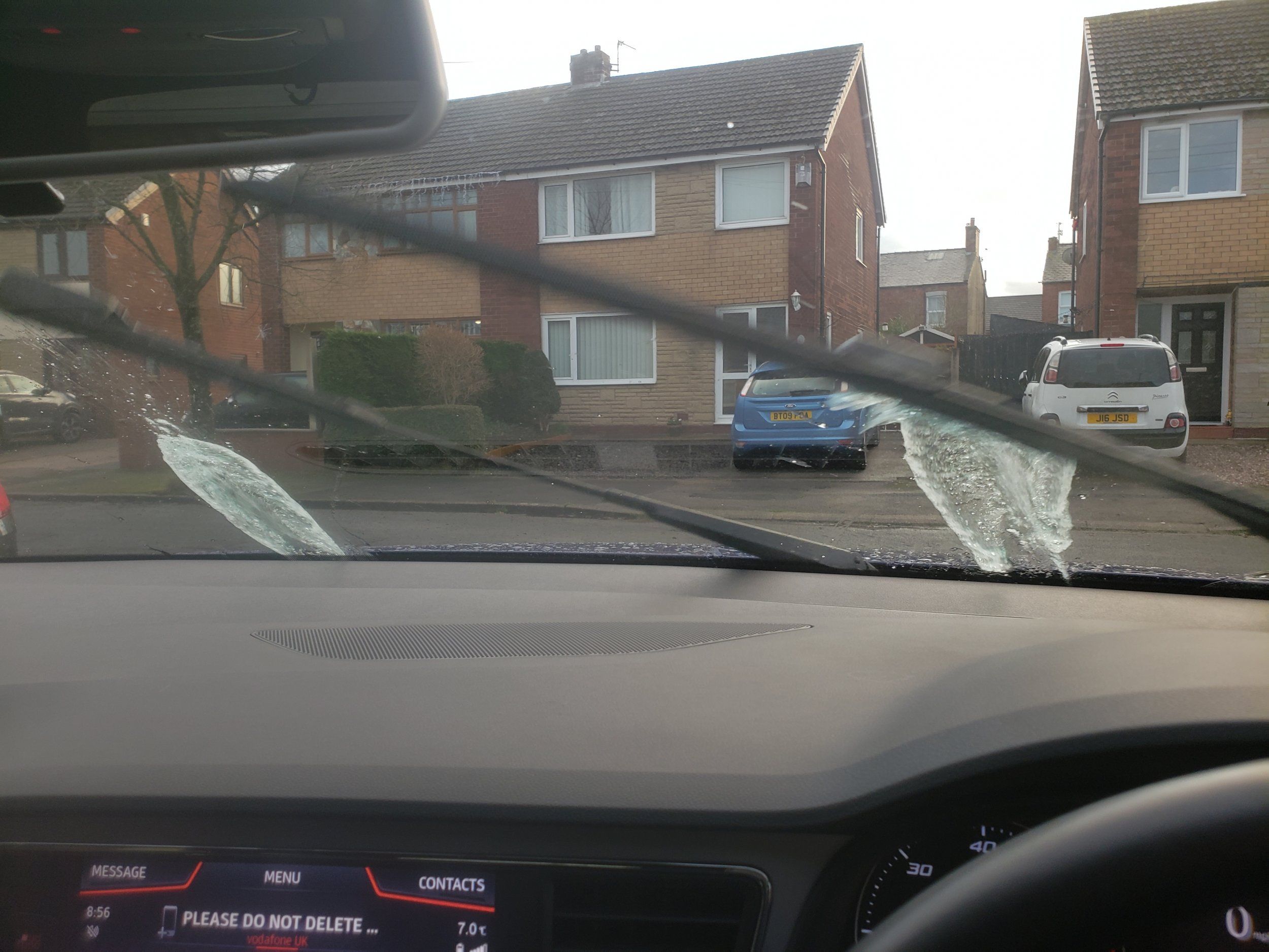

I've swapped the standard jets over to the Golf fan sprays that I took off the other car, and I'm beginning to think they aren't what they seem. Certainly not a fan spray from these! Now back on standard jets......May look at getting some replacements. For anyone having a laugh at what I call my phone, it's because of work - I'm sick of other drivers unpairing my phone from the bluetooth in the wagon :D

I'm fairly sure they look like the fan jets, I'm wondering if your washer pump is a bit weak, or maybe the actual washer fluid you are using is not suitable, I found out recently that VAG recommend special fluid for Fan Jets
